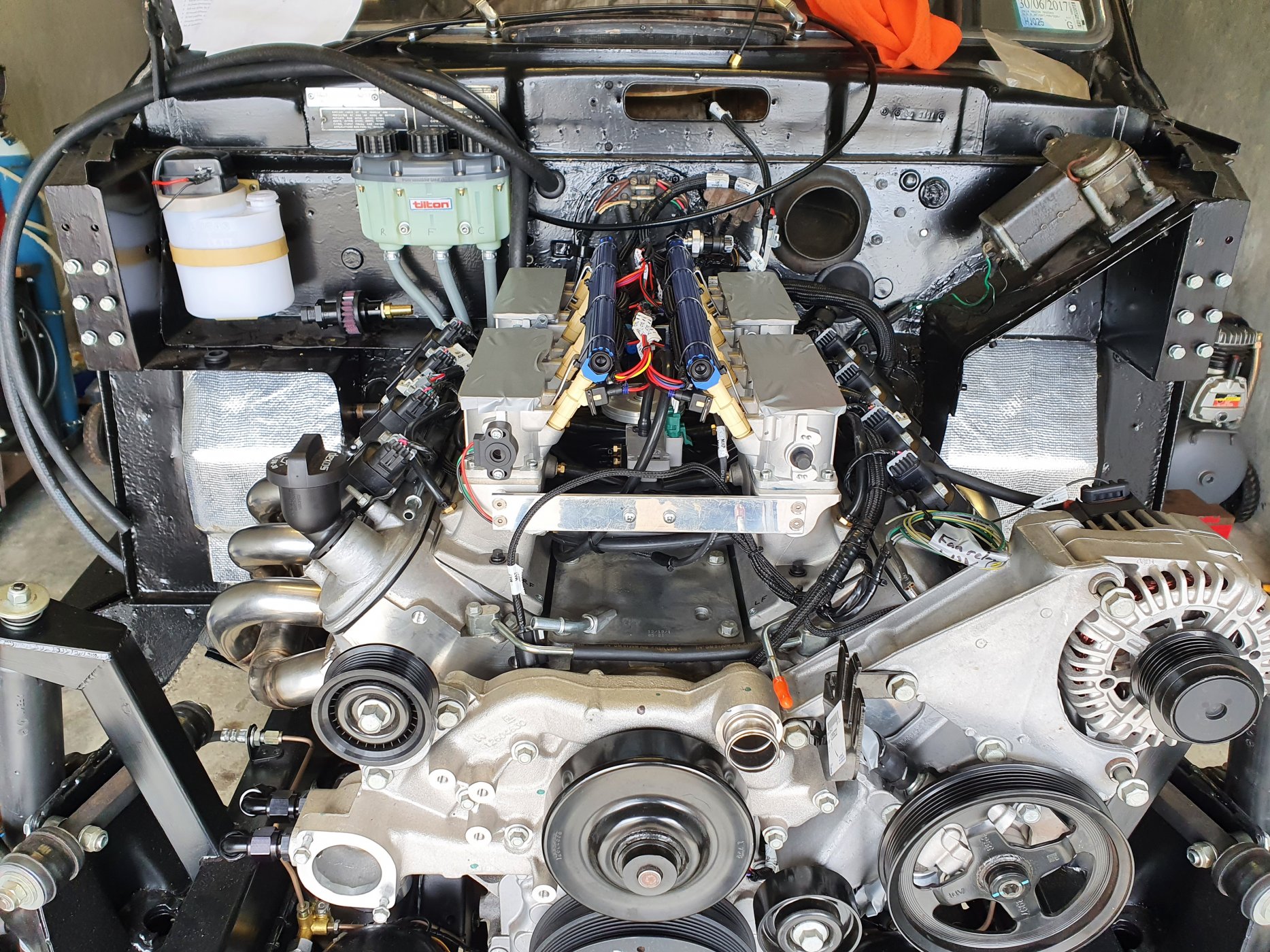

Hi Scott, I'm in the process of tuning my ITB set-up on an LS3. My system does not have a common plenum base, so I have two "collector" circuits for vacuum. 4mm taps on the outside of each runner which go to a common block in the valley and suck only the MAP sensor, and 6mm taps on the inside of each runner which go into a second block in the valley which then sucks on a moroso oil seperator that is connected to the PCV pipe with the fixed orifice in it that is on the front of valley cover. This second vacuum block also has an IAC valve attached to it to control idle. Works fine, but lots of plumbing.
My car uses Alpha-N fueling strategy (i.e. engine load = TPS position) and the tune is shaping up well. ITBs are hard to tune for the street using speed density. I am actually not using my MAP sensor signal for anything. Hope this helps.
