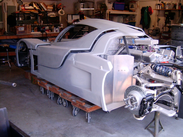

Get one of these: I have had a similar one that came from Harbor freight for years now and although it is heavy I can slide it under both the GT40 and my SLC without any other preliminary wood etc. I run my SLC at 3 1/2 " front and 4 " rear ride height. This is very low! and the jack still works! Great shop jack! I think I could run the car as low as 3 inches at the nose and it would still work

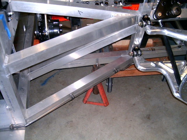

I also am always taking the car apart and doing stuff. I have found that maybe near 100% of the work I do is best done sitting on the tires, sitting on jack stands without tires at near ride height, or on my wooden roll arounds. They allow the car to be put on them with the tires on and still have enough clearance under the car to lay on my back and do the limited amount of things that need to be done under the car.
A long time ago I took a set of jack stands and permanently set their height by bolting the sliding tube to the outside tube with a through-hole and bolt. Much safer and usable. The third picture shows the car sitting on the bespoke jack stands and the roll arounds parked under the car. They are not supporting any weight.
So I have room for a lift but I just don't think I would use it except to drain fluids. I would however if I did, pick a lift system that allows you to remove the suspension parts, wheels, springs, brake rotors, pads, etc. by supporting the car by the chassis. A four-poster would be of no use for me other than a place to park another car.
