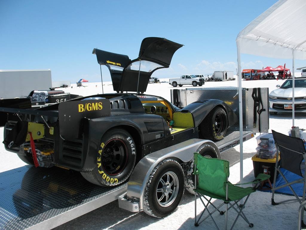

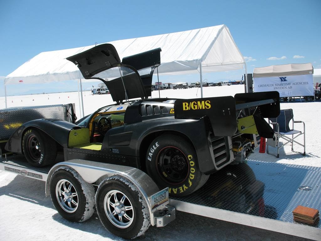

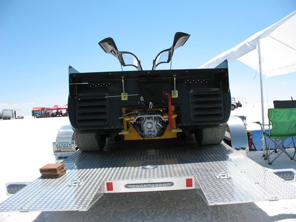

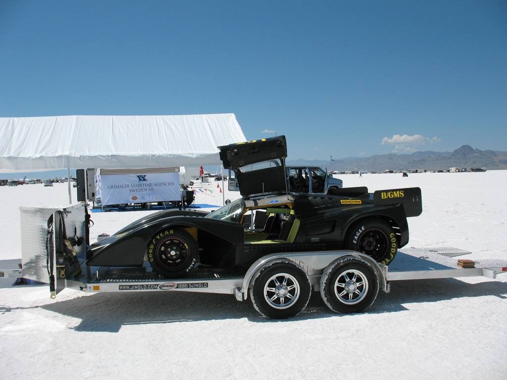

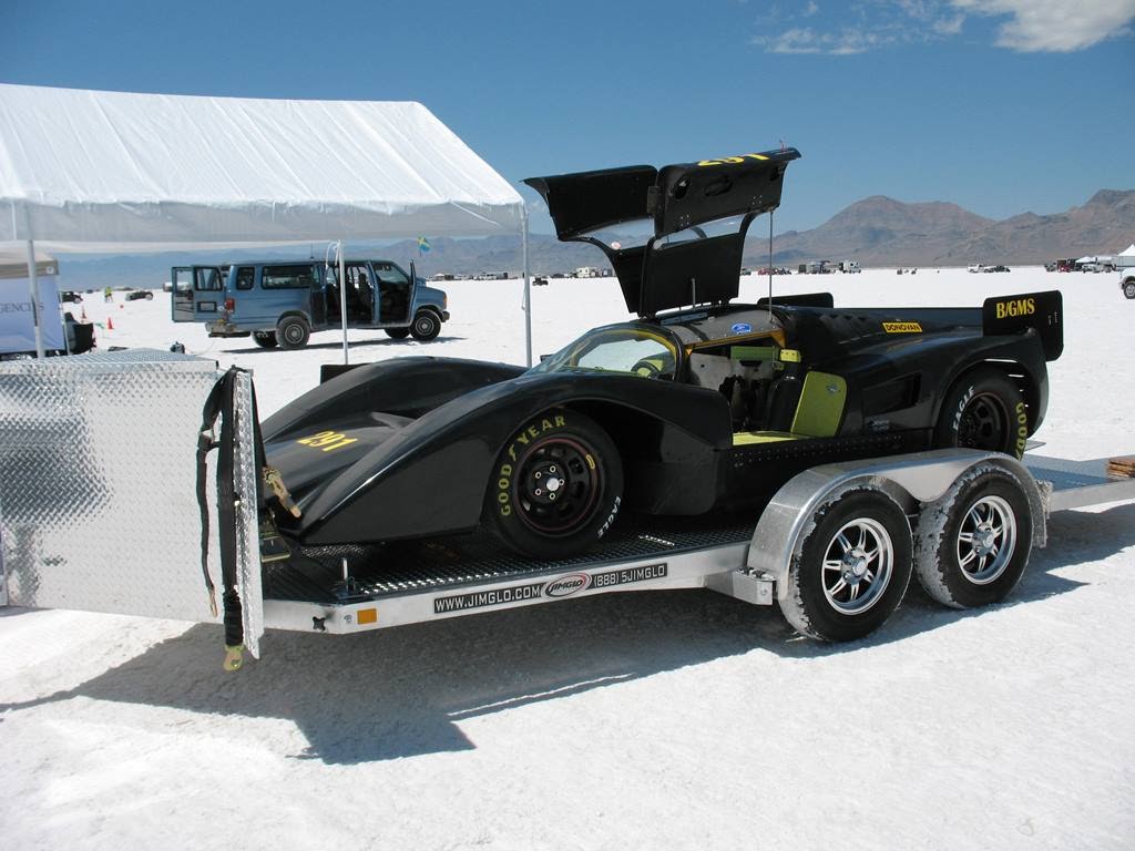

I have an 18 foot Jimglo tilt-bed aluminum trailer for my black Mirage. It tows easily and loads smoothly. I have the usual options- front box, built-in winch, electric brakes, etc. Since my car is low and has an unusually long nose overhang, I built two wood ramps to keep the nose from scraping on the trailer. A GT40 probably would not need anything like this. Its resale value is very high.

I have since changed the way I load my car on my trailer. I now load the car "backwards"; that is, rear end forward. This places the weight on the trailer forward, giving me more trailer tongue weight without having to roll the car so far forward as was necessary when the car's nose was forward on the trailer. Any mid-engine car should probably be loaded this way unless the trailer is very long.

Any mid-engine car should probably be loaded this way (rear end first) unless the trailer is very long.
[/QUOTE}
No question.
I towed my '81 DeLorean nose first ONE TIME...for about a mile on the freeway...didn't even get up to legal freeway speed before the tail started wagging the dog. 'Scared the stuffings out of me.
IMPO no mid-engine or rear-engine car should ever be towed nose first. 'Stern'-first only.
'Too easy to 'buy the farm' the other way.

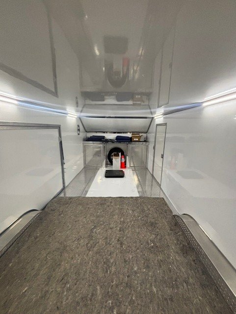

Mine is a slant nose so about three feet up in the front really doesn't accommodate the length of the car. However, I have a rollaway toolbox permanently secured to the floor and up on a stand so that the jack and jack stands can live under it on one side of the vee and a tire rack (four tires/full set) up on the wall of the other "V" with a large plywood box on the floor underneath it that holds all the tie down, tow straps, lawn chairs, etc. I mounted the wench to the floor between all that stuff so the front 3-4 feet of the trailer contains everything I need to take to the track with me. I should add that I also have another tire rack on the opposite wall from the one in the "V" up high alongside the car adjacent to the door of the car so that the car rolls in underneath it. So, I take two sets of spare tires with me to the track. One set of slicks and another set of street/rain tires.
I had the trailer built 6 inches shorter than a standard-height trailer so that its 6'6" onside instead of 7'. I'm sure that helps with drag and gas millage.
So I guess I am really using about 16 feet of the floor space to park the car in the trailer. When it's all loaded up I have about 3 feet of floor space behind the rear tires. Remembering I have a big wing hanging out of the back of the car. All in all, there is plenty of room in front of the nose and behind the rear of the car in the trailer to crawl around if I need to.
Gas cans (6) ride in the back of the truck.
Even with all that shit I got 13-14 MPG on the tow to and from Willowsprings California/ San Antonio Tx a few years ago. Not terrible considering I had to averaged 65-70mph most of the way.
So a 22-foot slant nose trailer is just right for me. looks like this picture (not mine)
Consider what you want to put into the trailer, measure it all, and then check the ACTUAL floor space footprint you are considering. Then buy accordingly.
