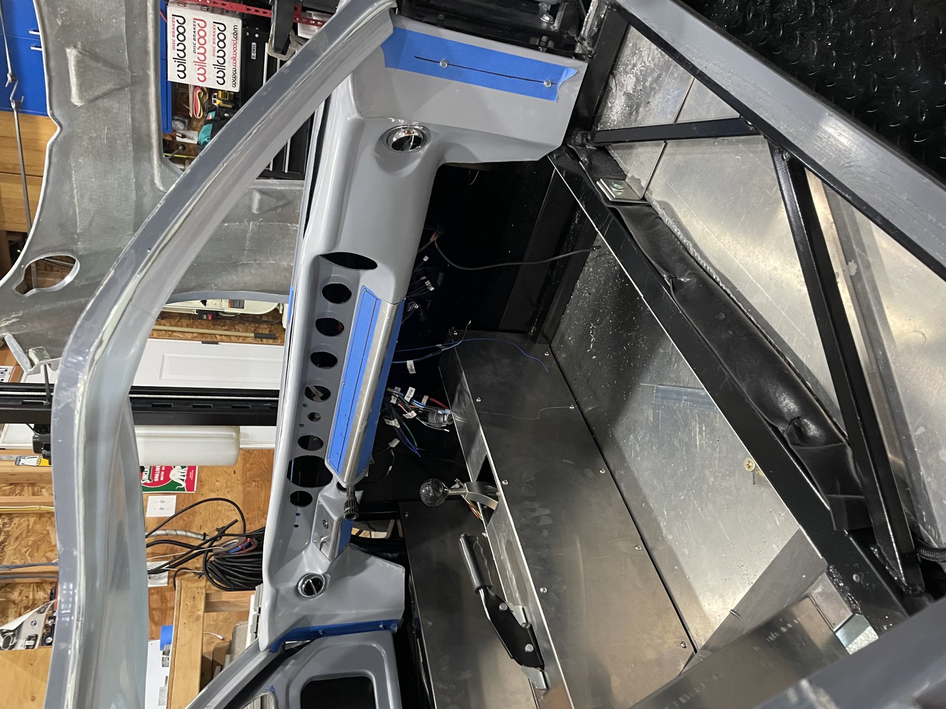

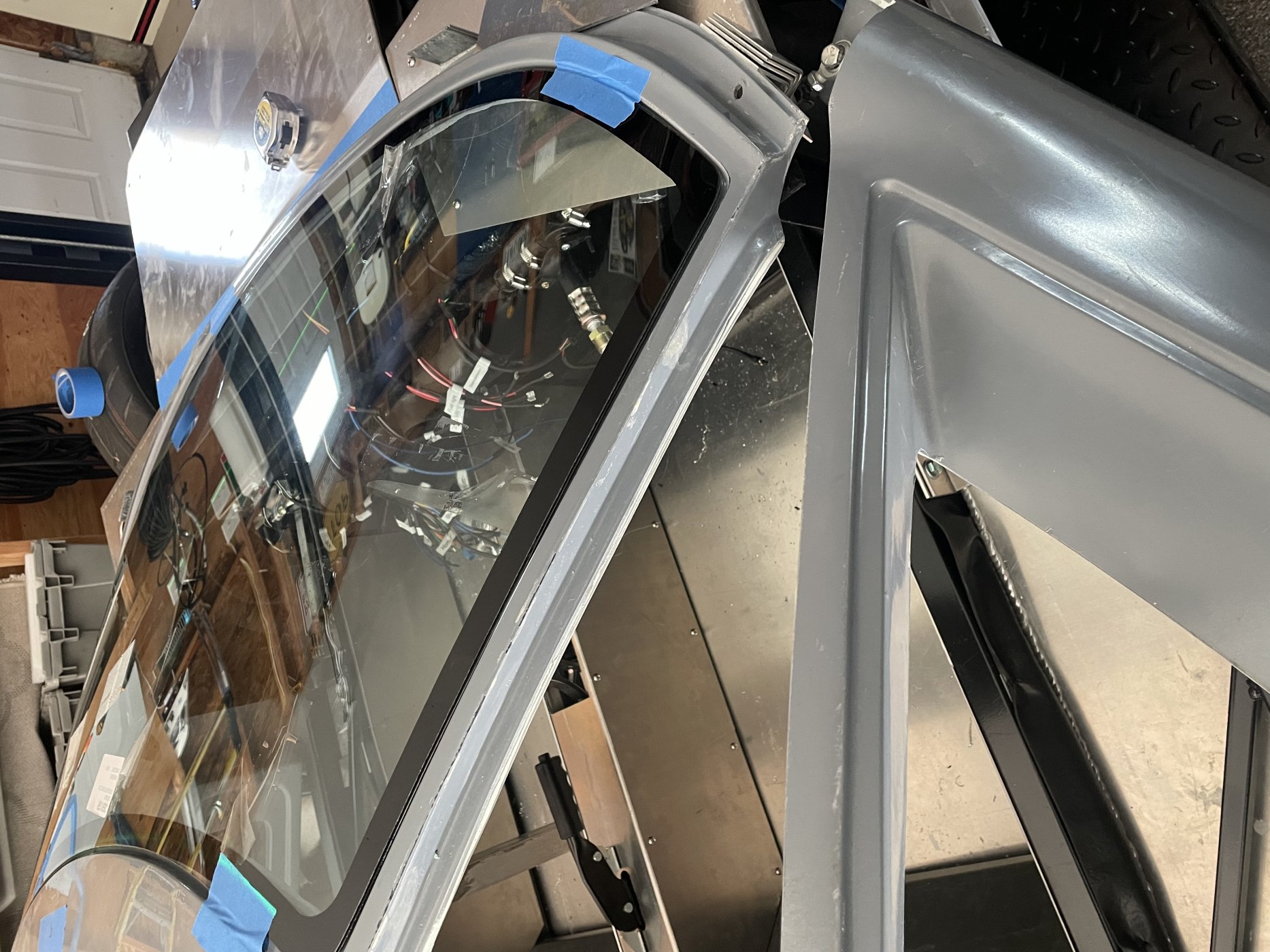

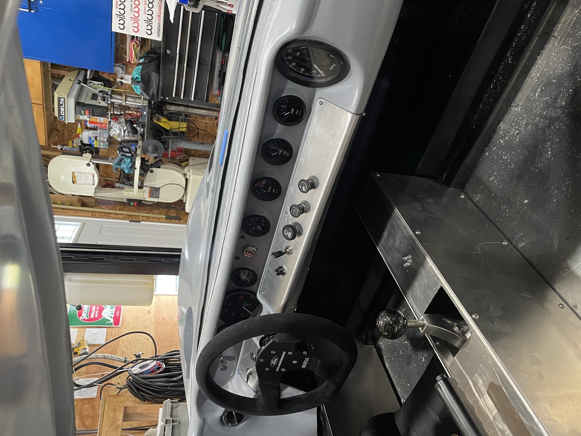

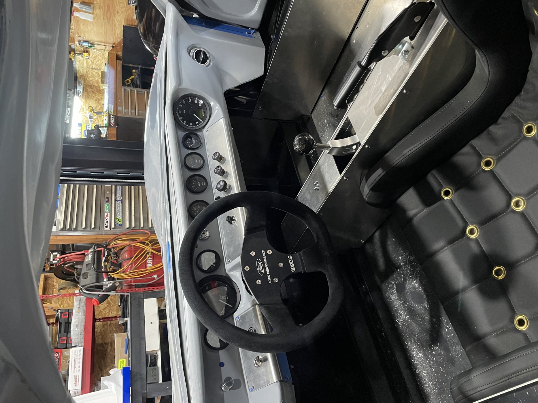

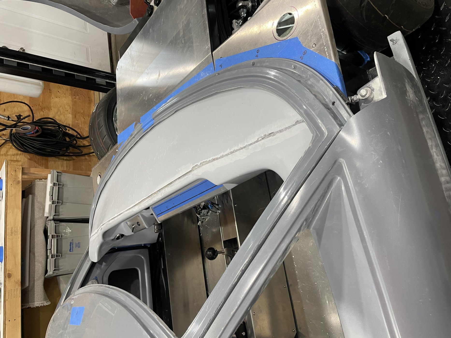

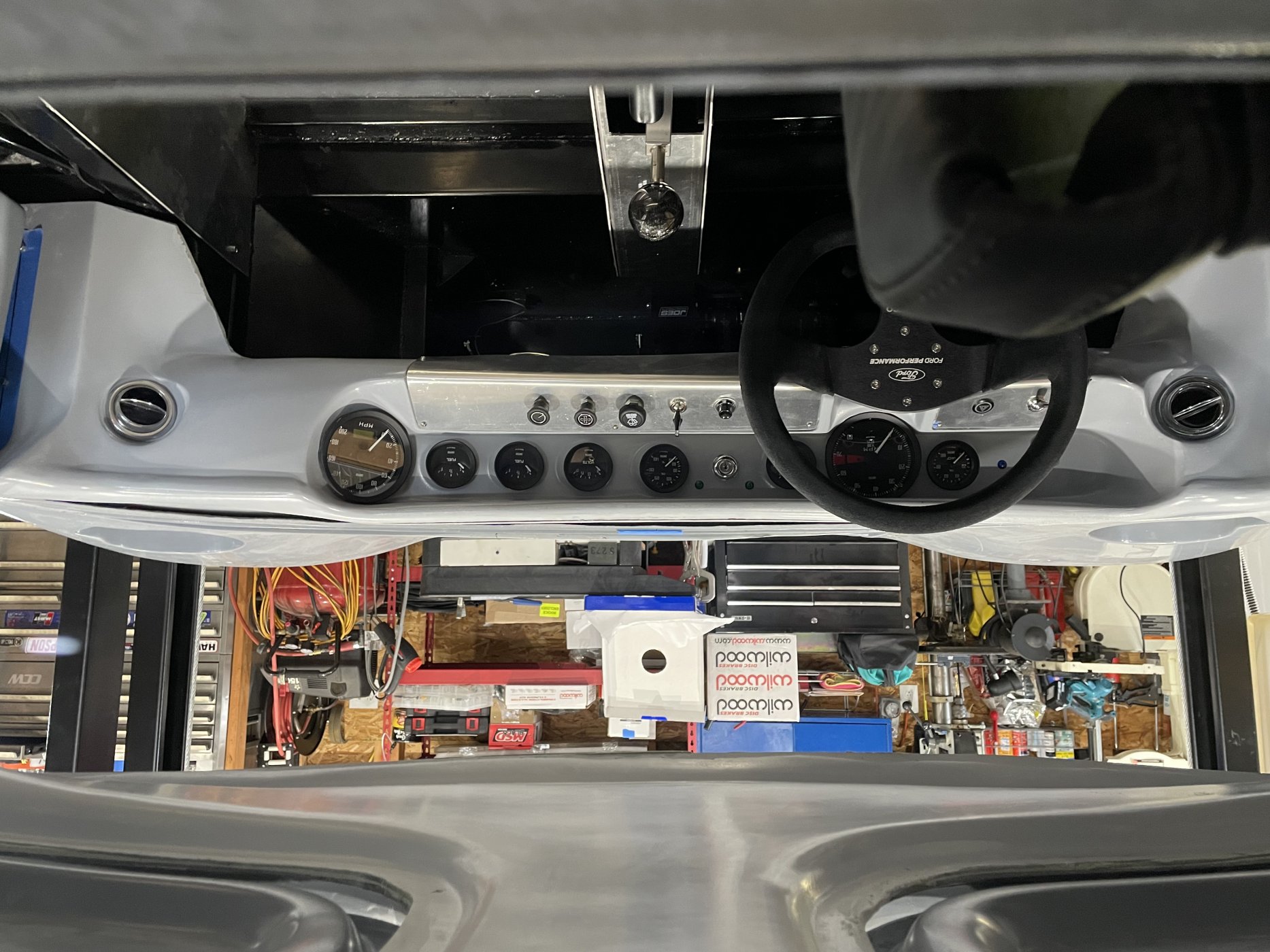

I spend 2-3 hours every night on it, helps me unwind from work lol.IMO i think body fitment is a great start from others I've noticed.Your speed is impressive! How do you think the body/gaps look so far?
I haven't messed with mine too much yet, but my panel gaps seem to be off. Did you have to do much moving around after it came off the trailer?I spend 2-3 hours every night on it, helps me unwind from work lol.IMO i think body fitment is a great start from others I've noticed.

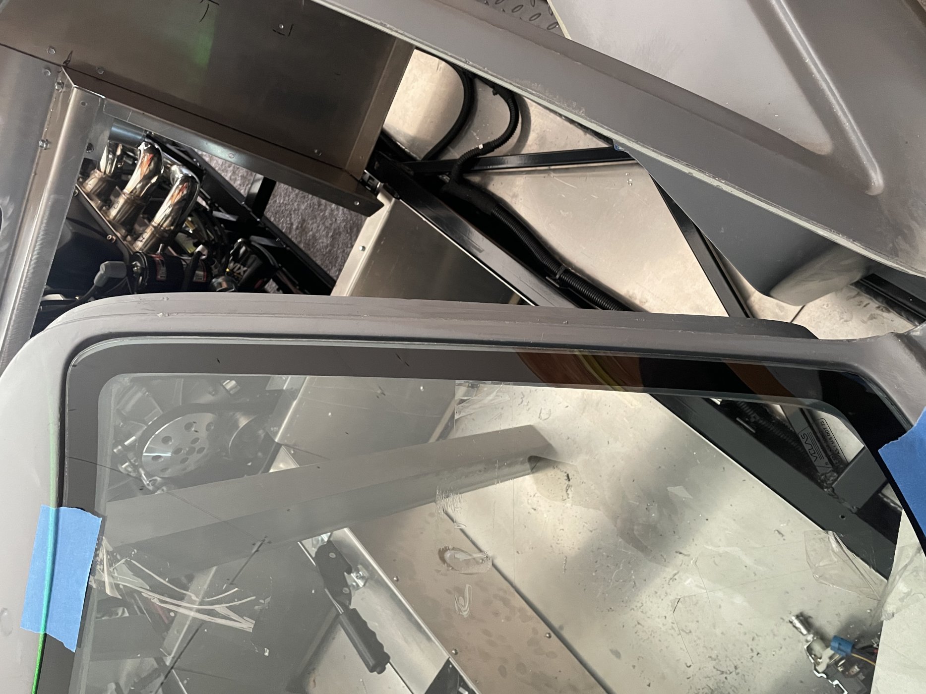

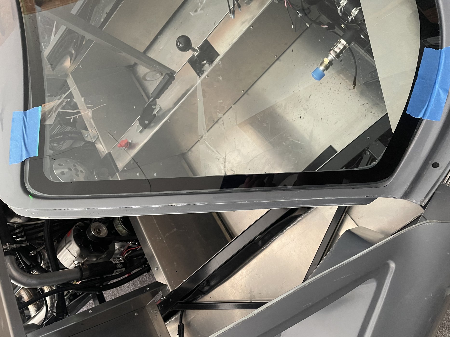

Not at all BUT now that I set spider for windshield I have to move everything. I noticed in pics of your car you are going to have same issue as me being for some reason the left side of body has to be raised roughly 1/2 to be even.I haven't messed with mine too much yet, but my panel gaps seem to be off. Did you have to do much moving around after it came off the trailer?

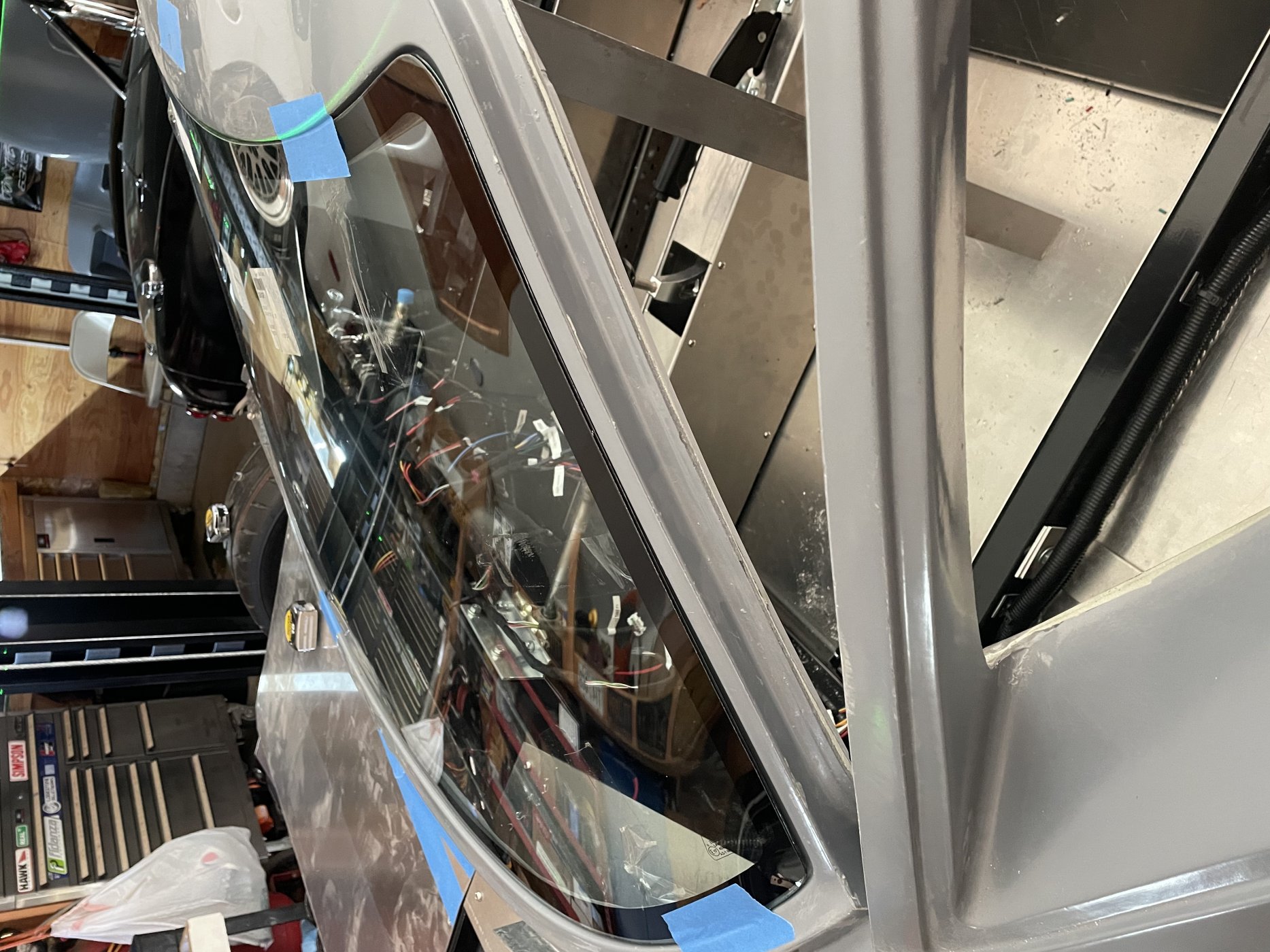

Im put heat on it today for a bit, I’m going to do little each day and see if I can get it to stay without prop. idk we’ll see lolMuch better Joe,
Did you heat and bend the fiberglass, or have you just shimmed it all into place?

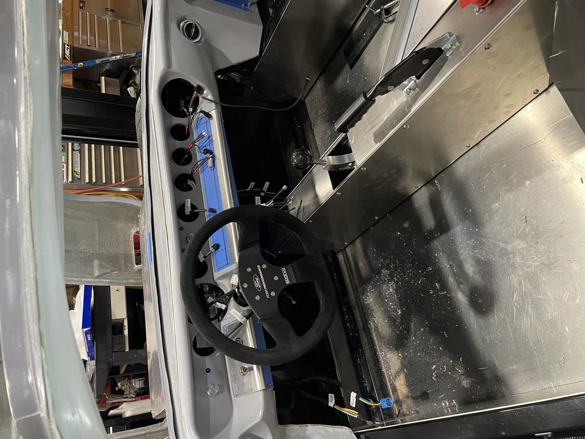

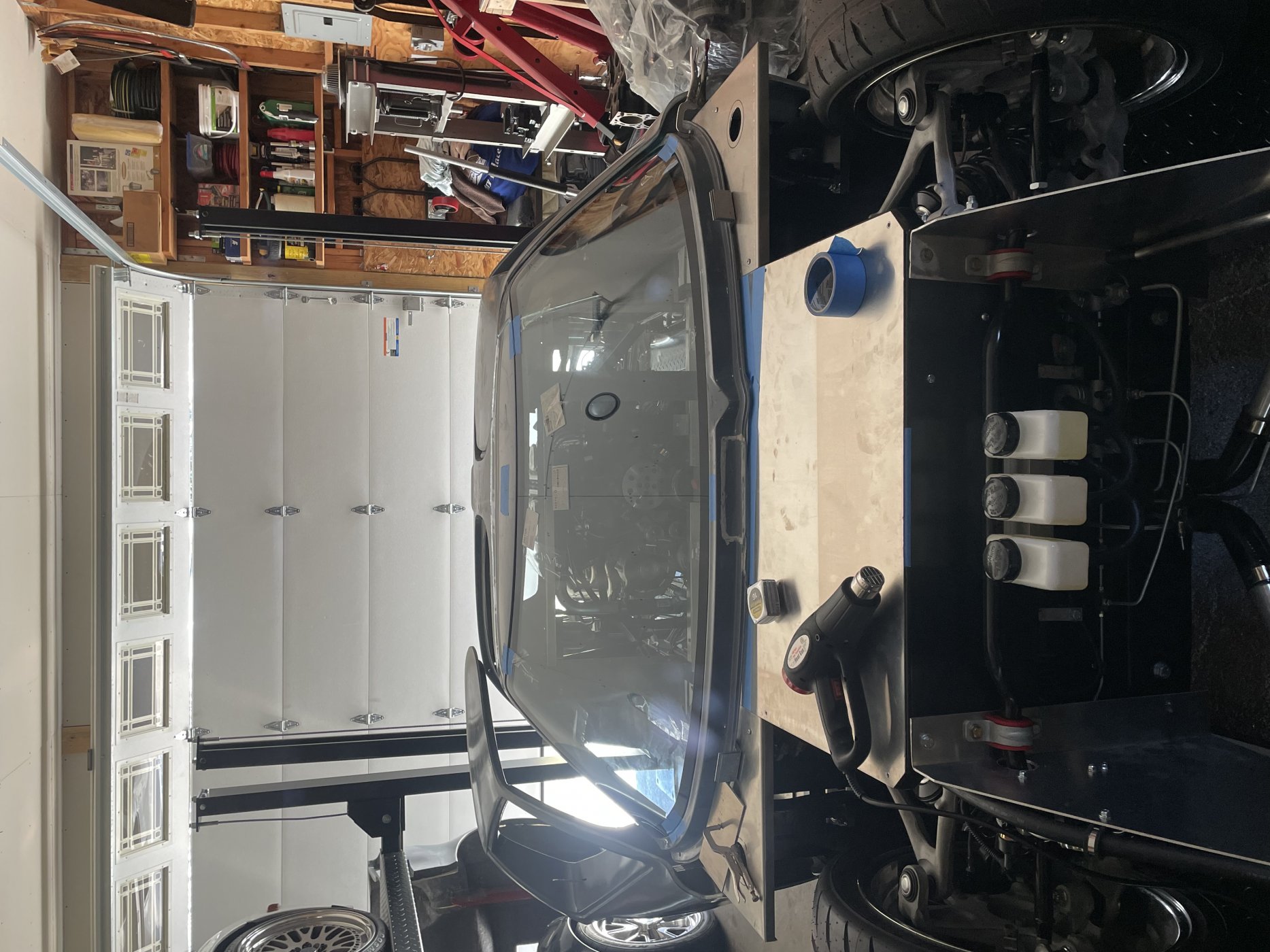

on the floor I put 1 row down center underneath 4” on center.I drilled a tapped everything in tunnel before running coolant tubes. All bolts are 8mm long so tunnel is clear of them all. I used SS button head Allen bolts on everything rather than rivets so it’s all removable. No bolts touch the tubesSomething I noticed today. I have my bottom pan screwed in temp with 3 screws in the tunnel. Not a good idea. I was planning 2 rows of rivits, but it needs to be 1 row in the middle or very close to the edge so the protrusions are not rubbing on the bottom of the coolant tubes. You're row of screws in the tunnel reminded me.
Thanks. Your tunnel is much taller than mine so you have room for rivnuts being they protrude the backside. I dont mine is very tight, so i tapped and used fine thread bolts to get as much thread possible. The fine thread really grab, i have yet to spin one out.I usually like rivnuts on anything lighter than 3/16" with anything bigger than #8 screws.
I'm wanting to pack coolant, heater, AC brake and clutch in there, so every bit is precious.
Looking great.
My tunnel is 2x4 od, just enough for the coolant tubes to fit. WP should not be a problemDo you have smaller than a 4x3 tube in the center?
I've been trying to pinpoint what's different in our chassis. Mine omitted the lower A arm clearance pocket, but I've added one.
I'm dropping down to 1.25" coolant tubes. I'll bell back up to 1.5 but for the straight run in metal and using the truck water pump, I think I can get away with it. If not, I can add a booster pump in the front later.
