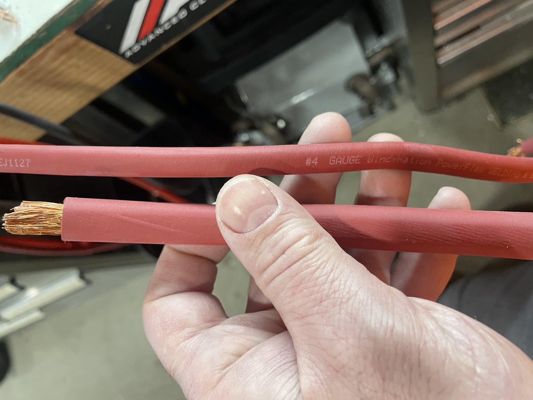

Yes I have battery kill switch.no remote starter solenoid I’m directly to starter solenoid. New cables came today I’m just waiting for terminal ends,still out for delivery smh. As you can see in pic it’s a big diff in size,hopefully solves problem.

I think I see the problem..your hands are too clean you need to get some grease under those nails. Car looks great! Once you get that engine fired up you will forget all about the starter issue. Waiting patiently for the first start video.
