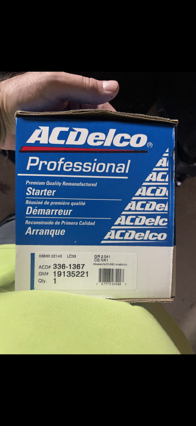

First startup attempt failed. Starter is not strong enough to spin my motor its struggling. I should of known when i first saw it but figured if they supply it,should work.Company is closed till mon for me to ask what there supplied starter is for smh. Any chance does anyone know how to cross reference a starter? Pic is what they supplied I need to cross reference that to a high torque starter so i can order one today.

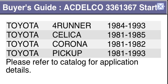

Hi Joe. I had the same problem with the starter Kennedy (KEP) supplied. It wont turn my engine. I talked to Brett from KEP about this. The starter they use at least for my combo ( BBC to 997.1) was from a Toyota Hilux with 22R engine. KEP was not able to provide me a much stronger starter. I looked and I found a starter made by Mean Green. Its for a 1984-1993 4 runner 2.5 KW gear reduction starter. A perfect fit for mine. It started my engine with no problem. Hope this helps. Good luck.

That Delco reman is just 1 KW motor. If you can find one for a diesel with the same flange you're in business.
Believe it or not, I've had a $50 ebay chinese gear reduction starter on my 427 in the cobra for 12 years and it spins that thing 300 RPM. I think all of those chinese starters use the same motor and gear train but just a different snout and maybe pinion. If they make one for the toyota that looks the same it may be worth throwing $50 at it.
Any reman is going to be the same pissy little 1KW motor, but a new aftermarket will more likely have the same generic 2.5KW motor.
I also have the same cheap ass ebay starter on the 383 in my old vette, and it beats the hell out of the 500 lb lug that Chevy provided in 1971.
Brian
Looks like the same flange but with a 1.4KW motor. So far I've seen 3 different toyota starter flanges. Seems odd Toyota would use a AC Delco starter.
