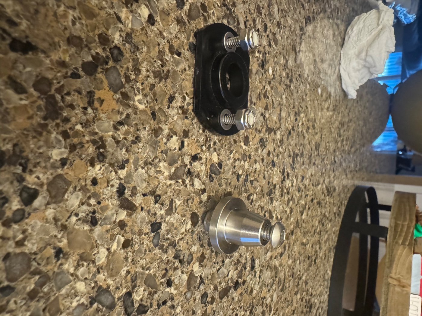

If you are talking clip locators, contact Flatchat (Chris Hatfield) on here. Top quality parts and quick service was my experience with him. He is currently building me a transaxle adapter to go from a BBC, to a Ford Ricardo. I expect that to be a quality part as well.

I reached out to him and he responded back. He sent me info, looks very nice quality. Thank you

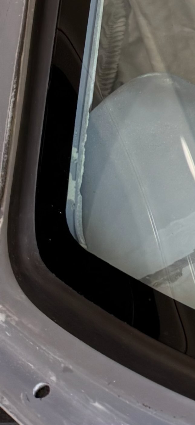

What kind of spacing did you end up with around your windshield? Mine seems a little tight, as in less than 1/16” in some spots, more in others. I’m not done fitting it yet though.

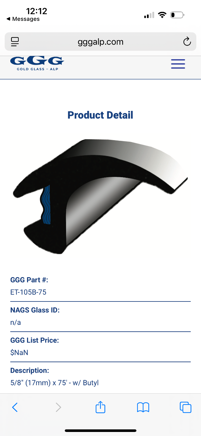

I had same issue. I ended up sanding do i had an even 1/8 space all around. I was not crazy about the idea of not having the edge of the windshield protected so I ended up fitting mine to accommodate a rubber trim which in my opinion looks so much better than the raw edge of the windshield.

I’ve done a fare amount of research on grinding the edge of the windshield as well. Doesn’t seem like it is as complicated as most make it. Most glass guys just take a 40 grit grinder to it!

Yes, I know someone who sanded their windshield. I was not too crazy about that. I figured the fiberglass was easier than it was thick in that area.Feels good to finally be back working on it.took time off to build my wife a weekend car she wanted and then from there my father-in-law got sick so I had to help my in-laws and now that that’s all better. I have my time back.
