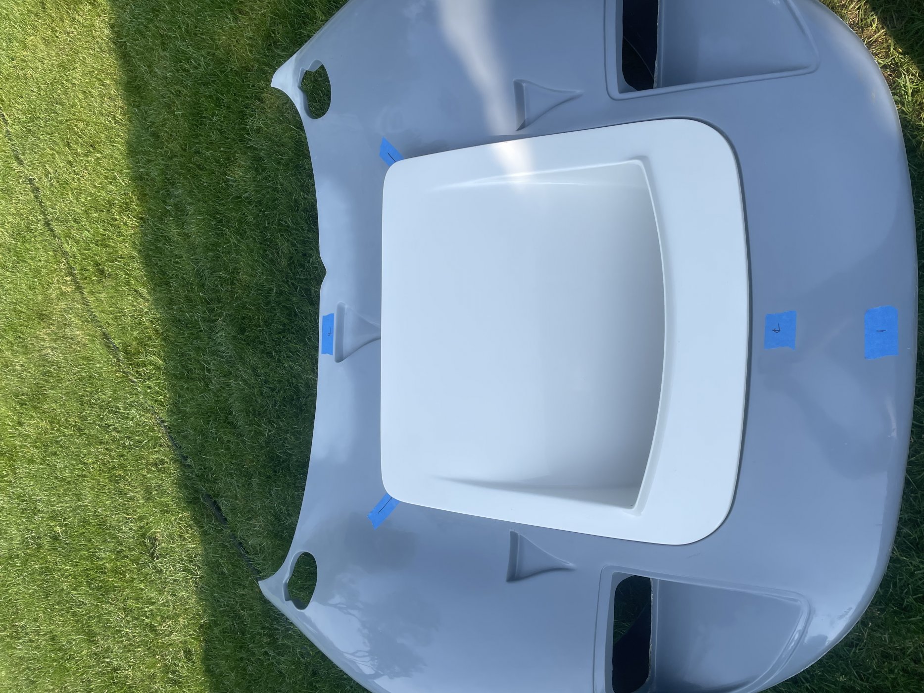

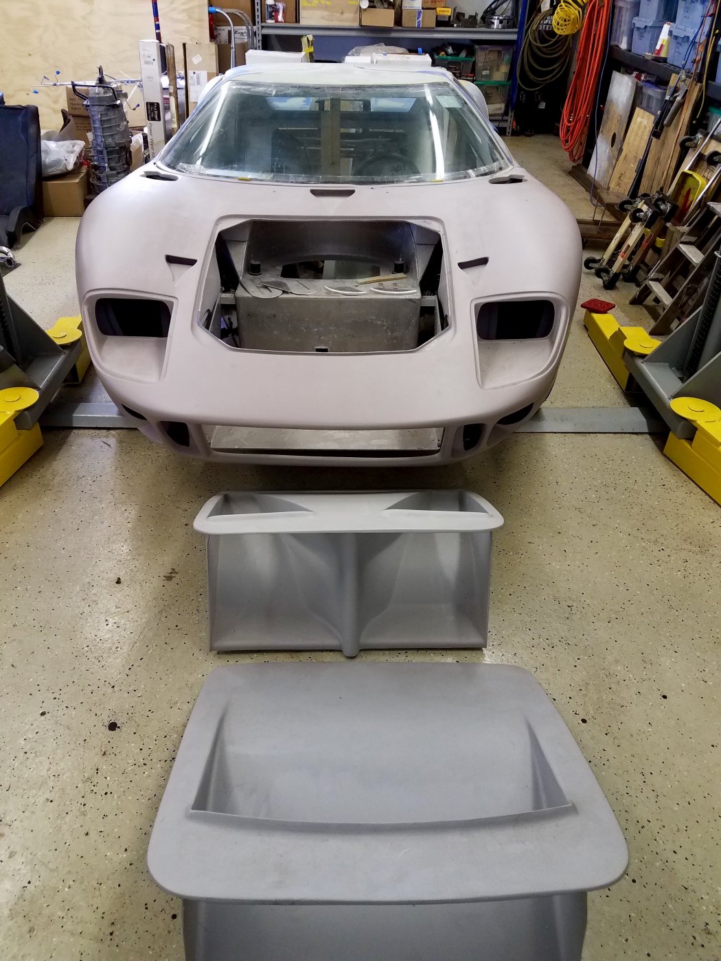

What fasteners did you use for your hood?
My little dual snorkel hood doesn't fit so well either. I know it's not correct, but I don't see a need for it to be removable, and think I may glass it in and make it a permanent part of the front clam.
I think mine is actually bowed up in the middle, which effectively makes it narrower. that is why it won't fit over the lip on each side without some convincing. Front to back shape needs to flattened out a little too.

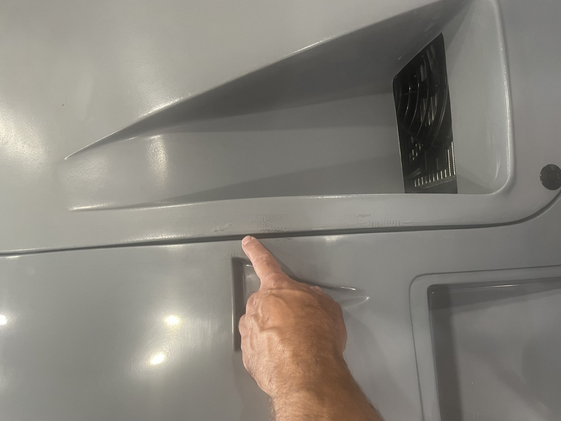

I guess i got pretty lucky then. I only needed to samd inner lip alil bit for it to drop in. Where my finger is in pic. I att link of fasteners i used.

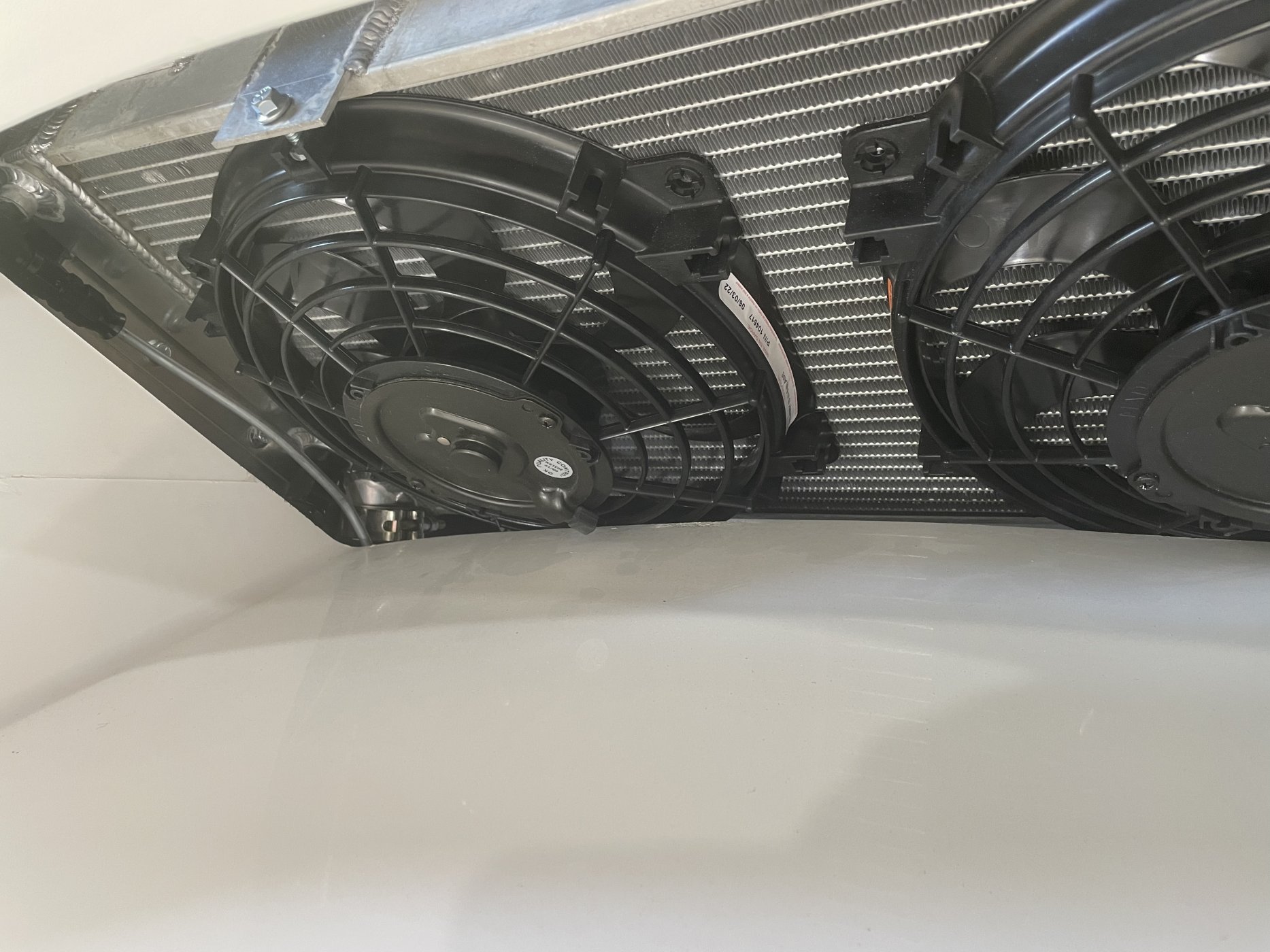

It looks like you have half depth nostrills. Worth either cutting them out and replacing with deep ones or getting a deep nostril panel..
That way the hot air all exits up and does not cook the foot well Area of the car.
Or
form an aluminium kick up piece to meet up with the nostril panel to direct all the lot air out.

I need to cut the top out still,I only took out what I needed to clear fans for fitment. as you mentioned,I will be making an aluminum duct.

Ah yes, i see what your talking about now that i went and looked at car. The bottom of scoop does not go all the way down so i need to get that air to flow out. Great call, thank you.
