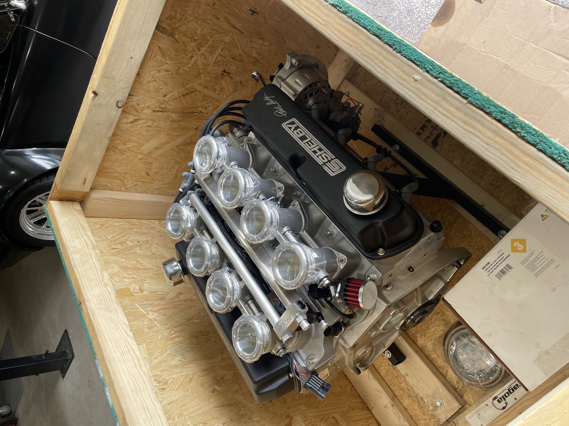

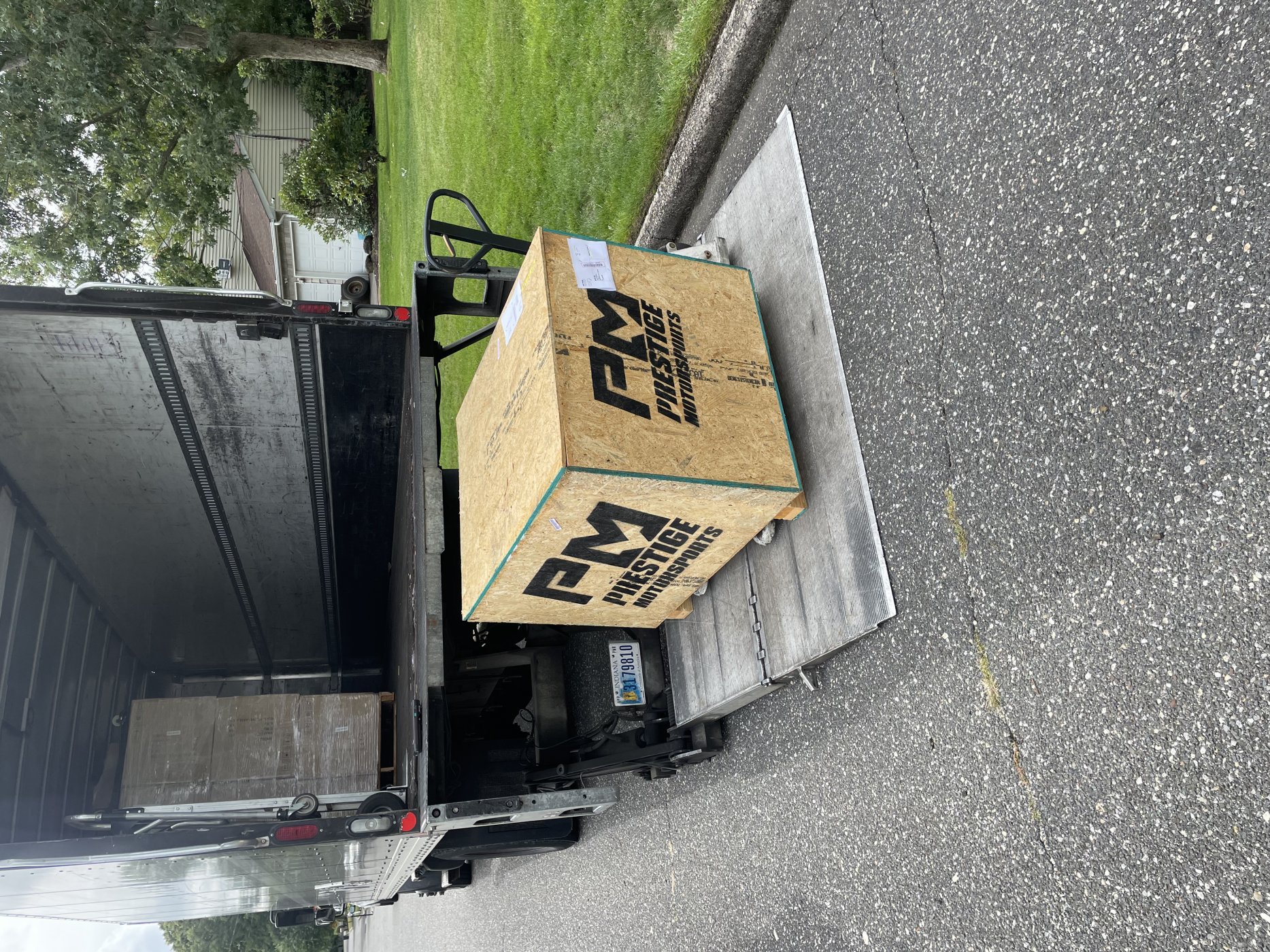

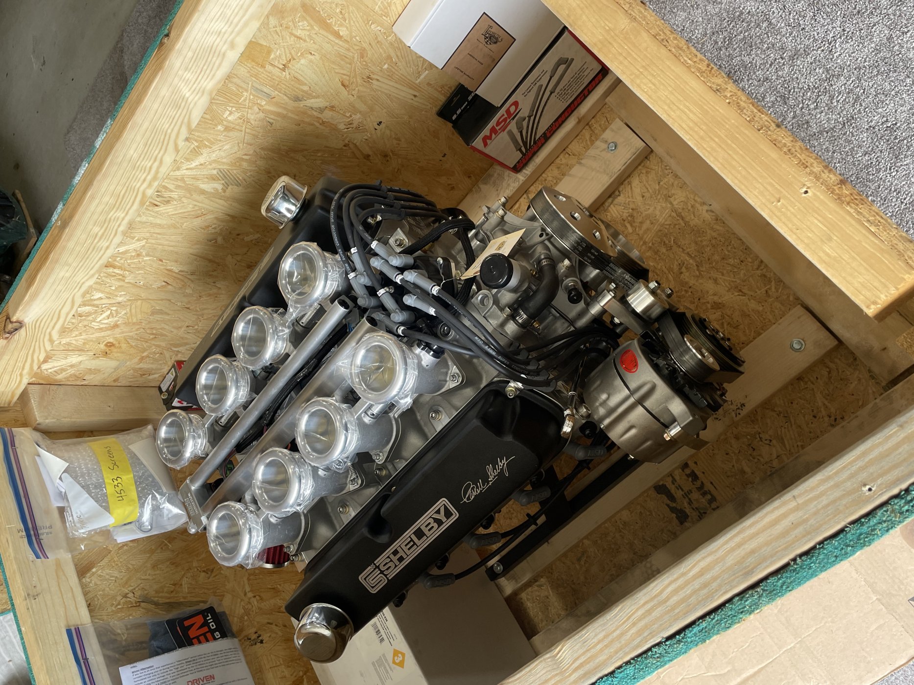

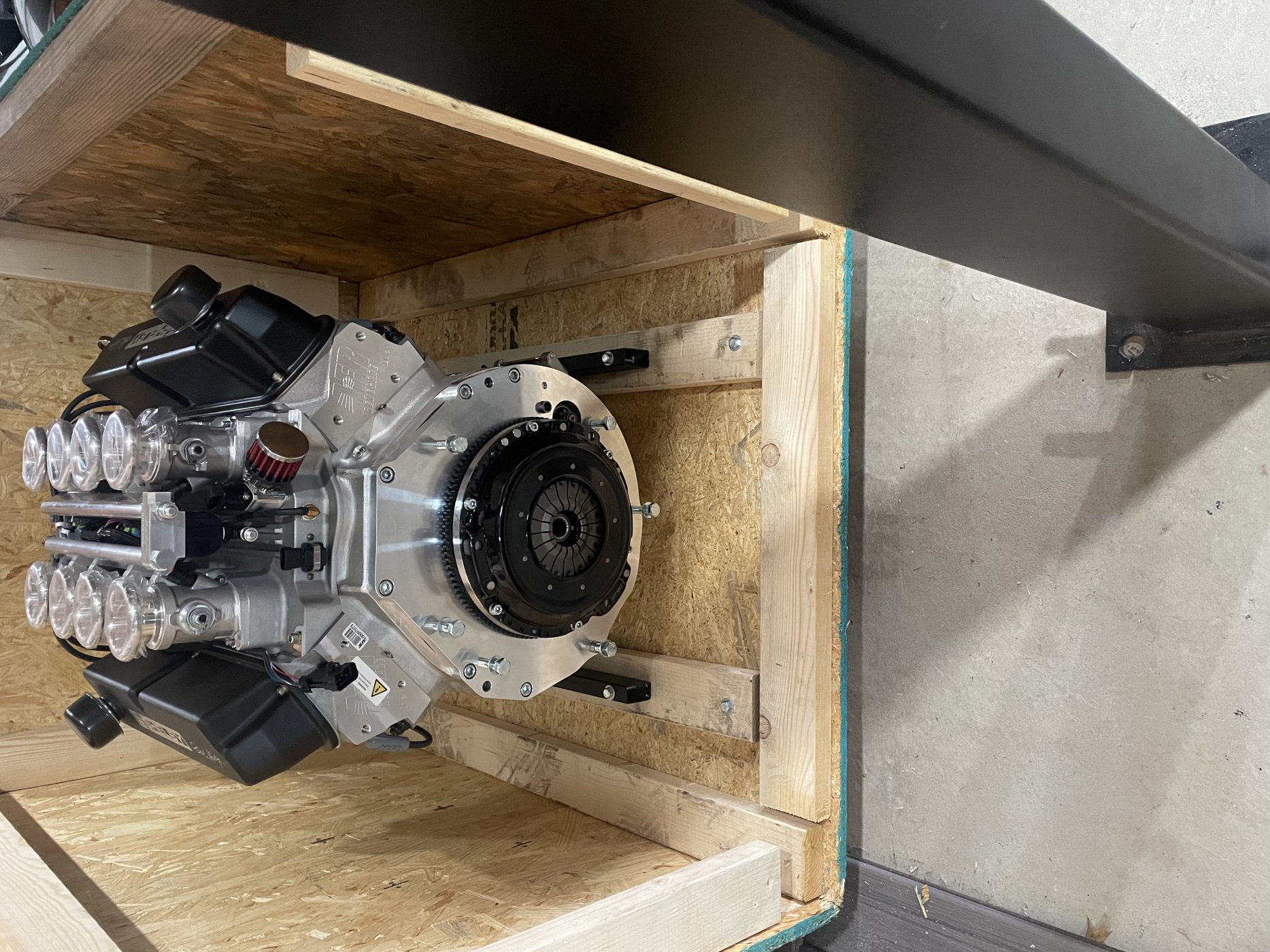

Motor is finally home

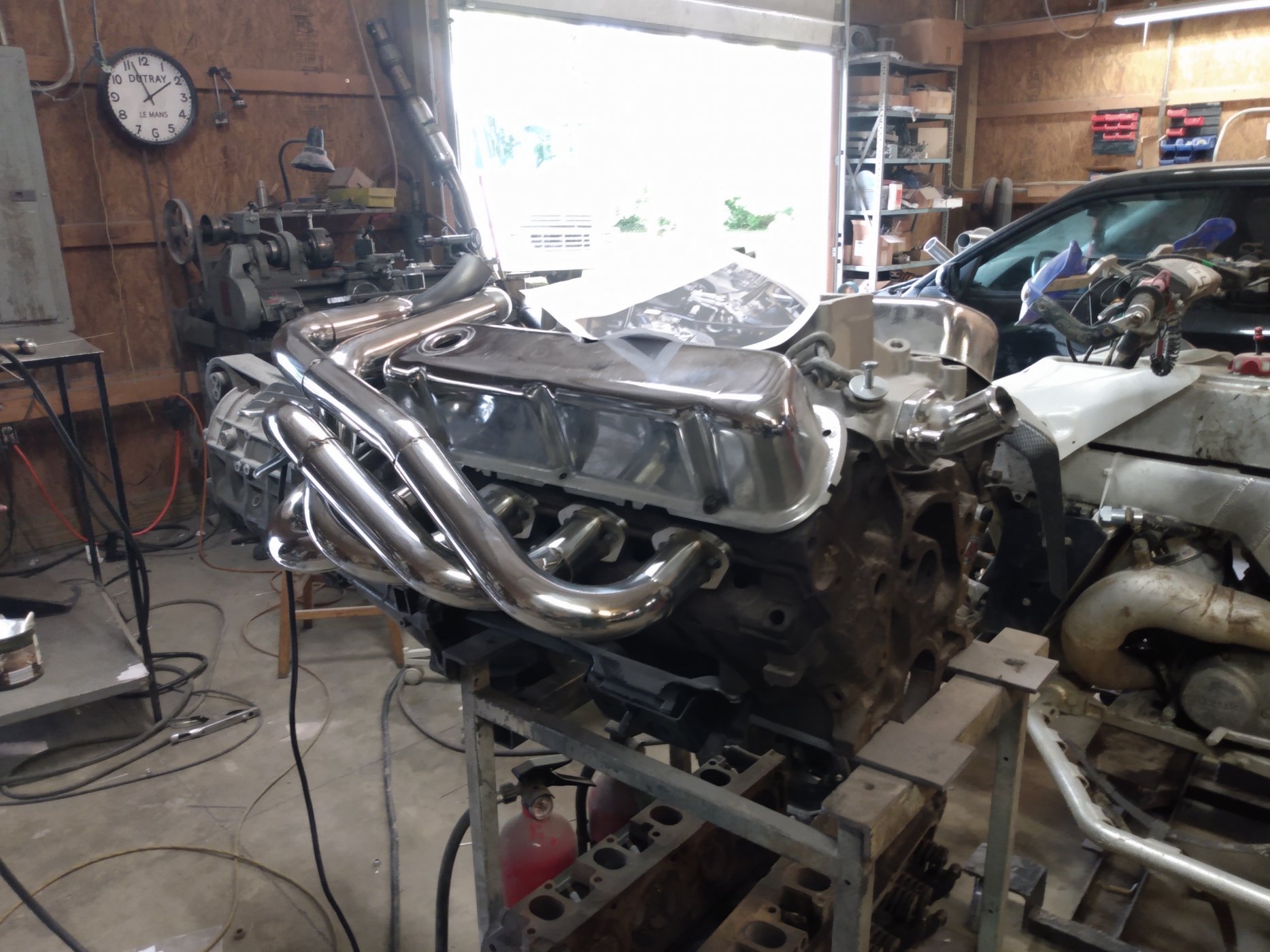

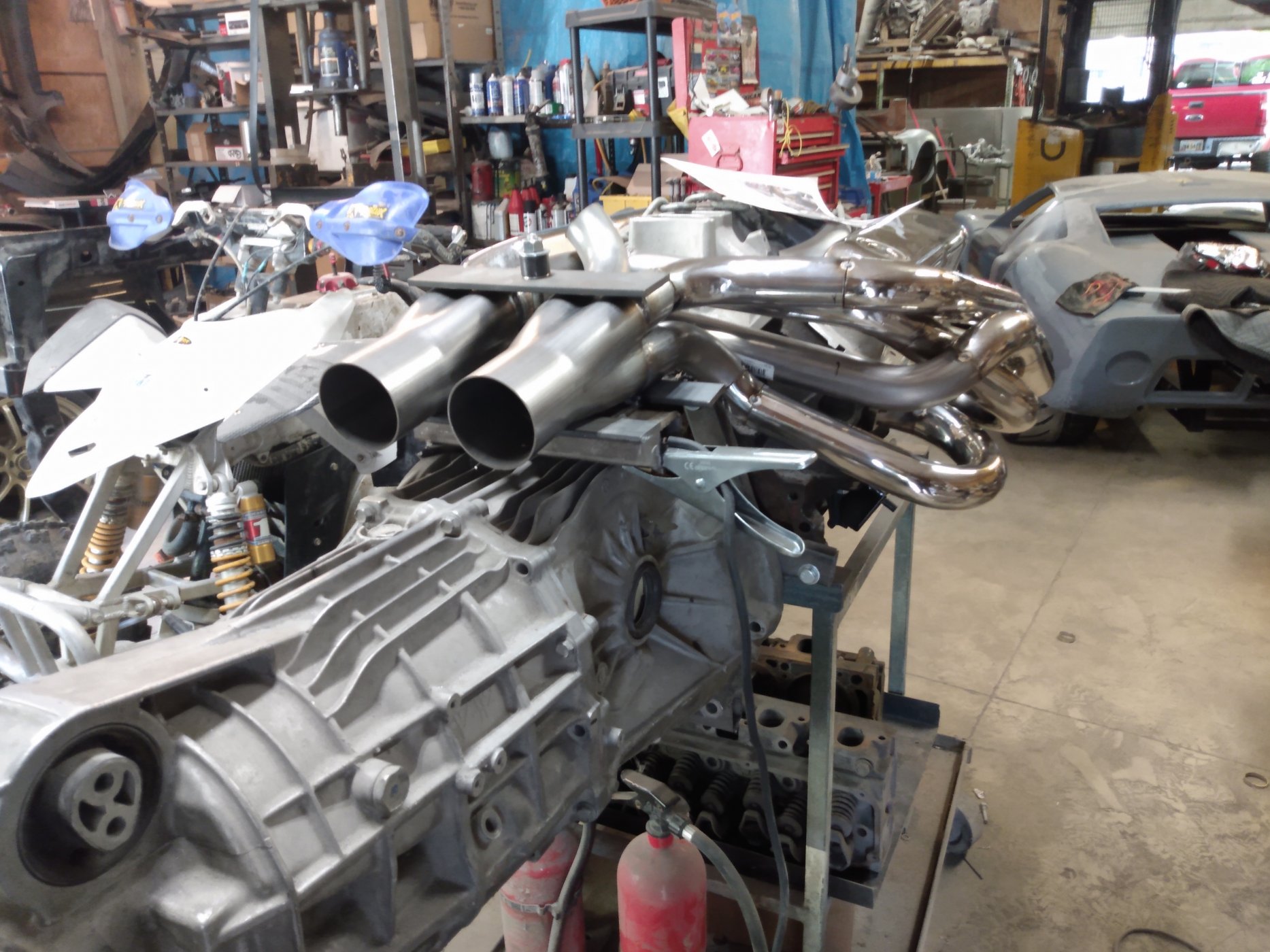

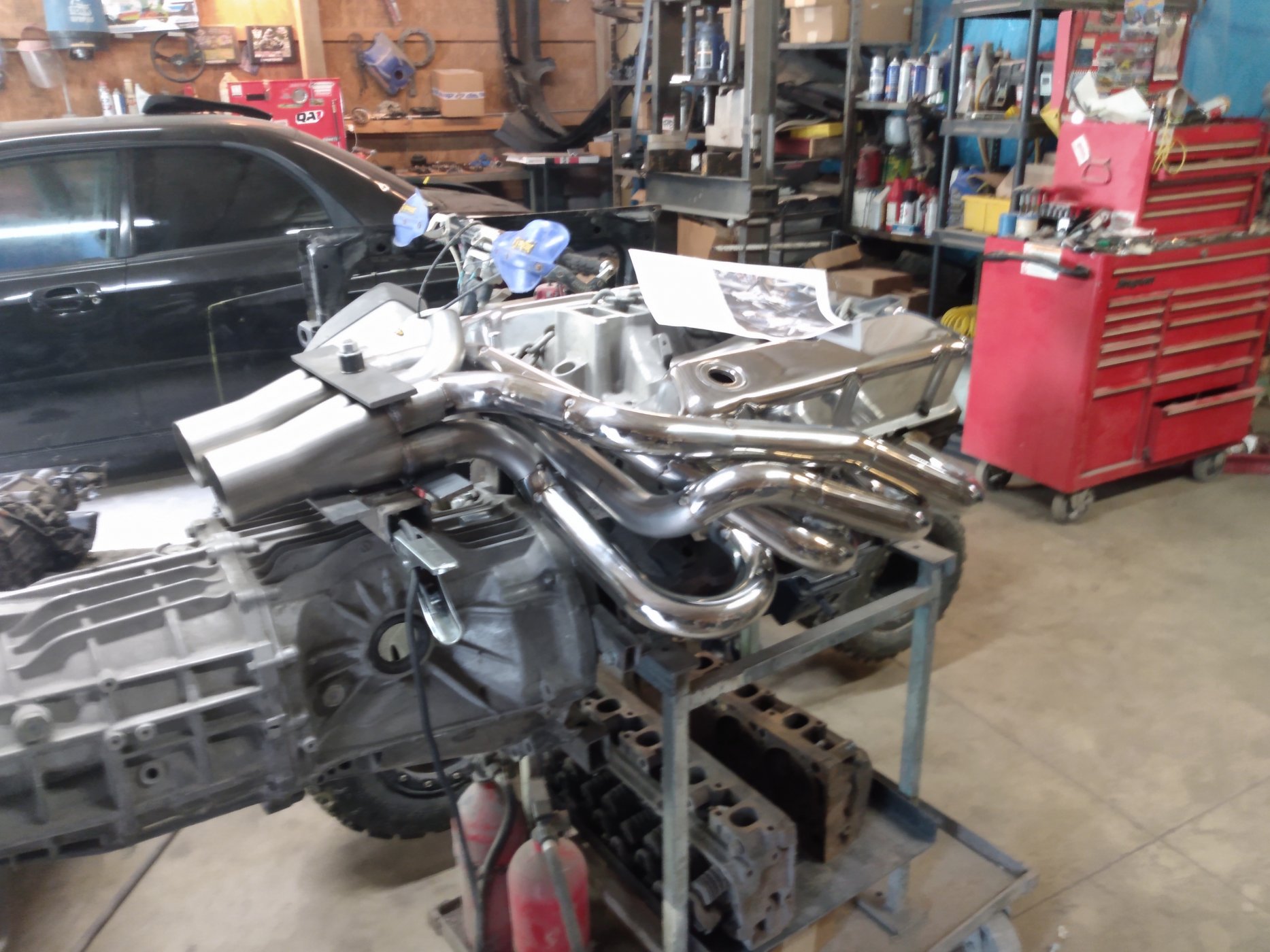

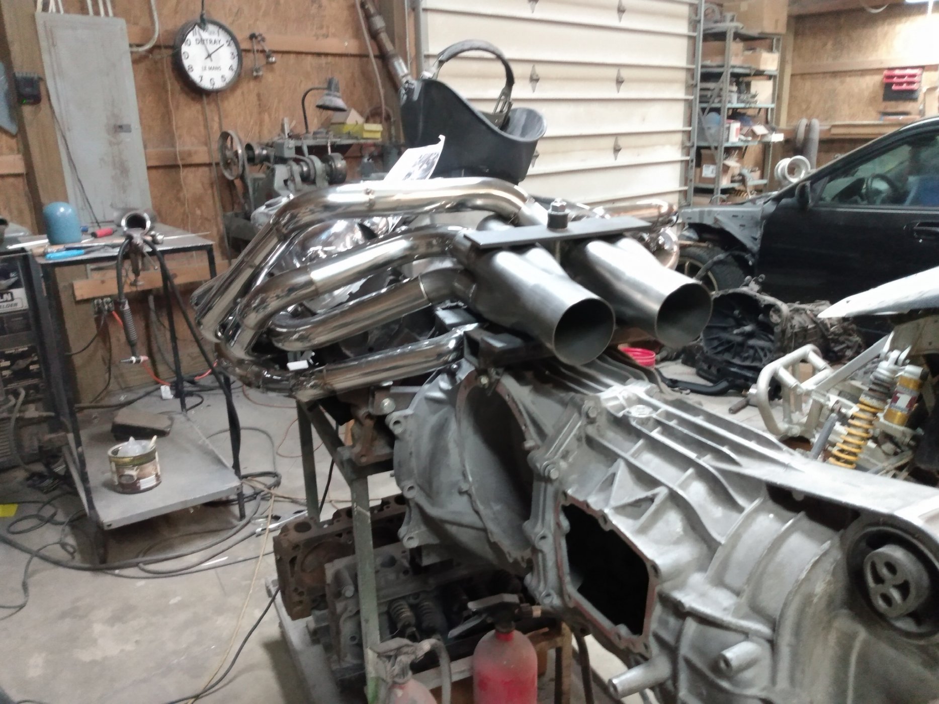

Awesome congrats. Chris is a pleasure to deal with. He is making my Stainless steel headers
Looking good! I hope your header builder is taking the raised exhaust port location of your AFR heads into consideration..

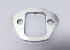

I have the AFR 220 and I'm using these.
They are a little larger than the port, but I'm going to use a little piece of 2" tube over a 1 7/8" tube at the flange and it'll work out nicely. These use the wider 3" bolt holes so you 'll have room to get a wrench on the header bolts.
But the raised ports also will mess up the tube alignments at the collectors if he's using plain old stock 351 heads.
You are correct is an issue. Any chance you know what flanges i need? Heads are AFR mpn 1451
According to AFR‘s website, the ports are 1/8” higher which means they are spread out a bit wider as well. Best to contact AFR for your particular heads to get the exact parts and dimensions.. I just know that the raised ports on my Dart Pro1 heads made fitting the 180° headers a bit aggravating. They did fit though..
If the ports are only raised 1/8", then that would move them less than 3/16 apart. Should be able to flex that much.
I thought it was more than that, but have nothing to back that up.
the big question lol, can i use them or need to remake?
Like I said, my ports were raised too.. I did get the headers to fit, but it involved using ratchet straps to pull the tubes into position so the collectors could be installed. I guess if I were you, I’d just give it a try with what he has made so far…

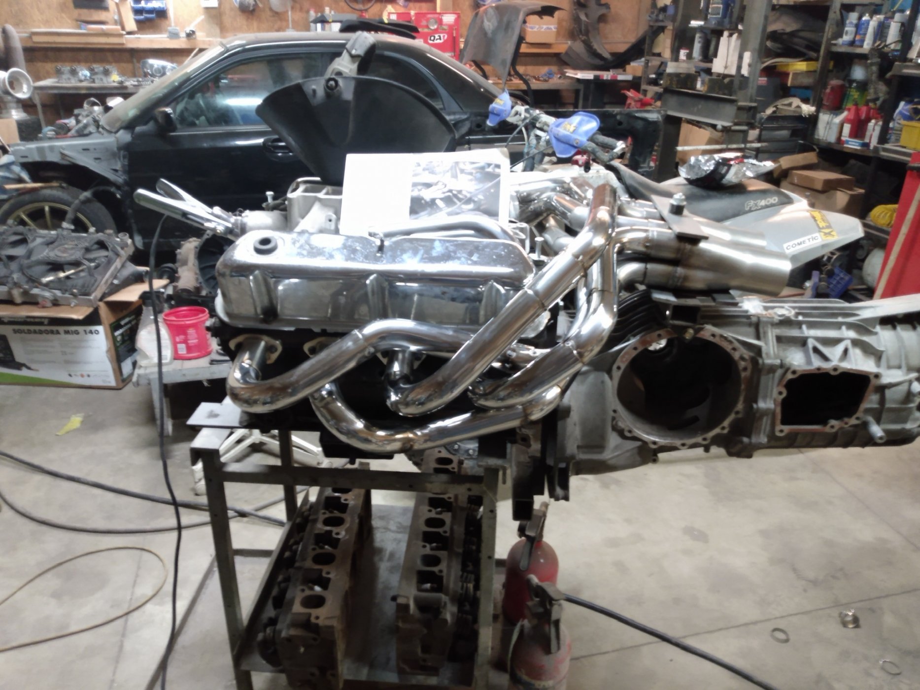

These are the flanges I've been using lately on these headers. I do use a stock 351 with stock heads as my fixture. I'm going to just take an 1/8" off the top of the flange before I finish we;ding them out, I don't see how Joe will have a problem. The 3/16 side to side concern doesn't make any sense to me, could someone elaborate on that. If it means whether it goes into the collector 3/16 of an inch more or less that another primary? That wouldn't matter.

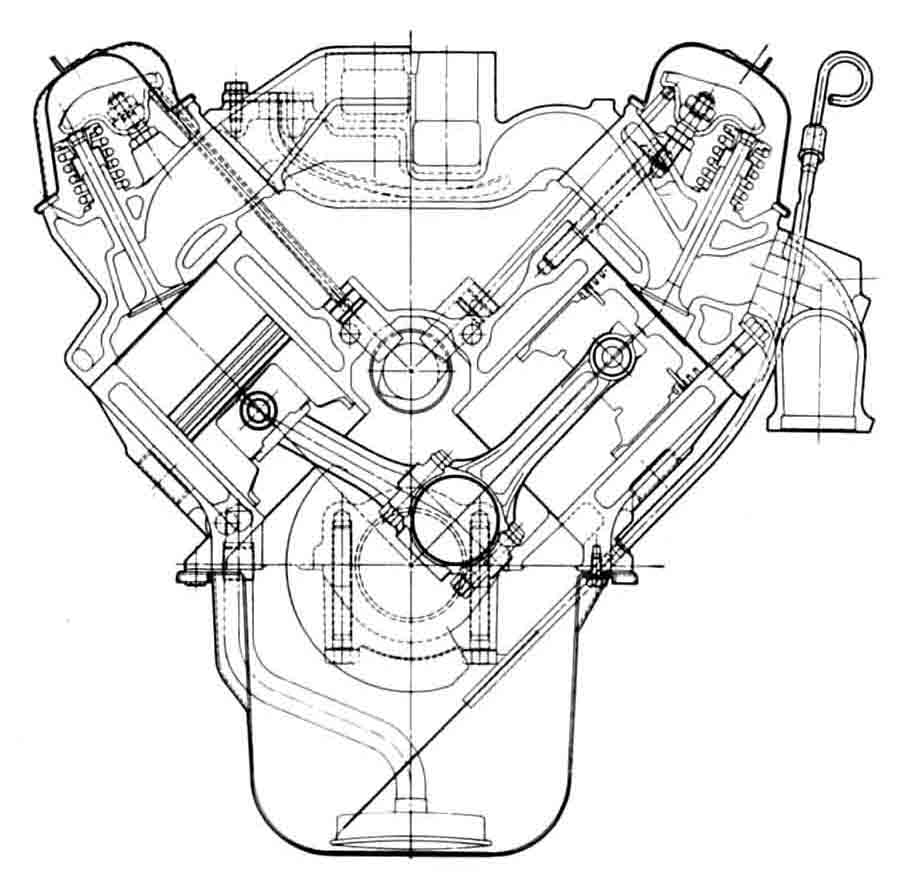

The space between the exhaust mounting surfaces on a raised port head are generally further apart from each other since the basic shape of the whole assembly is a “V”.
Maybe give AFR a call and see if they have any drawings or other info that would help…
My guestimate of width error was overstated. I was going off glancing photos and thought the flange was 45 degrees. From this crossection, it's closer to vertical, so the horizontal movement that could cause problems will be less than 1/8" Shouldn't be enough to be a problem.
