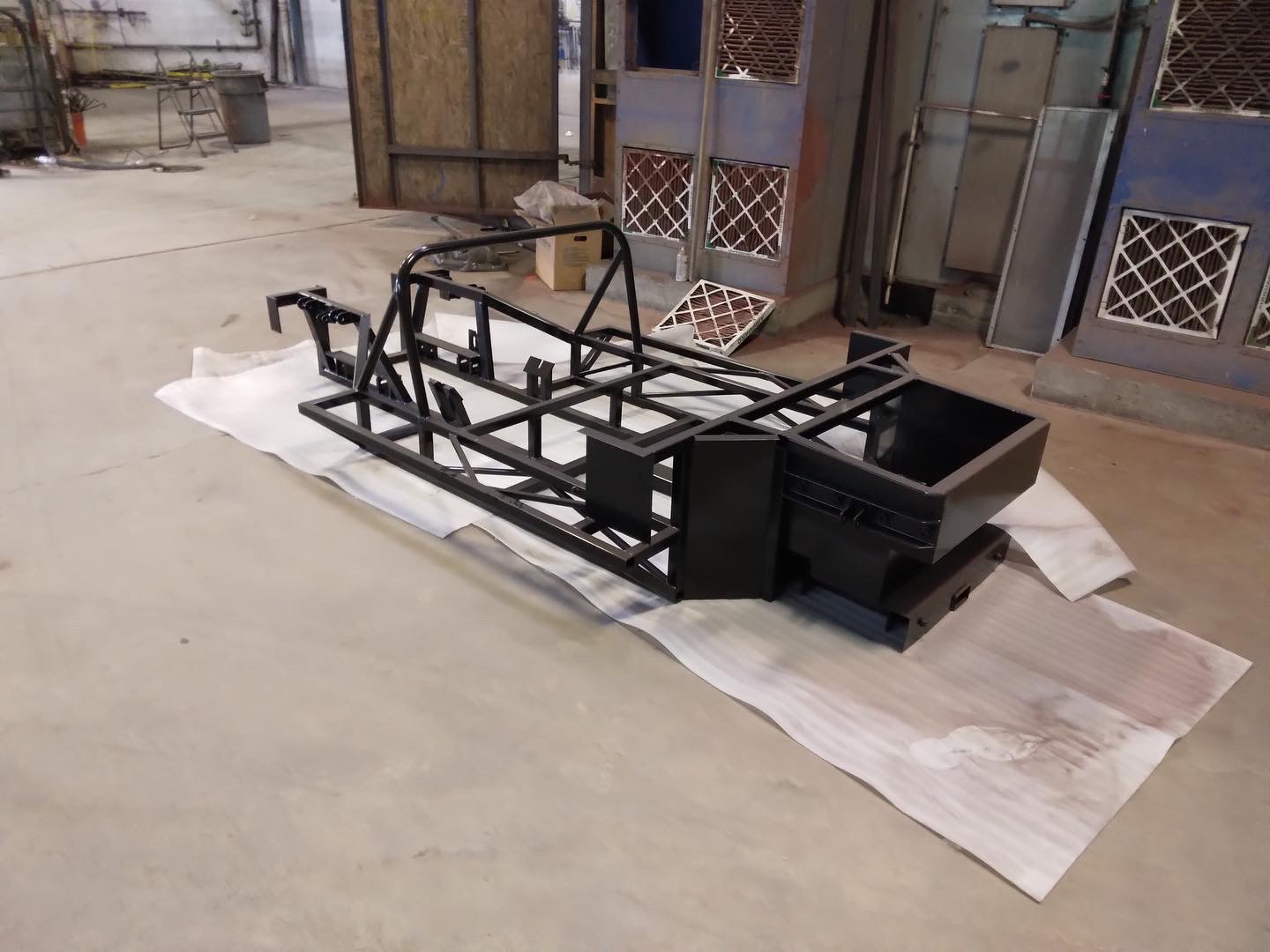

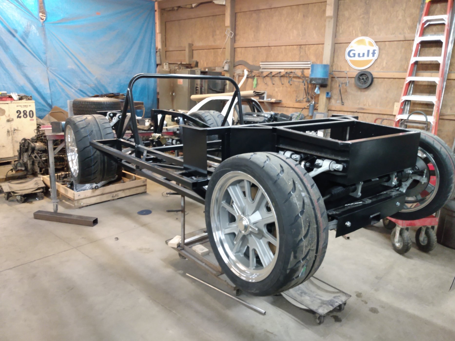

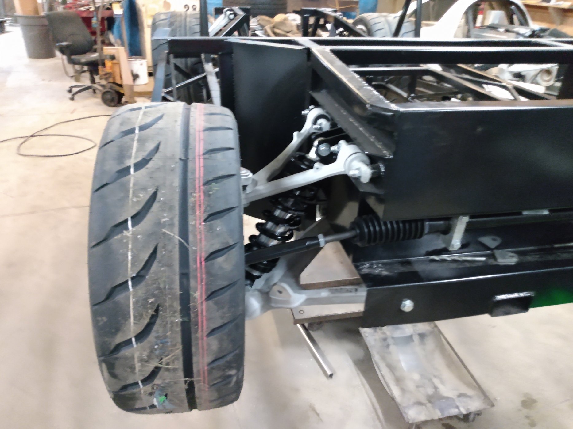

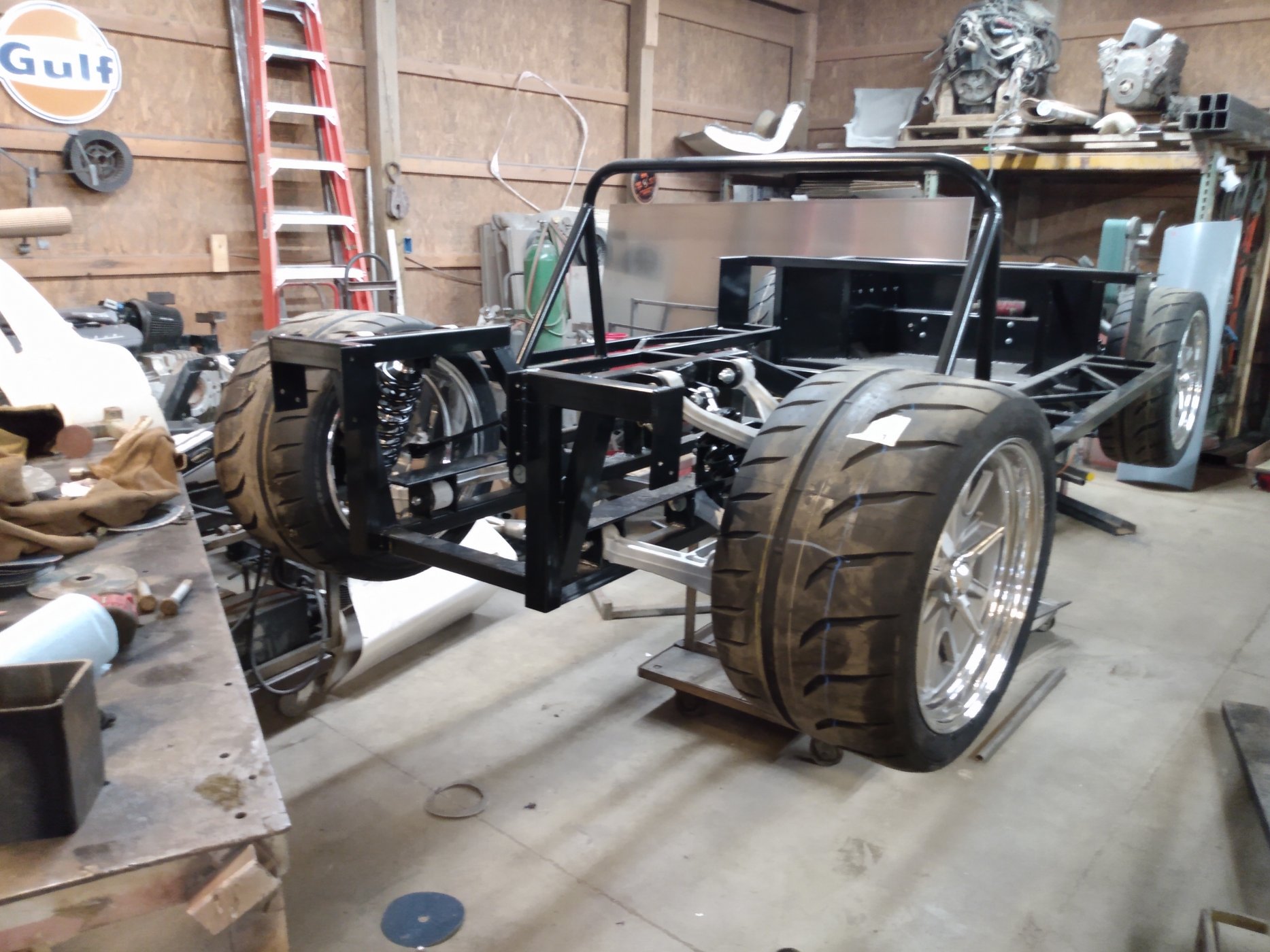

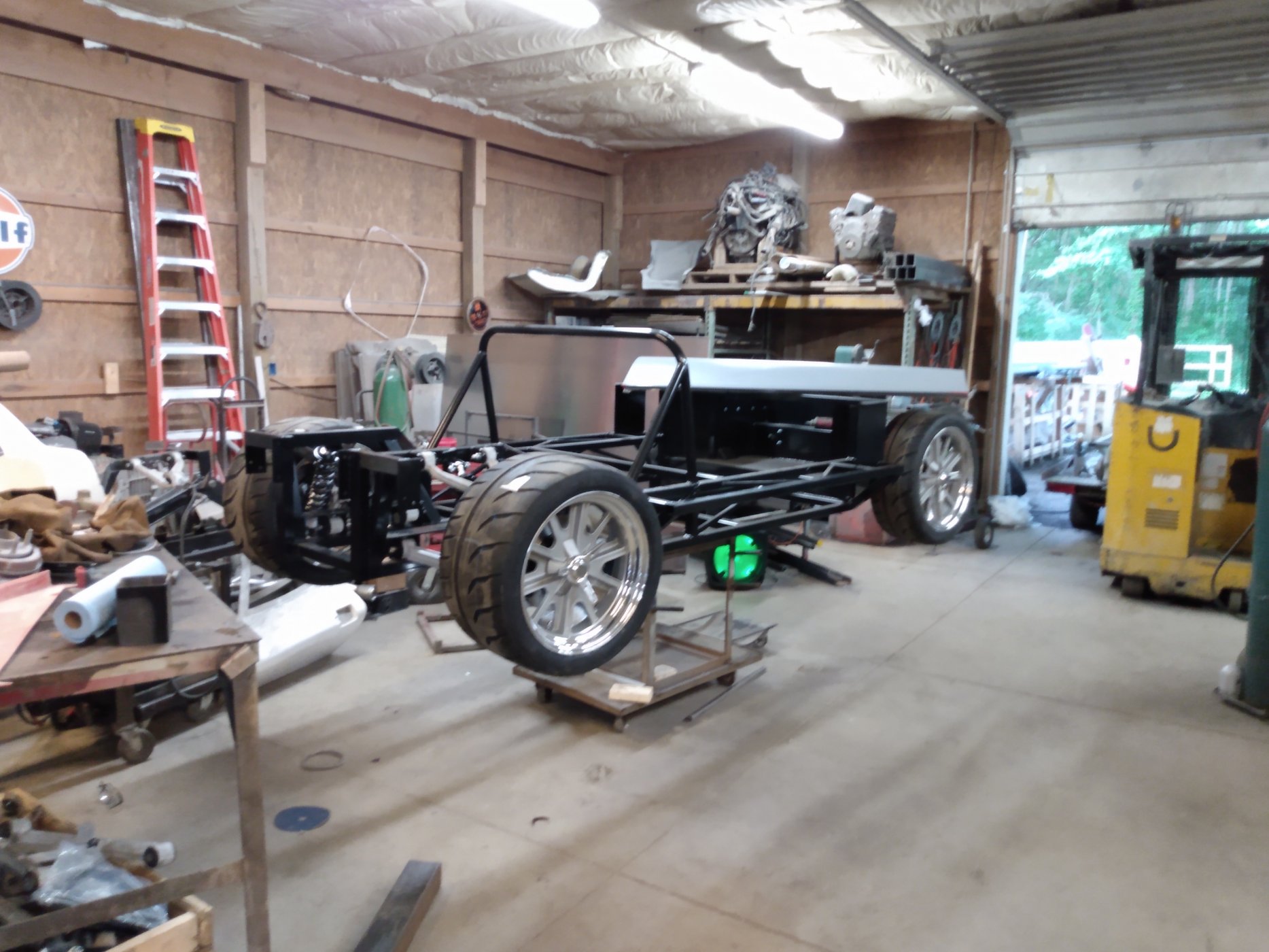

Got a Few more update pics today

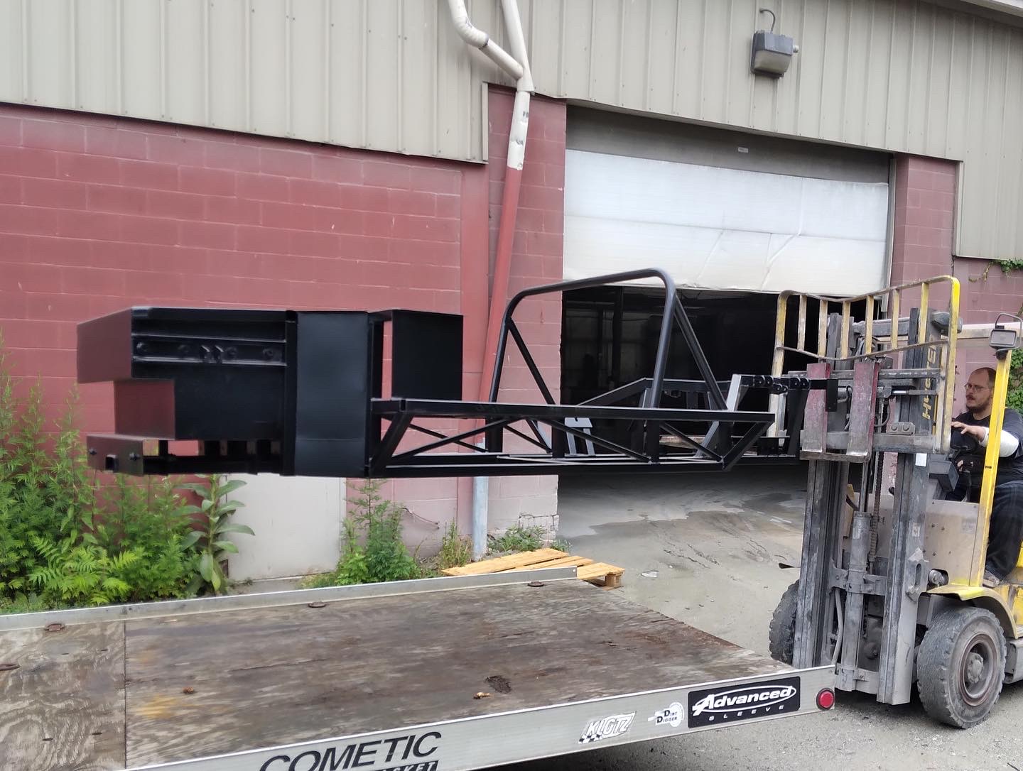

Just received email from Chris, car is roughly 3-4 weeks till ready for delivery. to Top it off he is going to be delivering it which is awesome to get to meet him in person.motor should be right after that with estimated delivery of 8/7. i cannot wait to finally start this build lol.next thing to buy is another 4 post lift before delivery

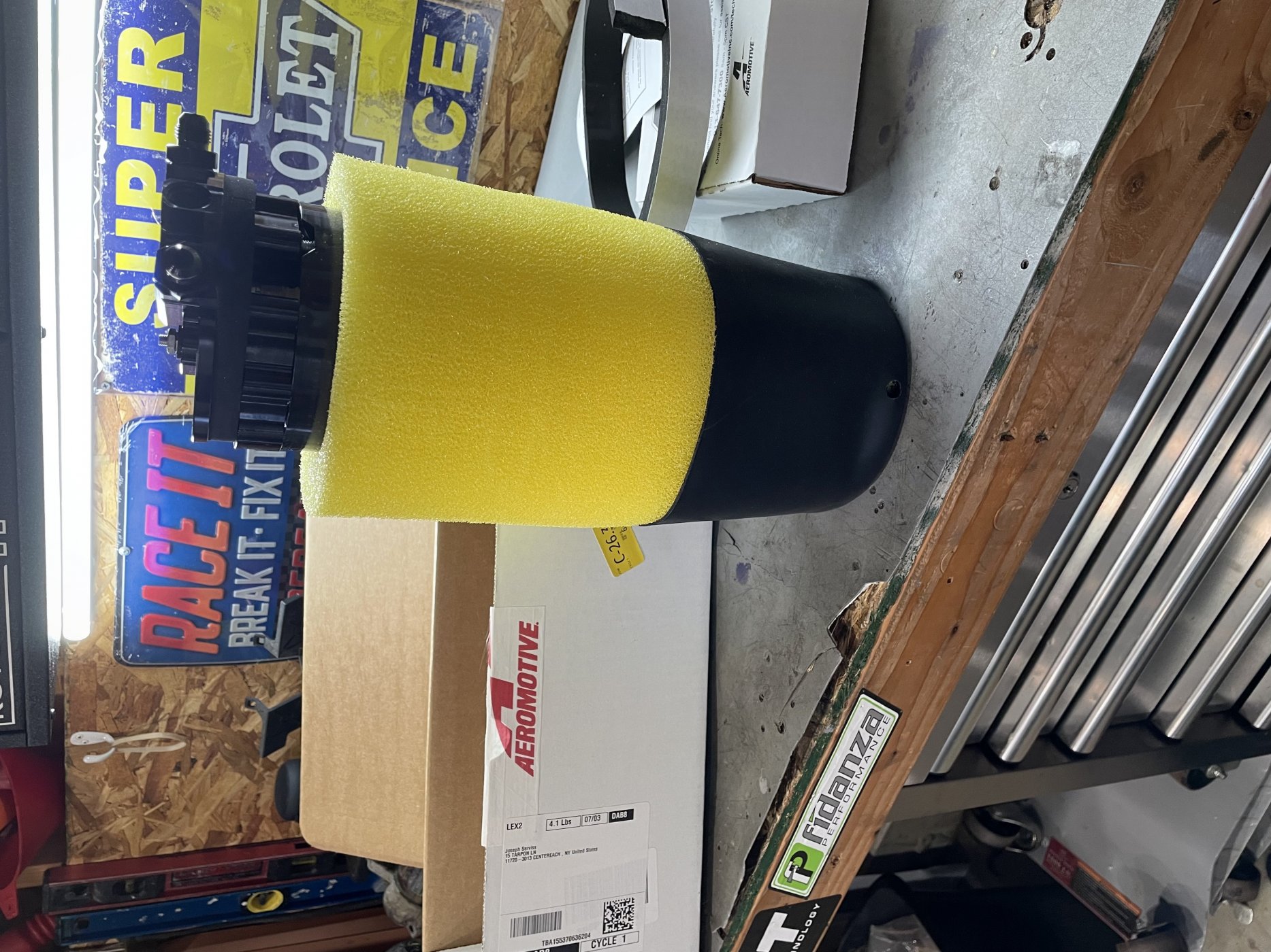

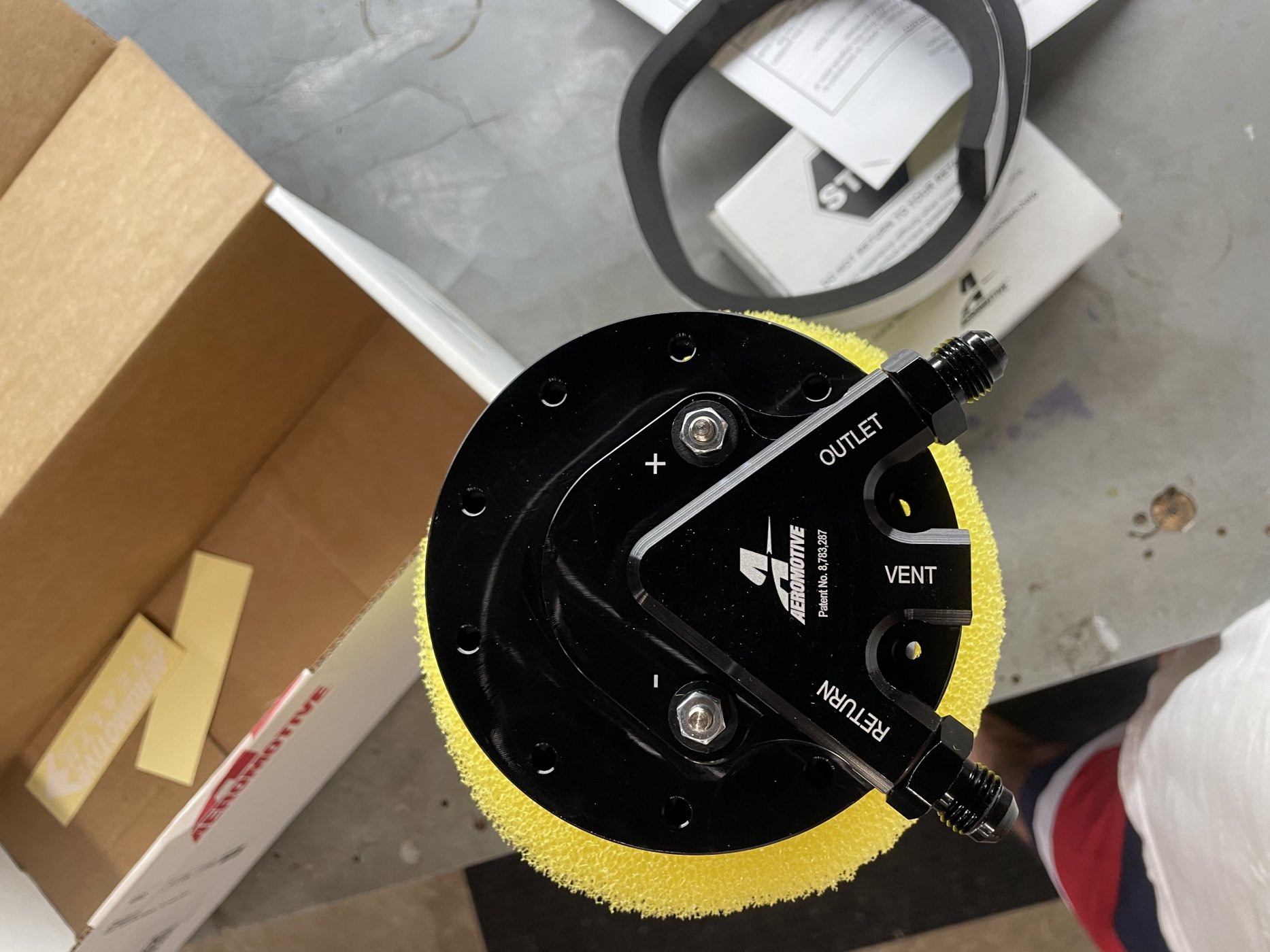

Fuel pumps came today. After putting this in cobra i decided to go with it again in the 40. Went with the single pump for 40 my cobra has twin pumps.Aeromotive stealth setup.what a nice clean pump system they have with this setup.hands down best ive used so far.
Vinny P
Chassis is looking good, Chris did a great job! How deep is that Aeromotive pump? is that also a swirl tank or just the packaging?
If you are looking for a scissor lift, I found that Amgo makes a decent lift model MR06 might work out well.
Pump can work with tank depth of 6-10”,the foam is cut to fit height needed. No swirl tank Going from pump direct to motor.this pump eliminates the need of swirl tank. I’m set on another 4 post,I like them the best.
