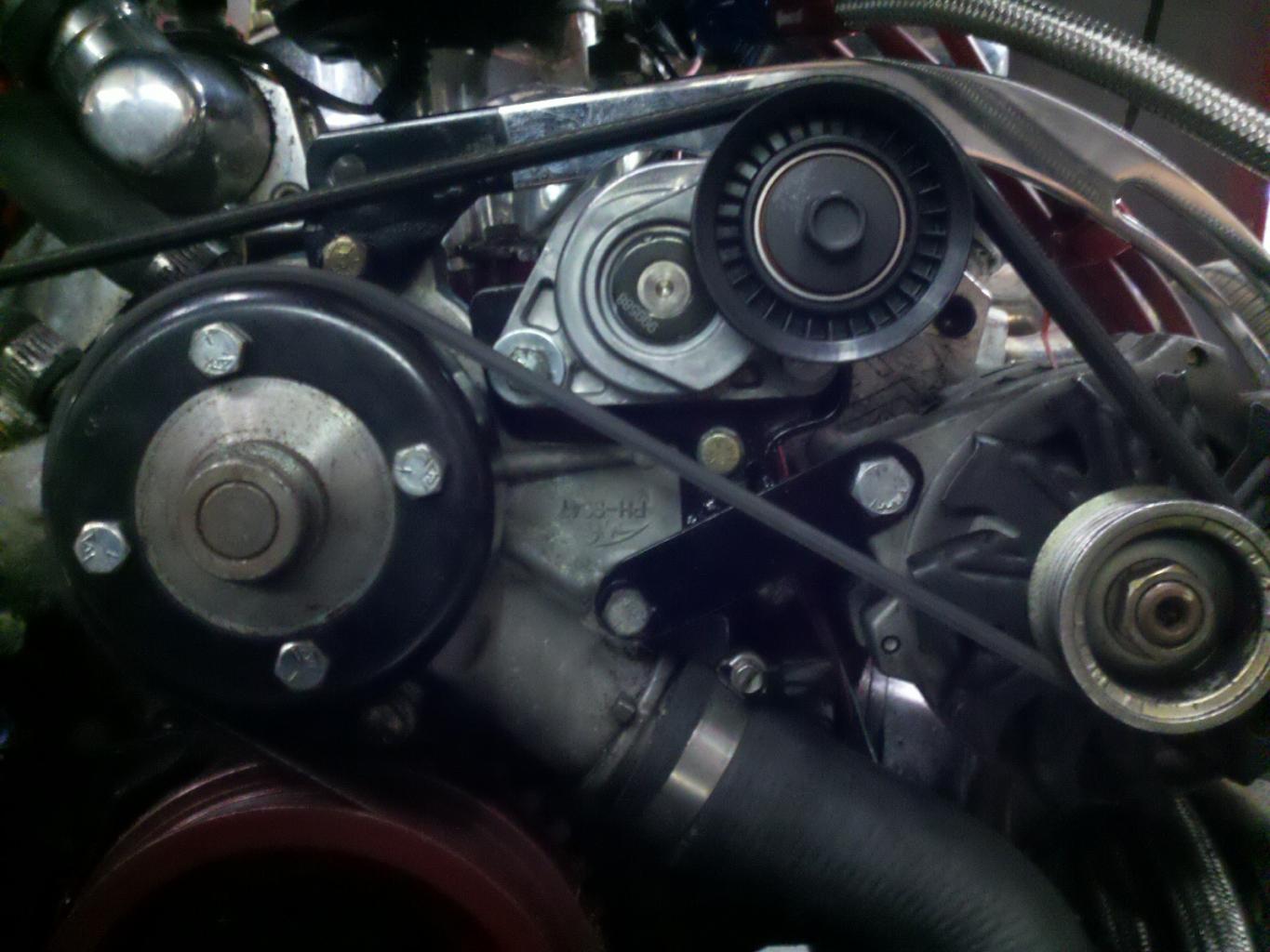

I have also made a few upgrades to the car recently. I added a belt tensioner to my serpentine set up. It is off a 2004 Corvette. I had one handy off my GTM so I could measure it to see that I could make it fit. See the attached picture to see how it mounted up. I could not get the belt tension set to not slip when the engine was cold and the AC was on and not chew up belts like crazy. This has fixed both issues.
