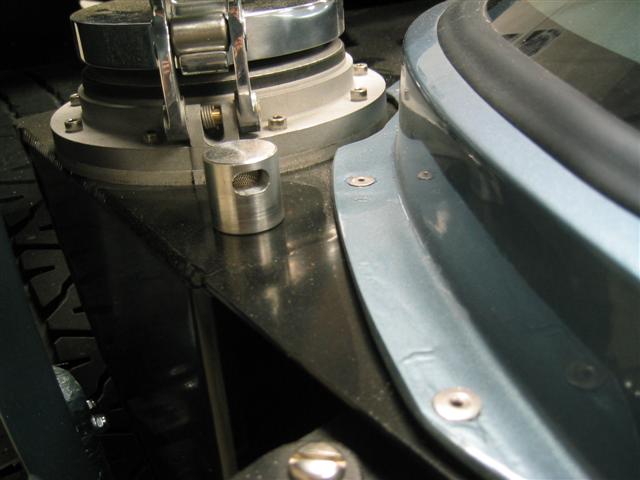

I got the breathers from a Marine Supply store. I don't remember where but I don't think you will have troubles finding them. Marine Supply is also a good place to source the fuel filler hoses.
Jim, I plan on running the Dragon in it next year.
Chuck
West Marine, Model 138792, chrome plated brass that fits a 5/8" hose. $10.99. Described as a "thru-hull vent."
Rob
I highly recommend the ones Chuck mentions from Street Rods by Michael. I have them and will use them again.
Ron McCall
That's what I have as well.
