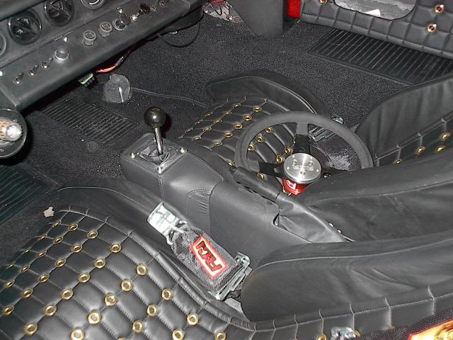

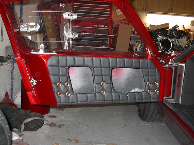

I just got my car back from the upholstery shop. They covered the center consol that I built including making the boots for the shifter and parking brake. I made the trim ring for the shifter out of a piece of aluminum plate since the size needed to be exact. I gave the shop free reign on the door panels and they came up with a neat idea on their own of using grommets on the door panels. I think it turned out very nice. I plan to paint the inside of the door panels in a satin black to cover some overspray in the doors. Here are some photos:

I am really liking that center console.. I've been puzzling over how to handle mine.. I think I just got another idea! Thanks!!! :)
The Door panels are very period correct looking and with the grommets match the seats.. Very unique!

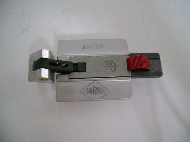

I found some aircraft latches that are similare to the Hartwell latches but much cheaper. They are a little narrower than the pockets on my car. Since I have already painted I will probably fill the gaps with some aluminum spacers. These latches are only $50 a piece. They will require some trimming as well. If anyone is interested in a set I can PM you the contact information to buy them. Here is a photo of the latch:

Interesting... Please send info... I was looking at some similar but I could not tell by the photos if I could make them work..
While they'd probably work fine - I really don't want to put the ones on that I have..

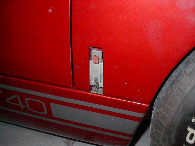

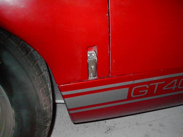

I got 2 of the new latches mounted. It was pretty easy to get them installed. Here is a picture of the old and the new latch:

I failed to answer the would I do anything different. So far I have not found anything I would do differently other than the ring and pinion swap I mentioned earlier. I am happy with how everything turned out.
