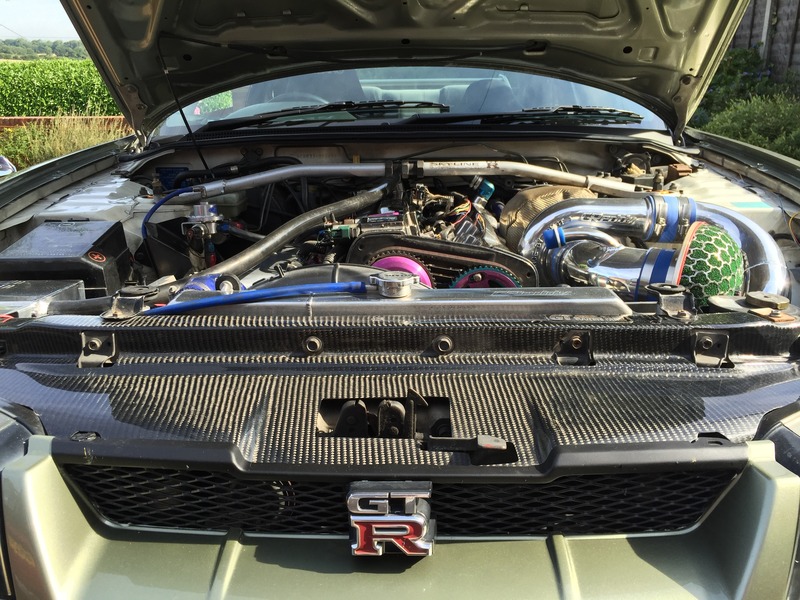

Came from GTR’s myself, nice to see others don’t have to choose sides between import and V8 :D
These are my last two:
