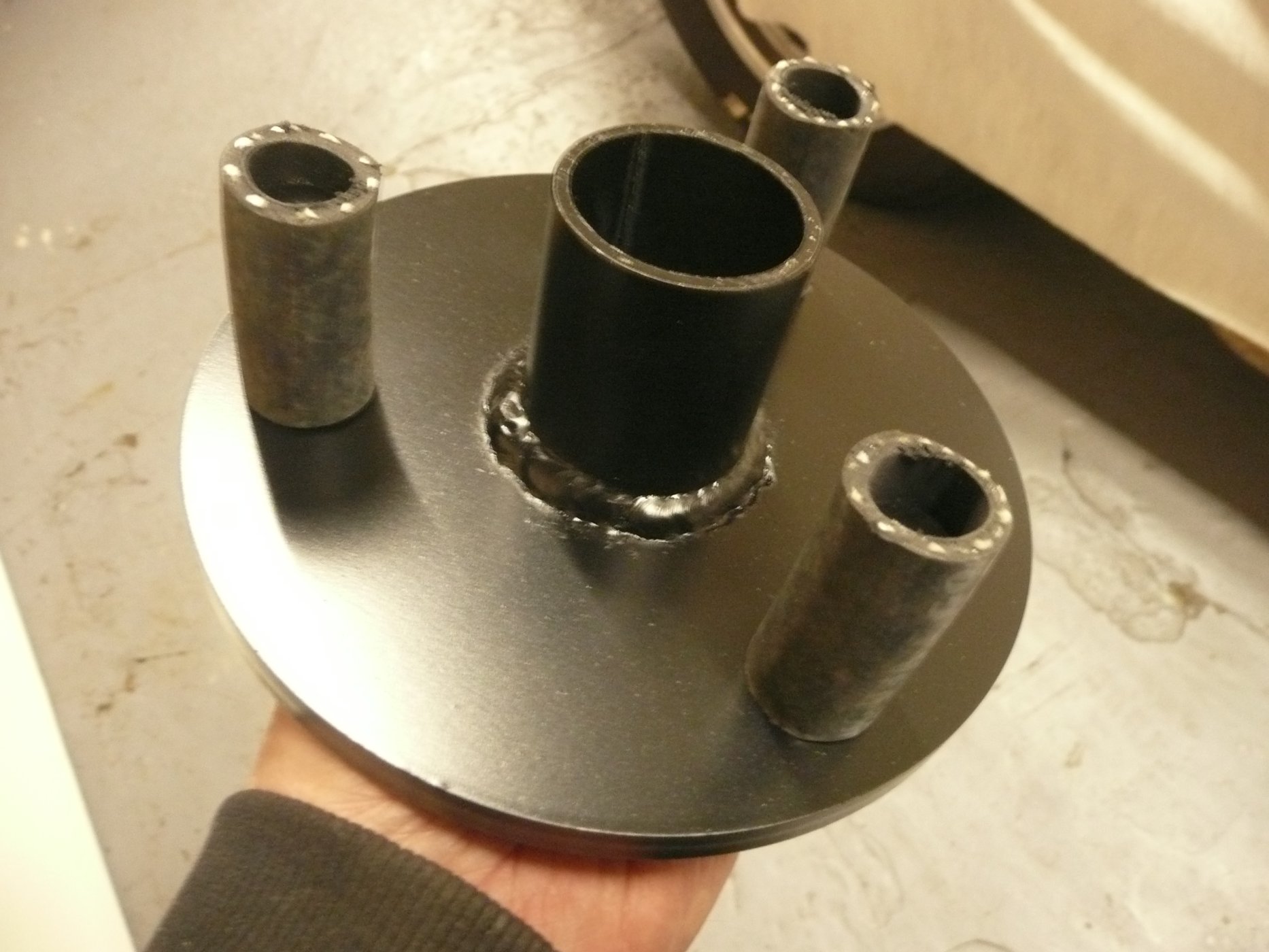

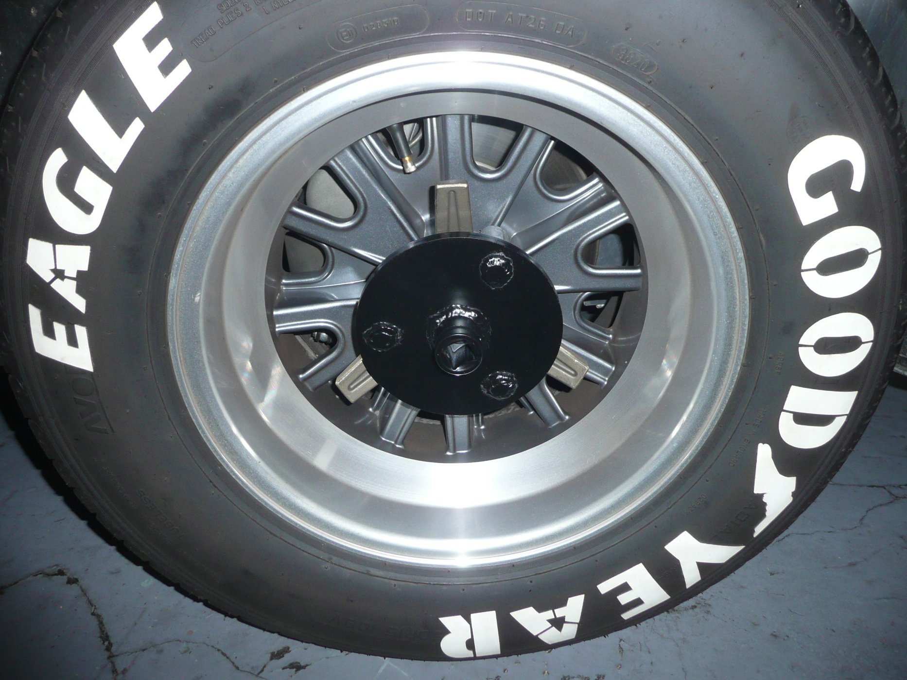

We have a tool available for spinner removal and refitting.
Why risk hitting your expensive wheel rim with a lump hammer? And trust me you will at some point.
Or snapping an ear off your expensive wheel spinner by putting shock load all on one ear?
Using any type of hammer damages the spinner when you hit it as hard as you need to.
The tool engages with the hole in the hub, has rubber protectors so as not to damage the spinner and evenly distributes the force through all 3 ears on the spinners to reduce load.
Use a 3/4" drive breaker bar or even a suitable torque wrench to ensure the spinner is tightened to the correct torque.
We have even used this tool to remove a stuck spinner that the customer had already broken 2 ears off the spinner using a lead hammer.
