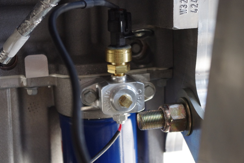

Mike, I recognize the bottom sensor in your picture, but not the top arrangement. Was that part of your KOSO kit?

oil temperature can be taken from the remote block-off plate above the oil filter. unbolt the block off plate and install an adapter for npt:
CBM MOTORSPORTS LS STYLE BILLET OIL PAN UNION FITTING ADAPTER
PeteB
Putting the KOSO sending in the water pump, the temp reading on the gauge reads exactly the same as the ECU.
I drilled and tapped a hole in the water pump for the KOSO water temp sensor.
I used an adapter from Improved Racing (Oil Accumulator Adapter for LS Engines EGM-116) to plumb in my Accusump and it has two extra 1/8 npt ports that I used for the oil temp and oil pressure sensors.
