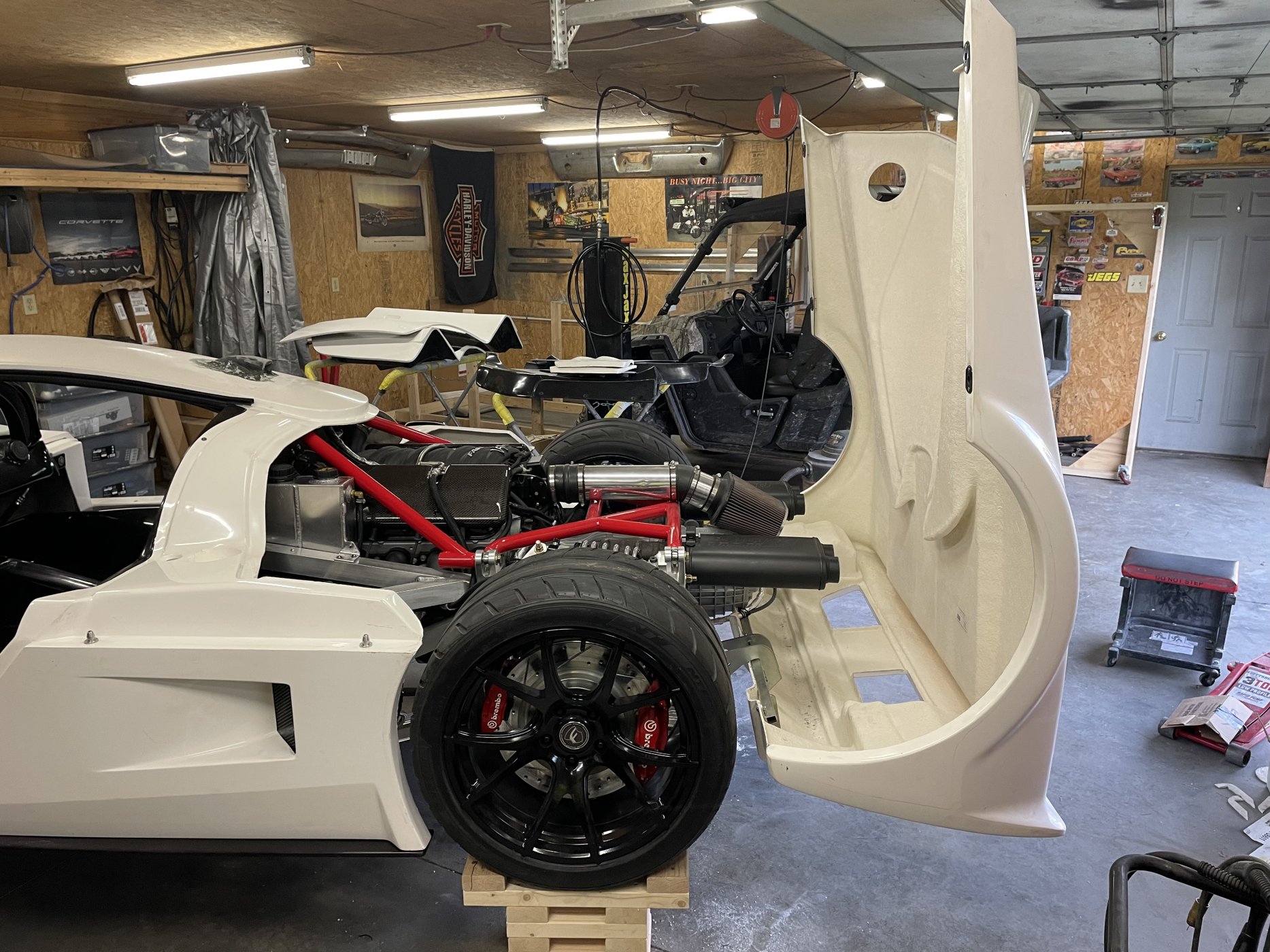

Last time I worked on my SL-C to any significant degree was back in June this past summer. From that point the summer got very busy for us and I did not spend any time out in my shop. In August my wife after substitute teaching for the past 15 years accepted a full time teaching position at a local Catholic school teaching 5-8 science, 8th math, and 8th religion. She is doing great and enjoying the career move a lot but it has been a joint effort between the two of us. I have been helping and supporting her whenever I can in this job. She accepted the position three days after classes started for the year so she had no lessons prepared or anything to start. It has been week to week, day to day since then. Needless to say, time in my shop has been non-existent, until tonight.
I finally touched my SL-C again this evening and decided to work on something that would give me some great visual progress gratification. First I will update progress from this past summer. After getting my mill in place I managed to get the rear clam hinge setup installed. There are not a lot of pictures in the build logs on here of the street tail hinge installation so I am going to post numerous of my setup.

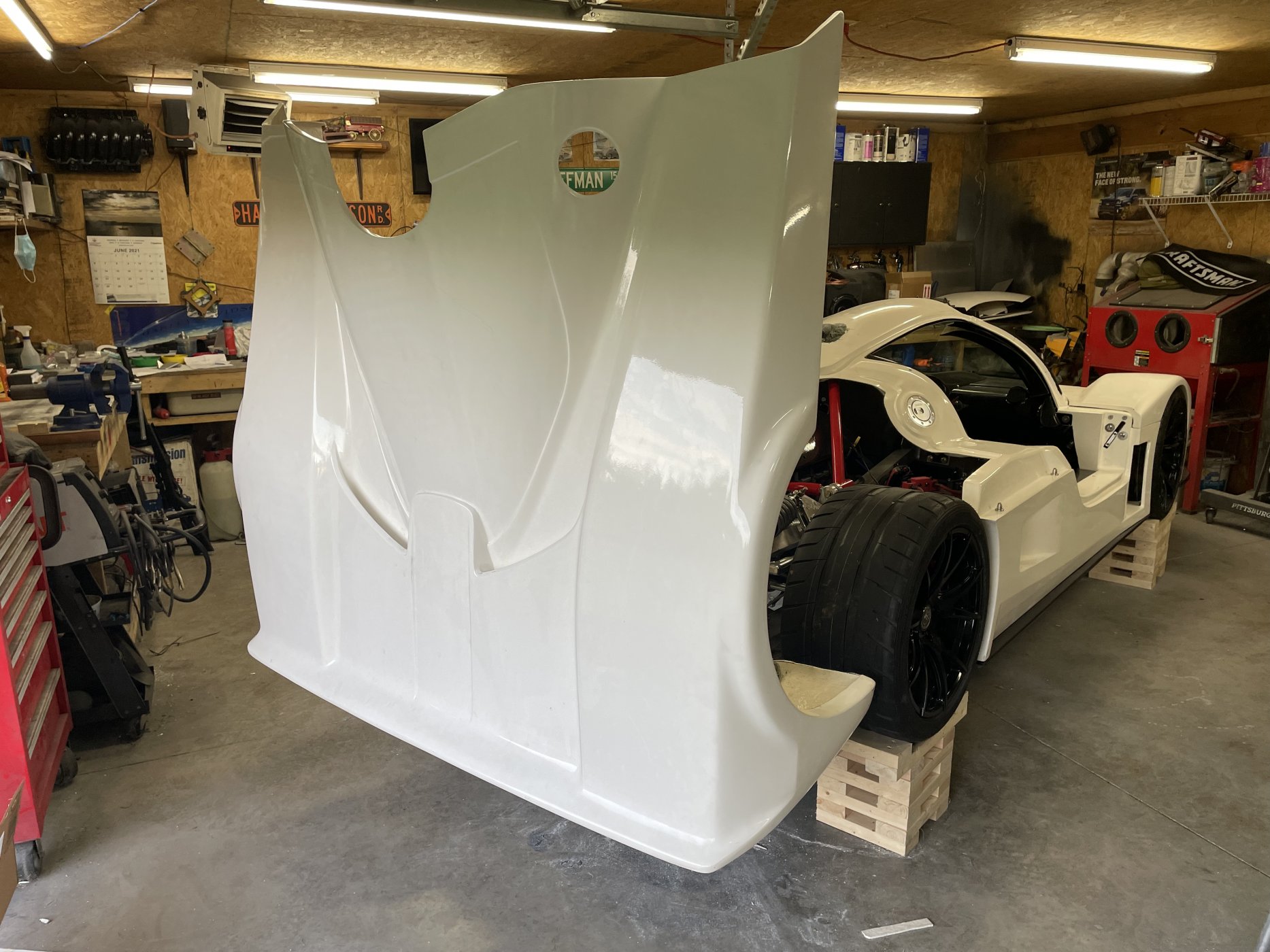

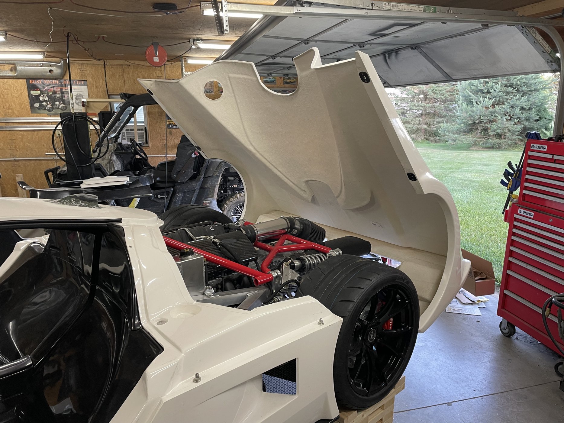

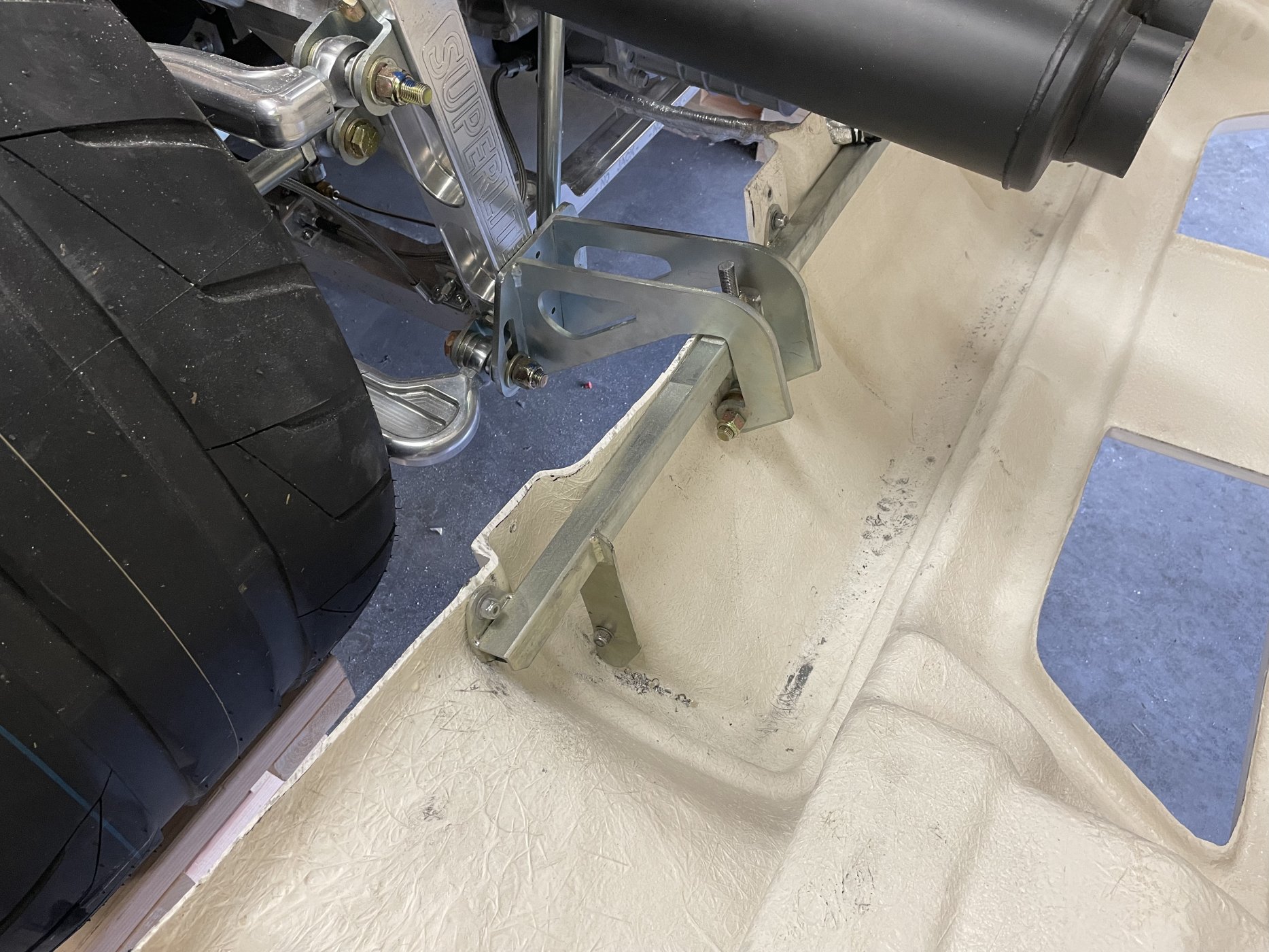

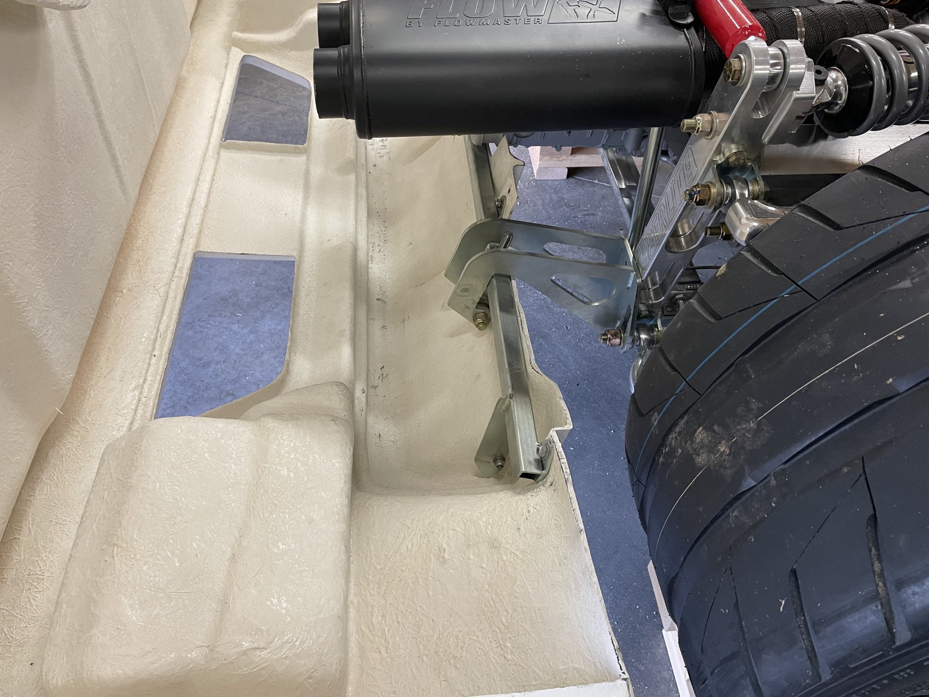

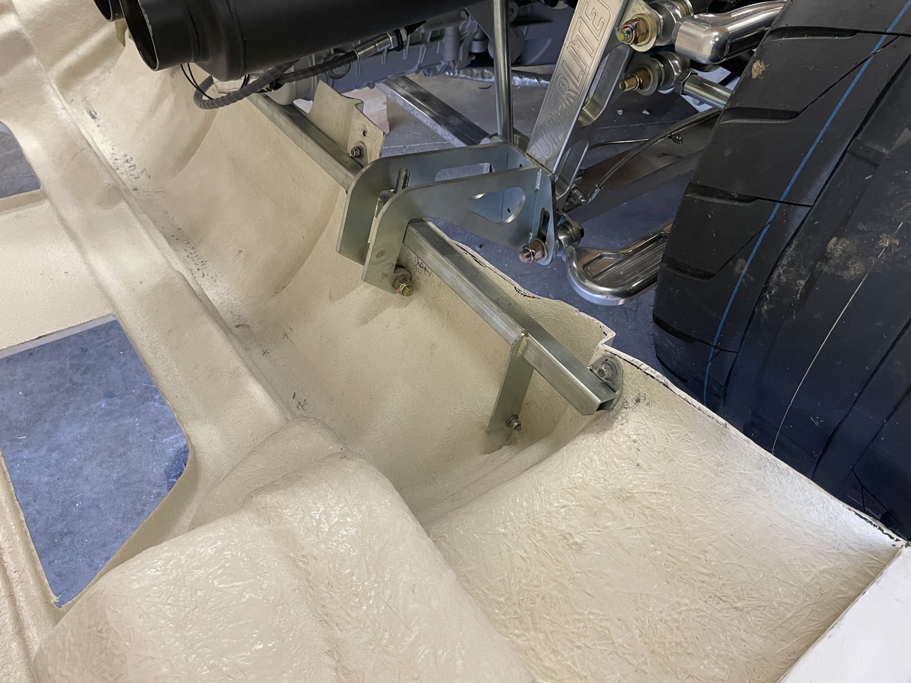

I had to cut away of lot of the rear clam to get the hinge bar installed. There is really only one position that the hinge bar fits to the rear clam and it is a very, very tight fit.
I ended up removing the rearward mounting tab from the outboard end of the hinge bar in order to get the clam mounted forward far enough.

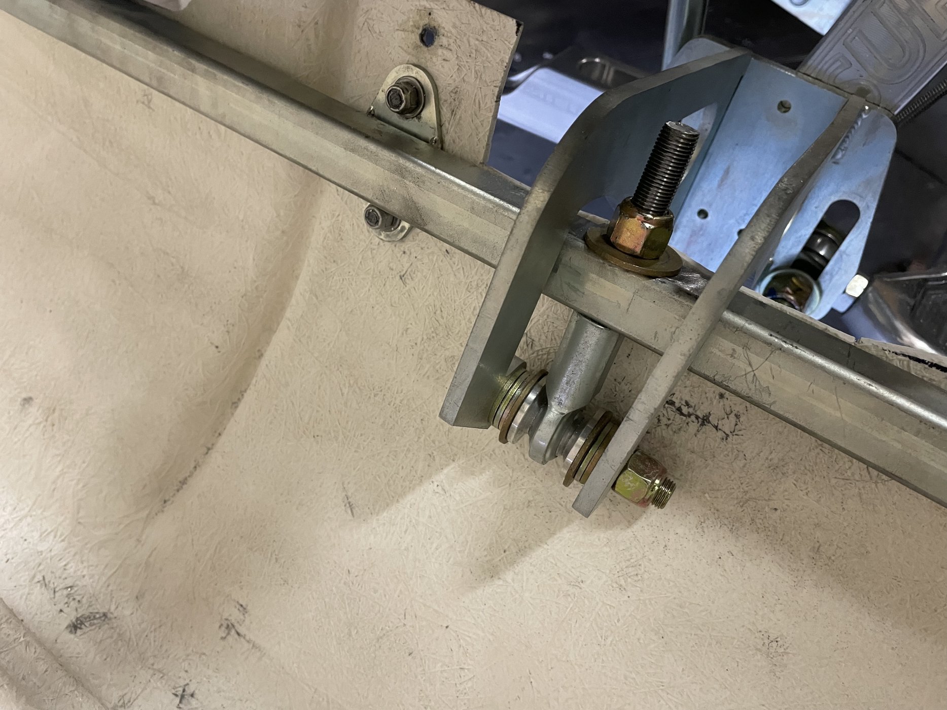

I removed the nuts welded onto the hinge bar and went with female threaded rod ends instead of the male rod ends supplied with the kit. I will replace the threaded rods and nuts with bolts at a later date.
I still need to clearance a rib on the bottom of my transaxle that is rubbing on the hinge bar, other than that everything fit up very well except the rear wheel spacing in the wheel wells.

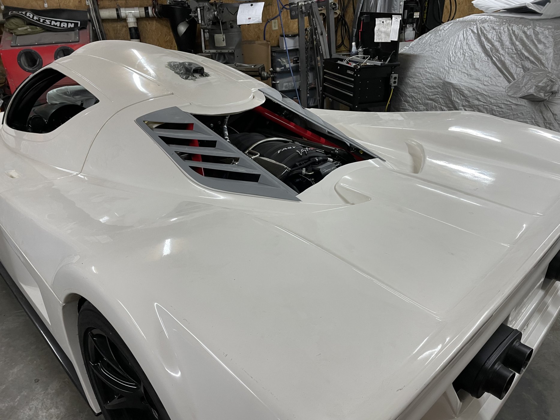

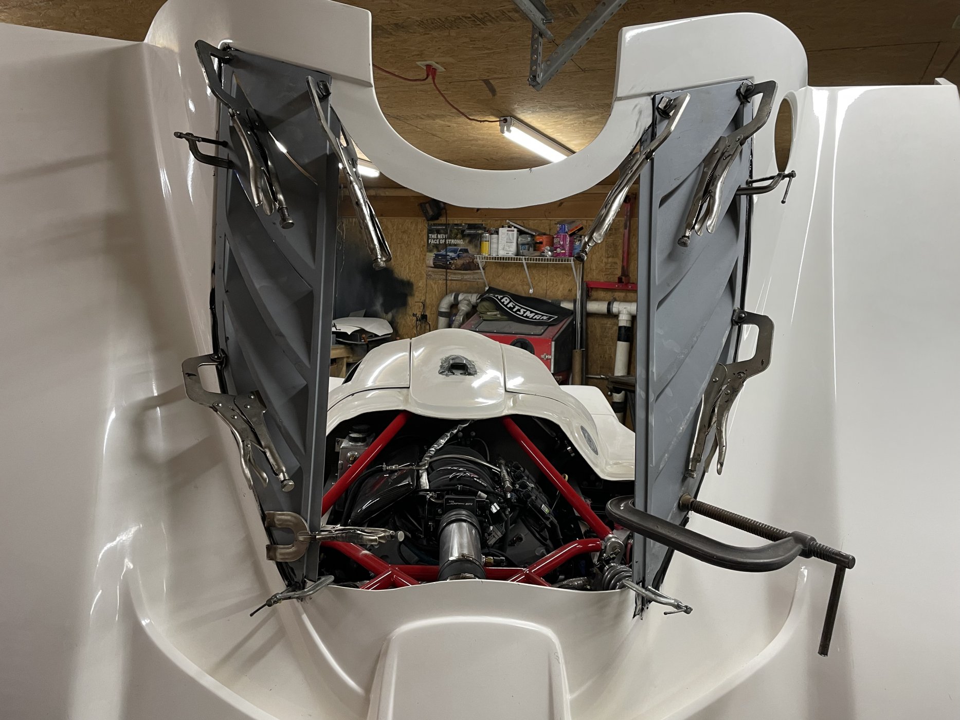

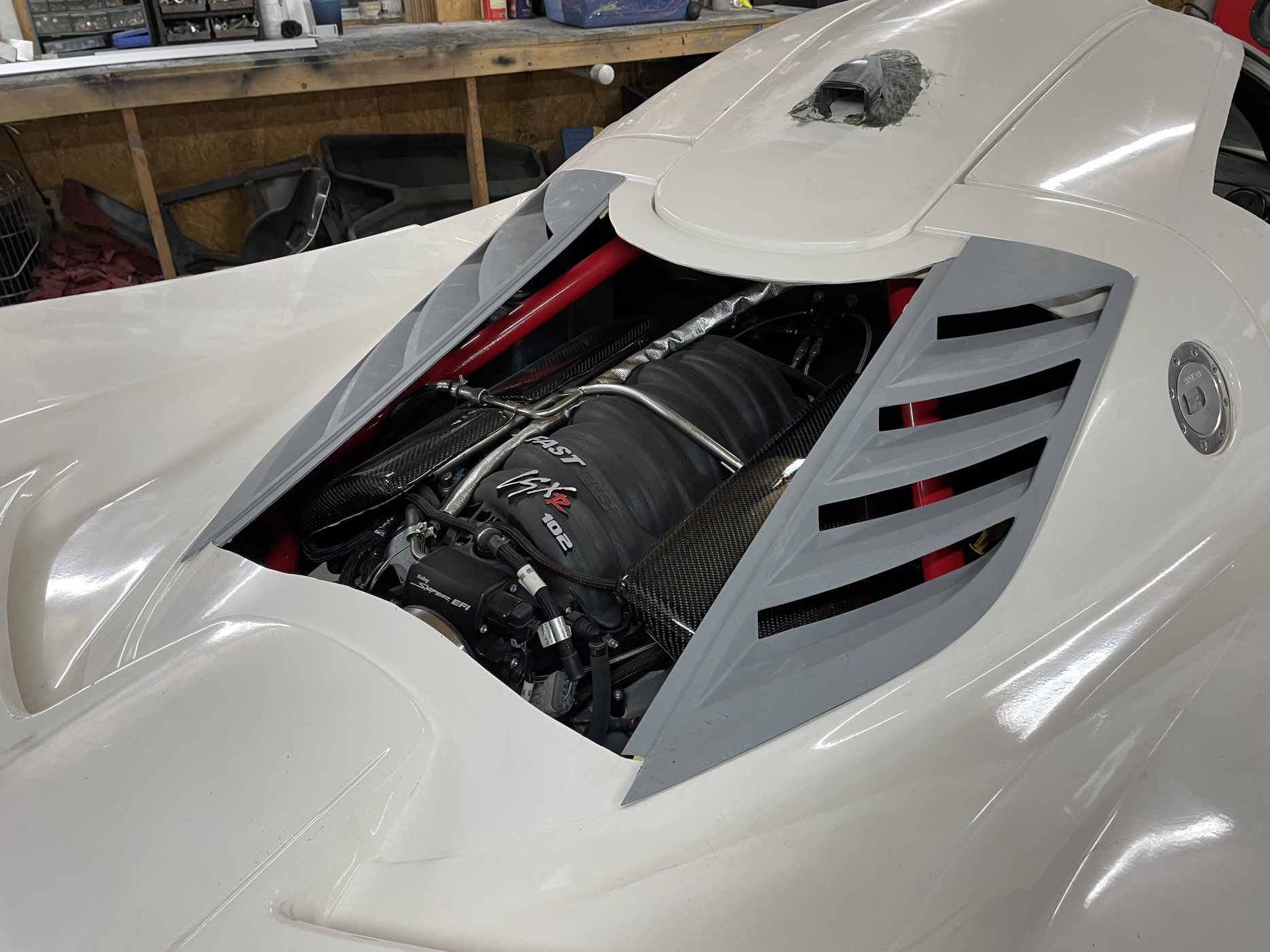

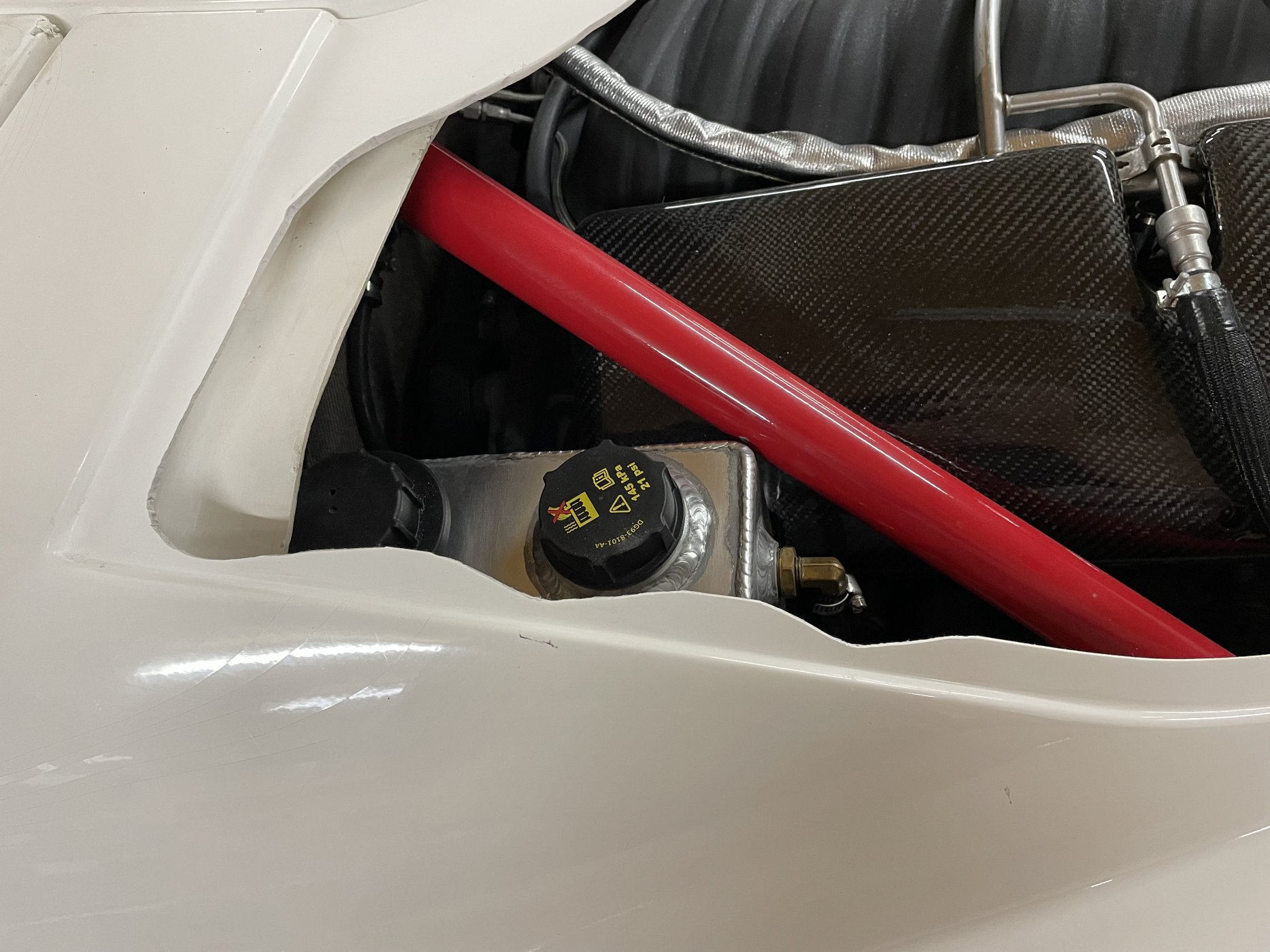

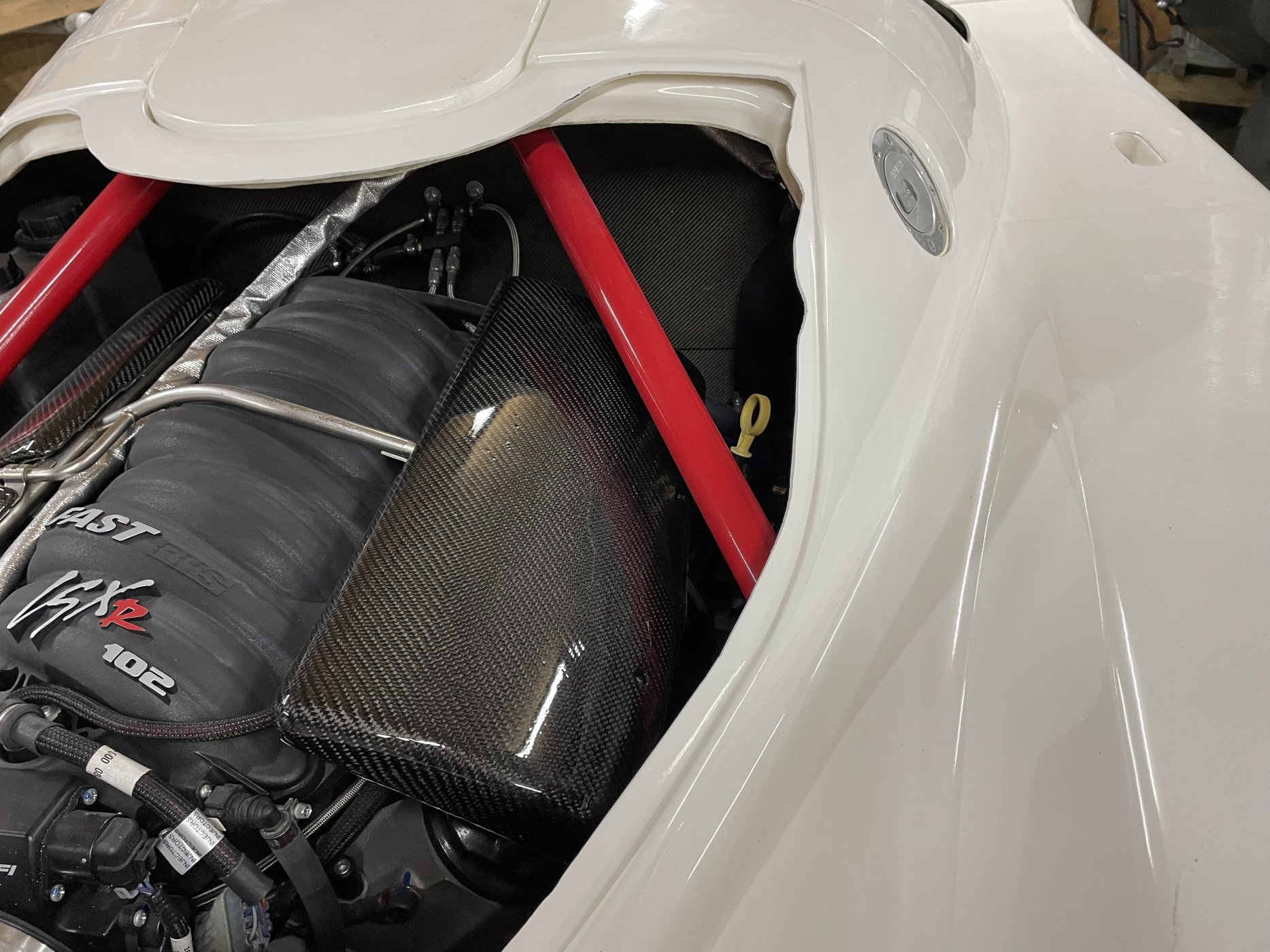

On to tonight's progress. I decided that since the rear clam is now installed I wanted to install my rear window vents to see how that is going to look. I have the fiberglass vents (not the carbon versions) and plan to graft them into the rear clam so they appear to be a part of the original clam design. I have seen one car that Alan has done this way so I cannot claim this as an original mod of mine, just a copy of the master.
Cut a BIG hole in the rear clam and fit the vents.
Some "fancy" notching is required to clear the vents.

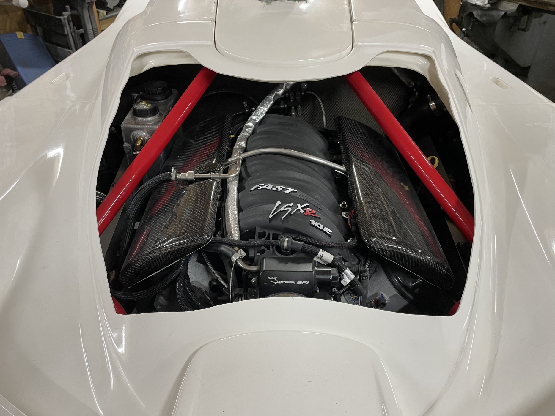

I LOVE being able to see the FAST intake thru the rear window as well as my body color matching roll bars. Seeing this has really re-energized me to work on the car after my long hiatus.

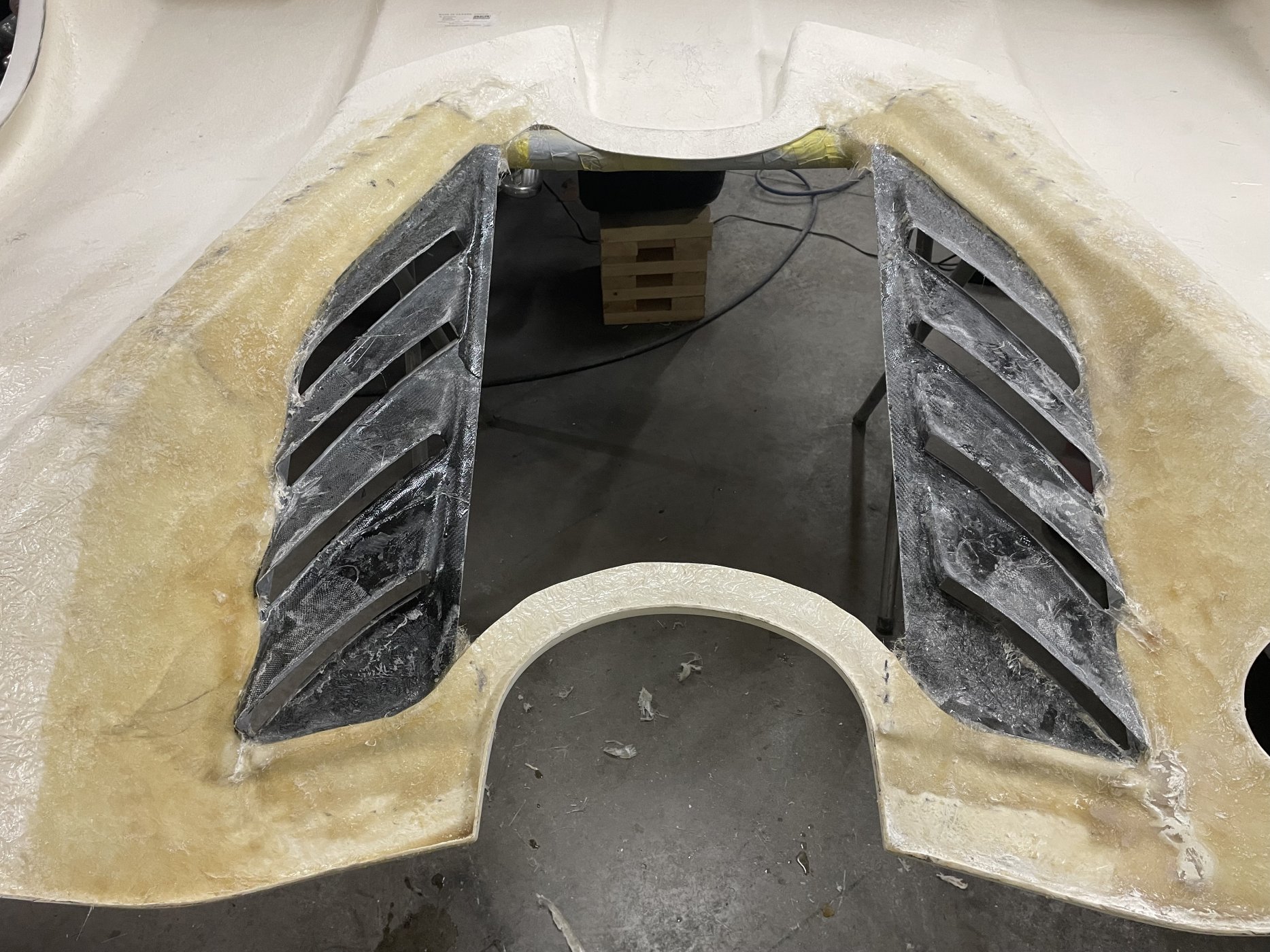

After fitting everything up I bonded the vents in using 3M Panel Bonding adhesive. After this dries I will layup some layers of fiberglass matt and resin to further adhere everything and stiffen things up.
Then it will be on to filling the gaps with fiberglass chop and resin followed by some Evercoat Tigerhair body filler and finished off with standard Evercoat body filler to smooth and block things out.

Recently I applied two layers of fiberglass matt and polyester resin to the underside of my rear clam vents to reinforce them. Next I will be applying a sheetmetal brace to the upper side of the window.

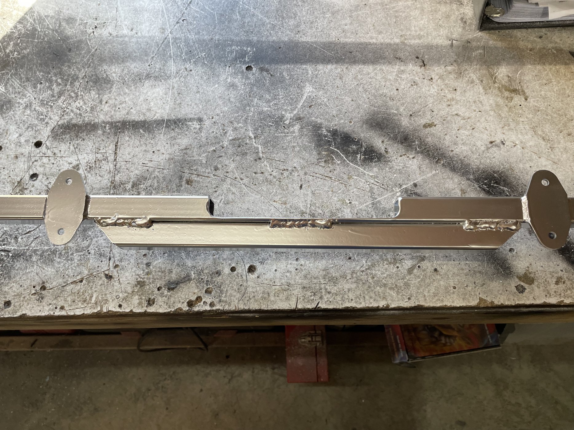

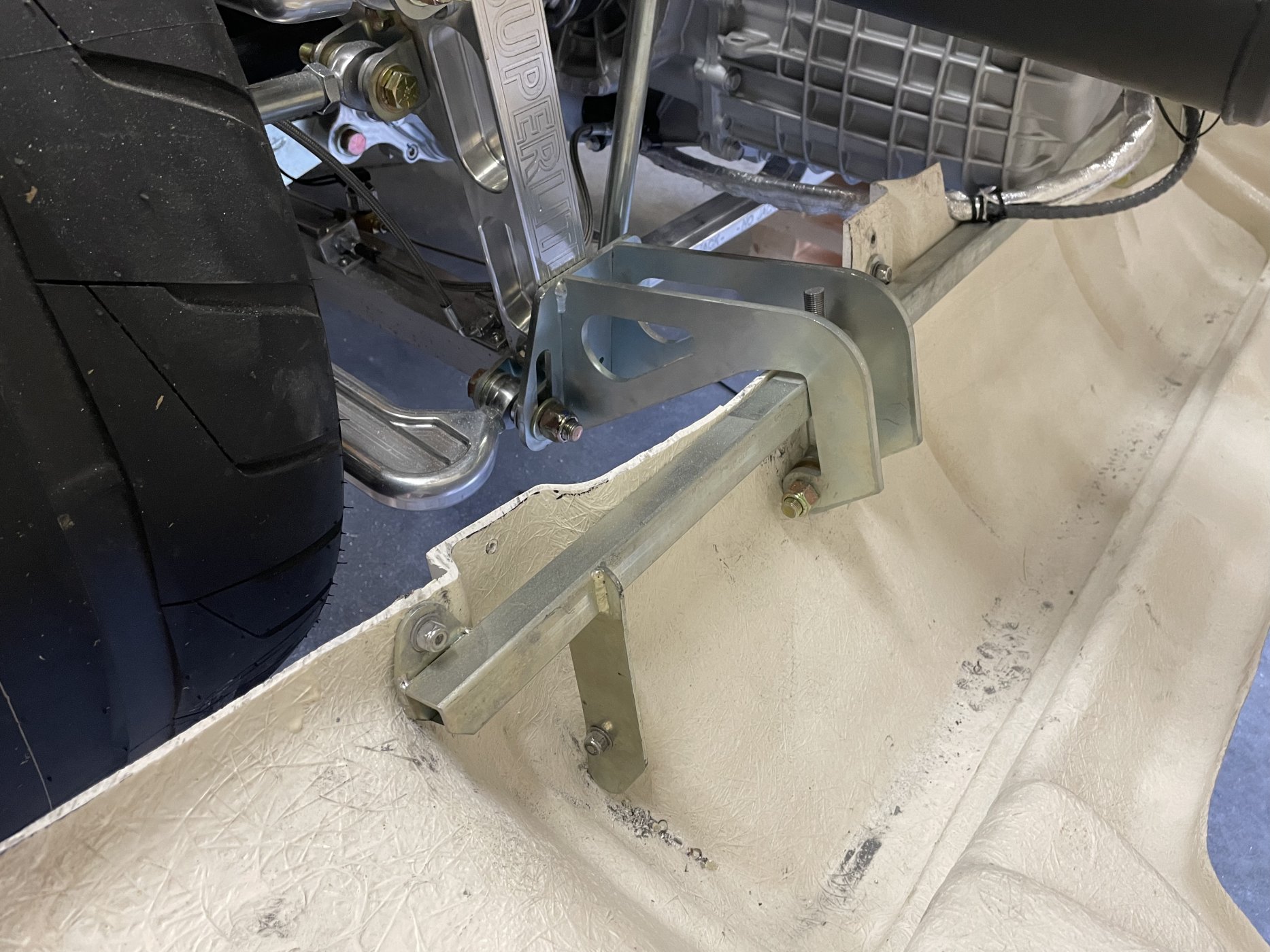

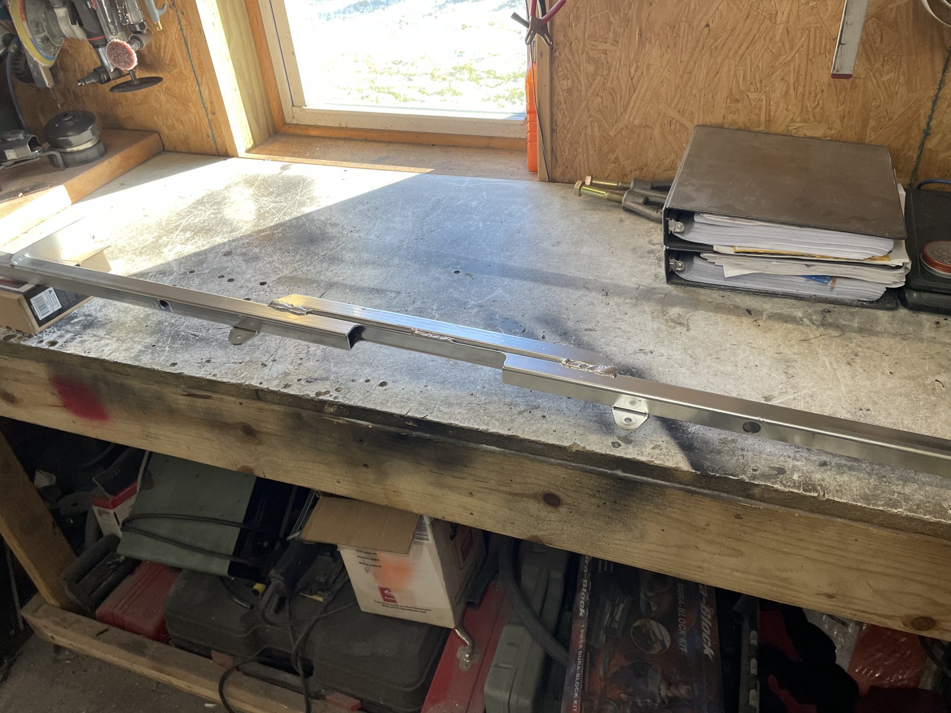

I also modified my rear clam hinge crossbrace to clear the lower side of my transaxle. After welding an additional 1 x 1 box iron bar onto it I had a good chance to use my new mill in clearing out the brace.
The paint is temporary as I will be undercoating the underside of the clam and this bar as well.

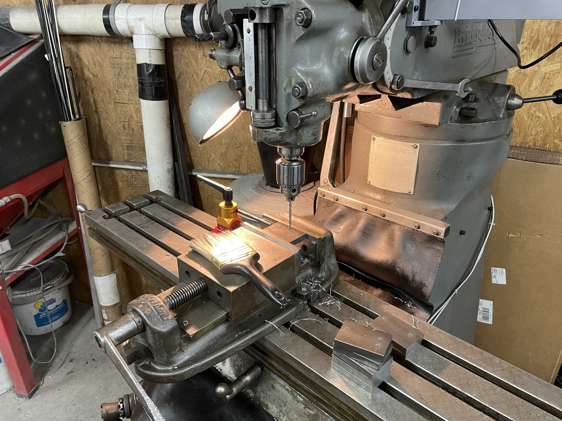

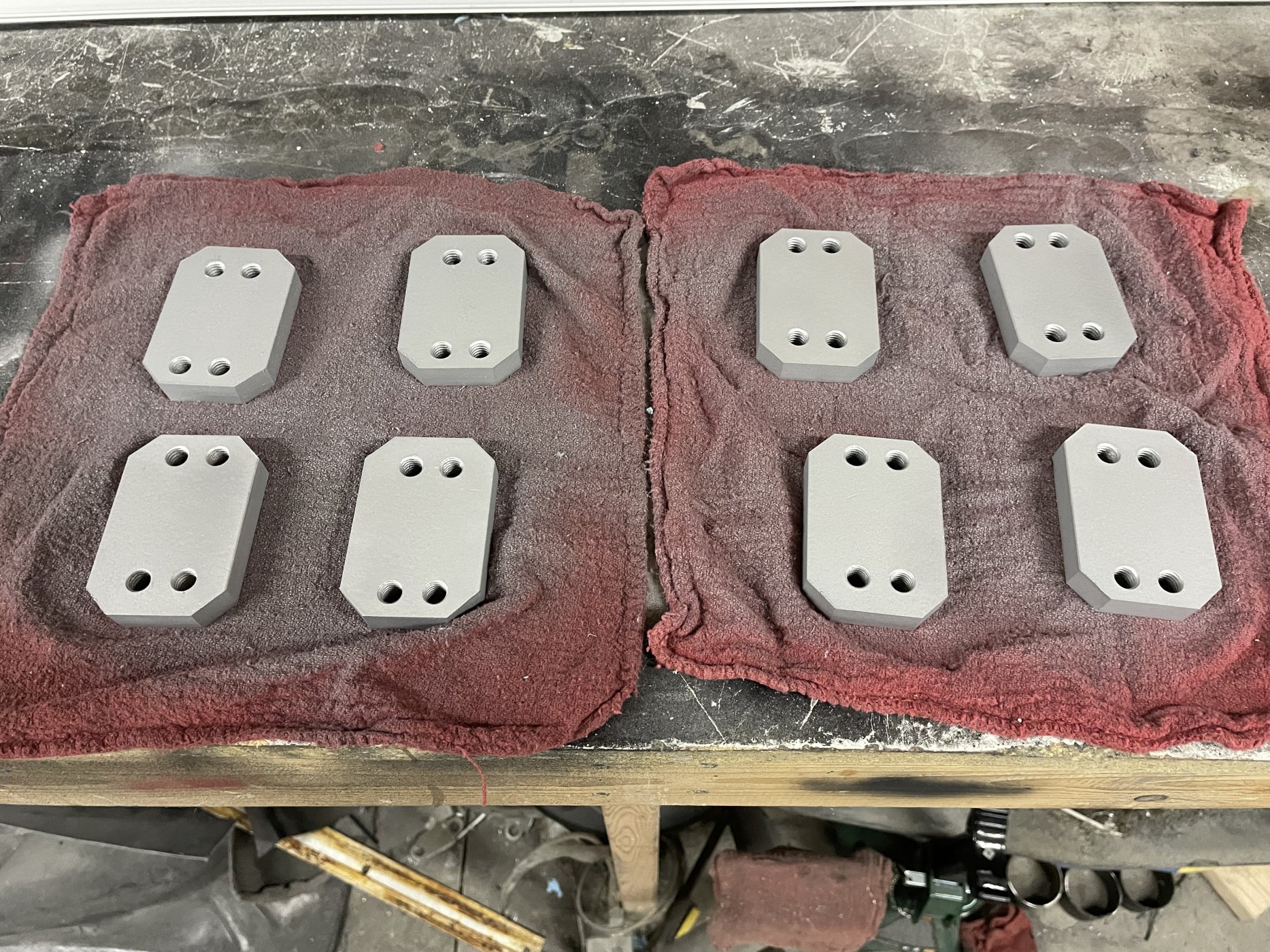

I also finished up my rear suspension relocation brackets in my mill. I do not know how I ever got along without having this tool in my shop. Now I need to resist the urge to come up with 100 new reasons to use it.......

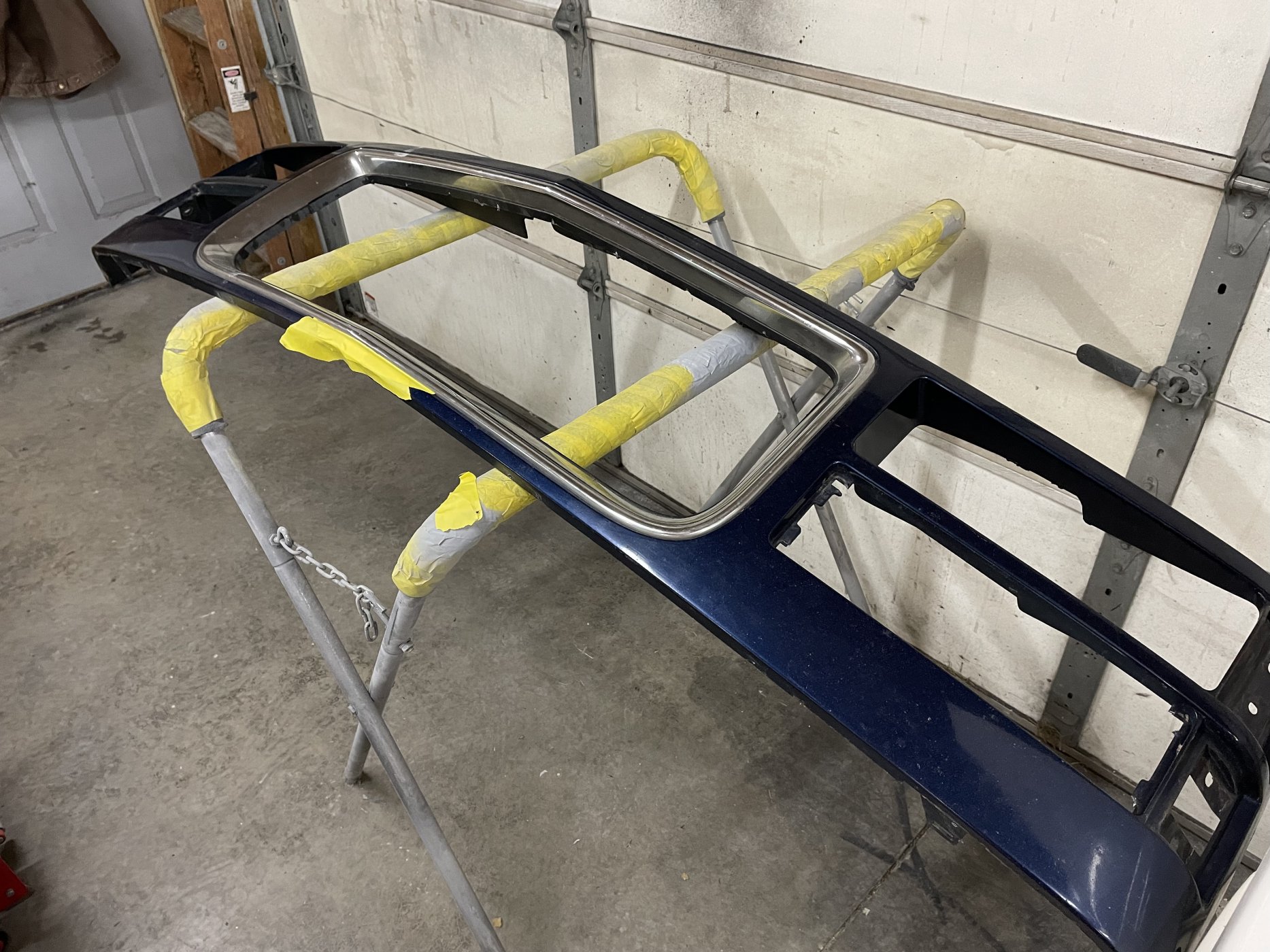

Side tracked on another project again. Sometimes I hate being handy, I get asked to help with so many things outside of my own. I am painting grill surround off of my nephews truck (Santa brought him a fancier front end) that my brother is building into a stereo cabinet to hang on his living room wall. Will probably be painting the entire truck this summer. The nephew will be doing most of the prep work on that project. Time for me to supervise.

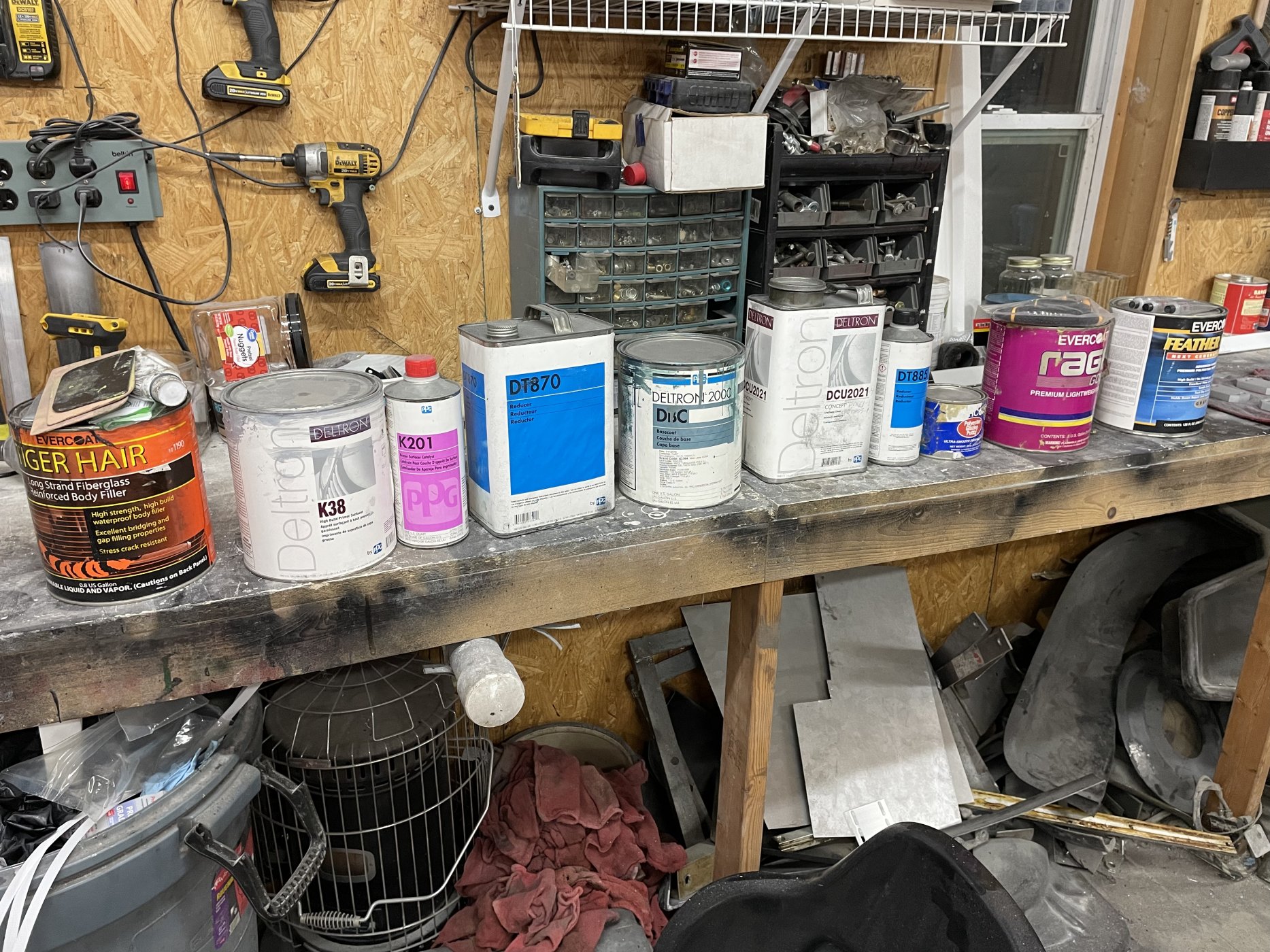

Gathered up some left over supplies and paint I have lying around for the project. This photo is a good representation of why paint jobs cost so much. This is all the product I need just to do a simple squirt of PPG reef turquoise on the grill surround.
(WOW, this picture really shows just how much of a huge mess my shop is!! Embarrassing, trash is full, dirty rag pile, steel scraps tossed all around)
body filler-fiberglass filled with hardener
primer/sealer with reducer
paint with reducer
clear coat with reducer and hardener
spot putty with hardener
standard body filler with hardener
polyester primer for block sanding
not shown is all the sandpaper used from 120 grit thru 400 or 600 grit (depends on when I get tired of sanding)
if you are not a perfectionist you can get away with a little less materials.

Happy New Year Kurt. Glad to see you are back on the build. Man, that Mill is heavy duty, very nice purchase.
Seriously, I have mill envy. No way I could have gotten a full sized one into my shop.

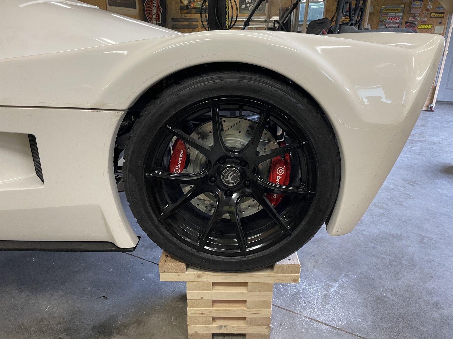

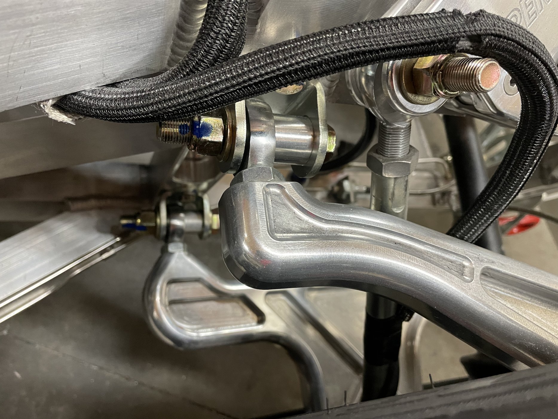

The only reasons I can think as to why my rear wheels are not centered is two fold:
1) I am keeping my controls arms centered as much as possible on there mounts. My rod ends are extended equally on each side.
2) I set my clam as far forward as possible to line the wheel wells up with the front wheels and that is where my tub fit best with the dash, windshield, etc. all fit in.
I will hopefully get an update posted in the next few weeks once I finish mounting the adapters on my rear suspension and get the rear clam re-installed. As with many projects, the adapters turned into more work than anticipated. I had to completely remove my exhaust to acces the bolts.

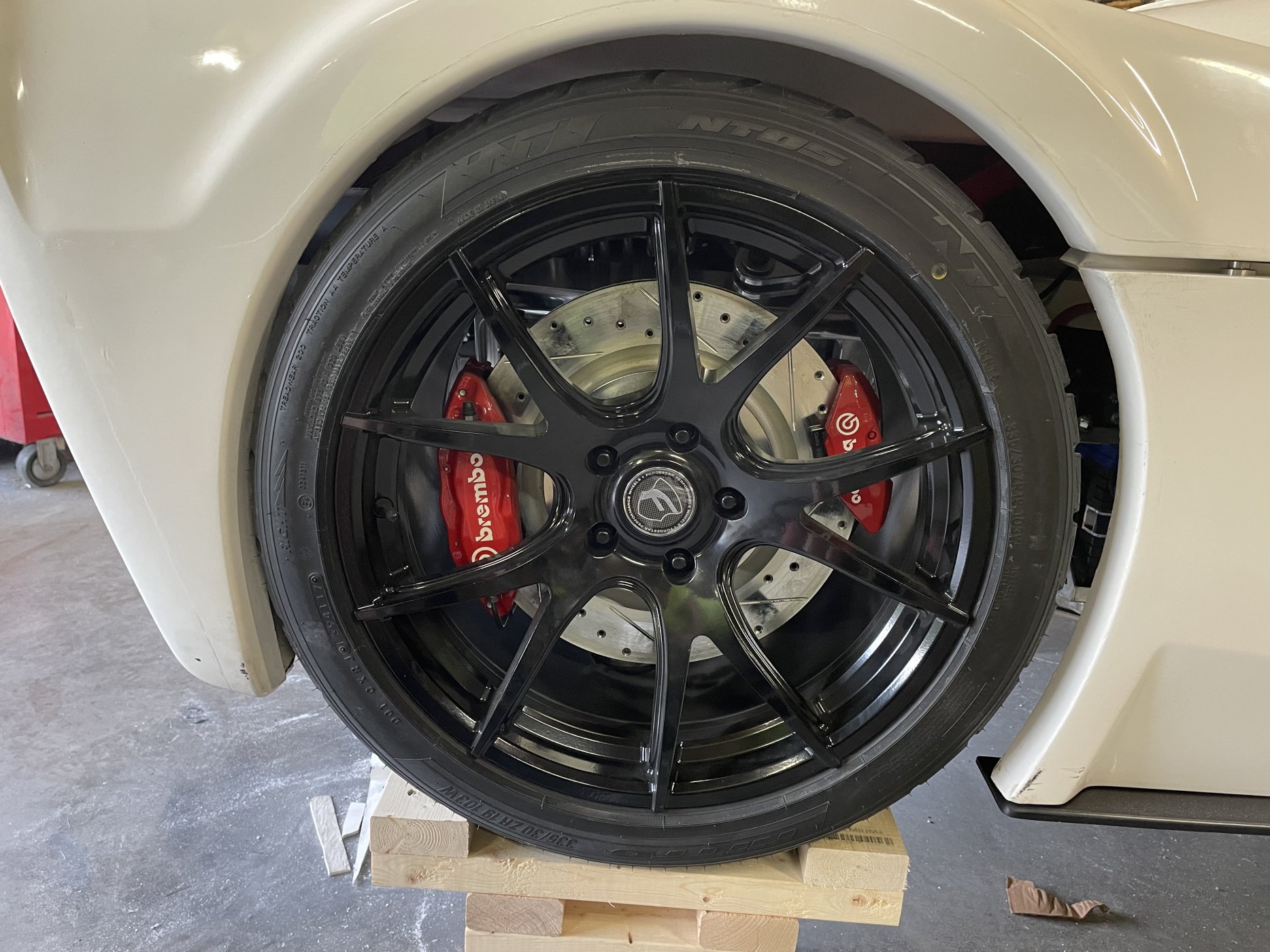

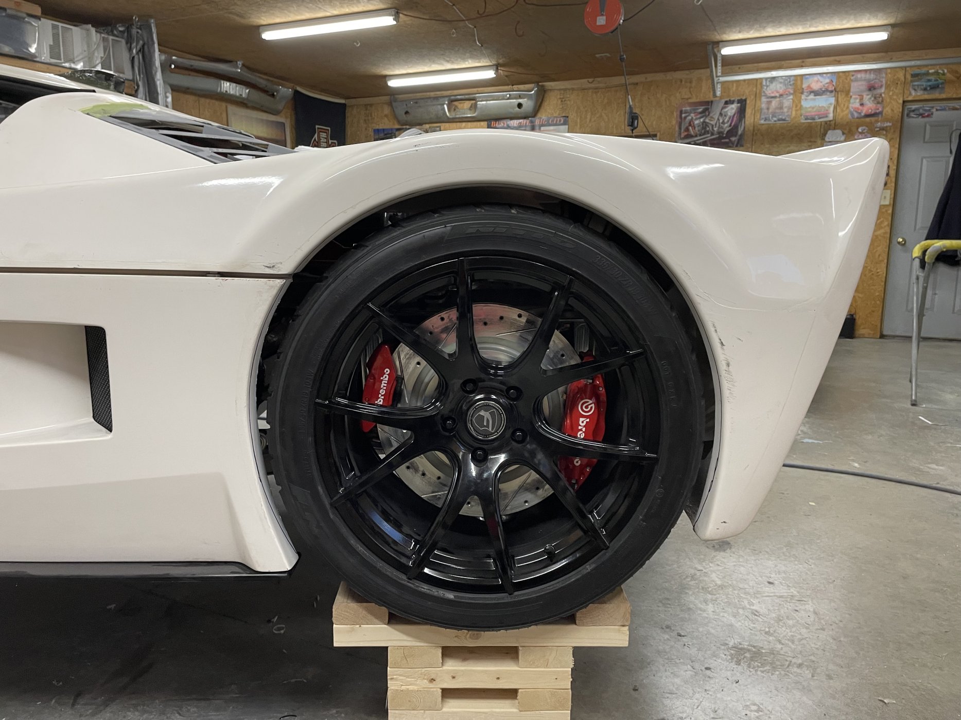

Quick updates on progress:
1) rear wheel alignment in the wheel wells has been addressed via plan "B" The adapters I made moved the wheels to far outboard and they were going to interfere with the bodywork during extreme suspension travel. Plan "B" was to install spacers in place of all the washers on the control arm pivot points to move everything 1/2" forward.

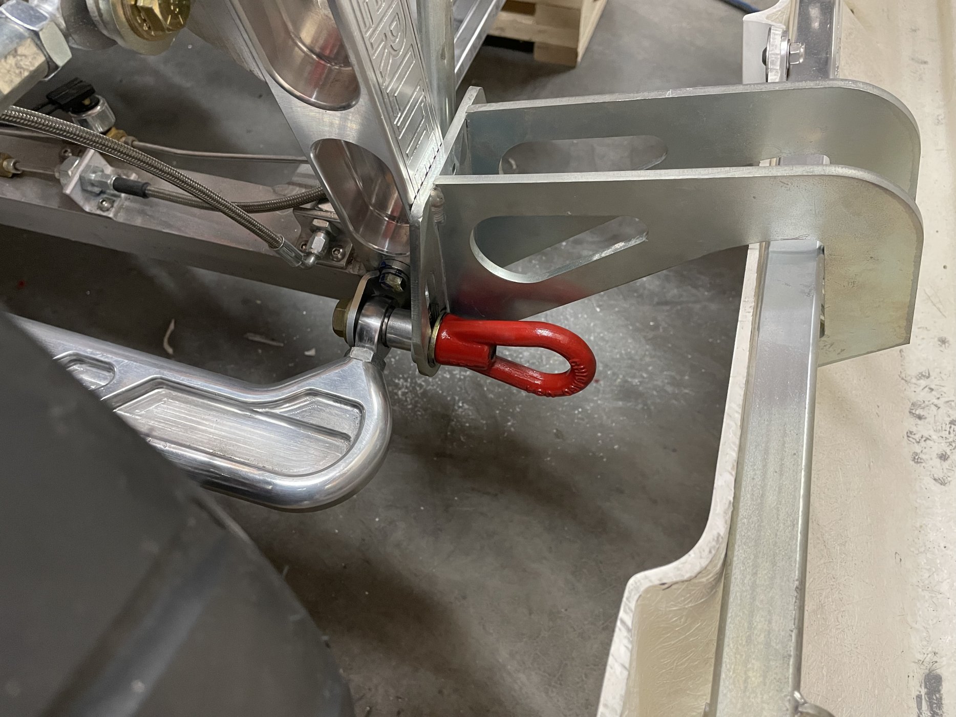

Also installed my rear tow hooks. Hopefully these will never be utilized!!
Now I just need to trim out the wheel well opening front and rear for maximum tire clearance.

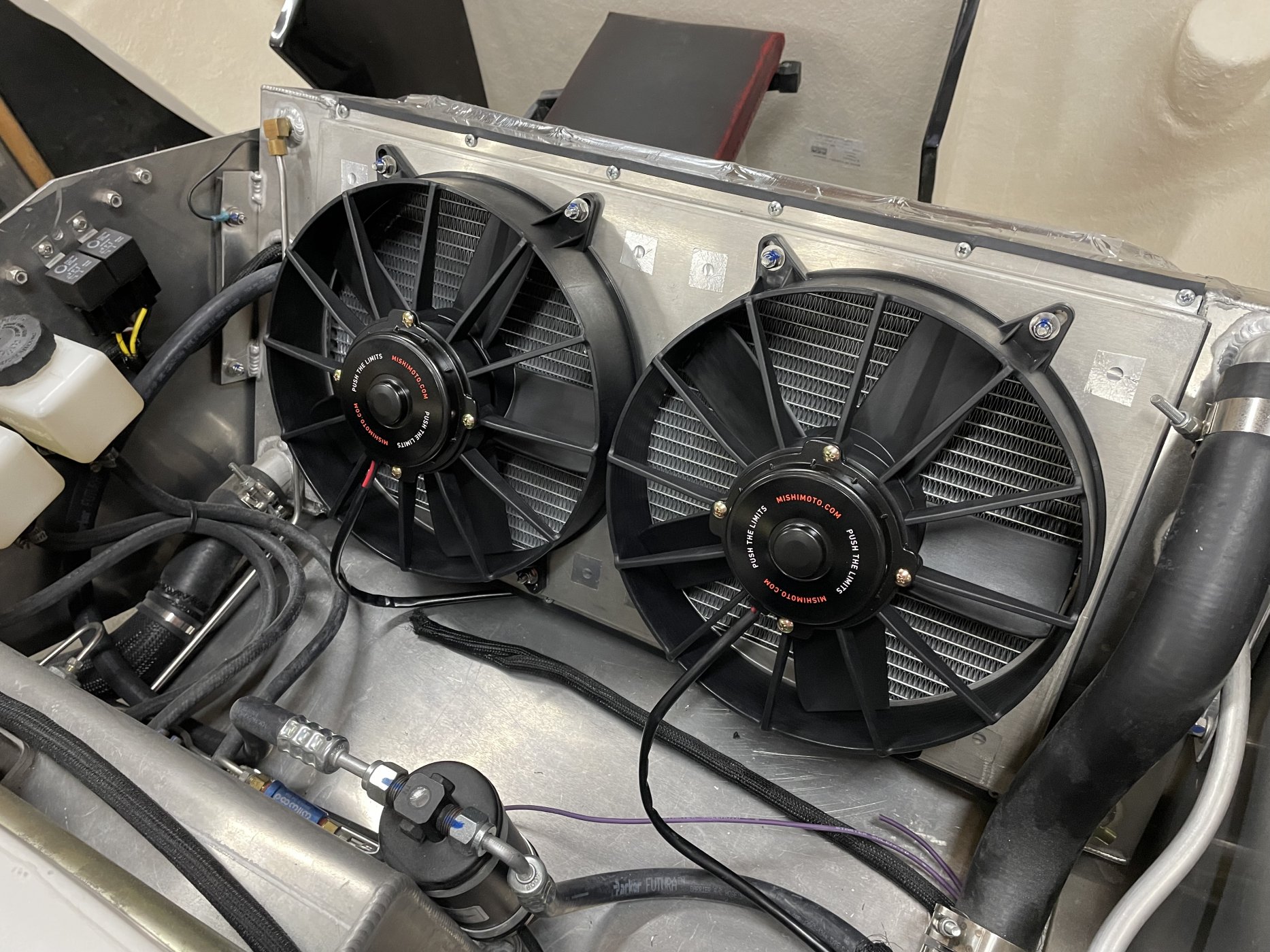

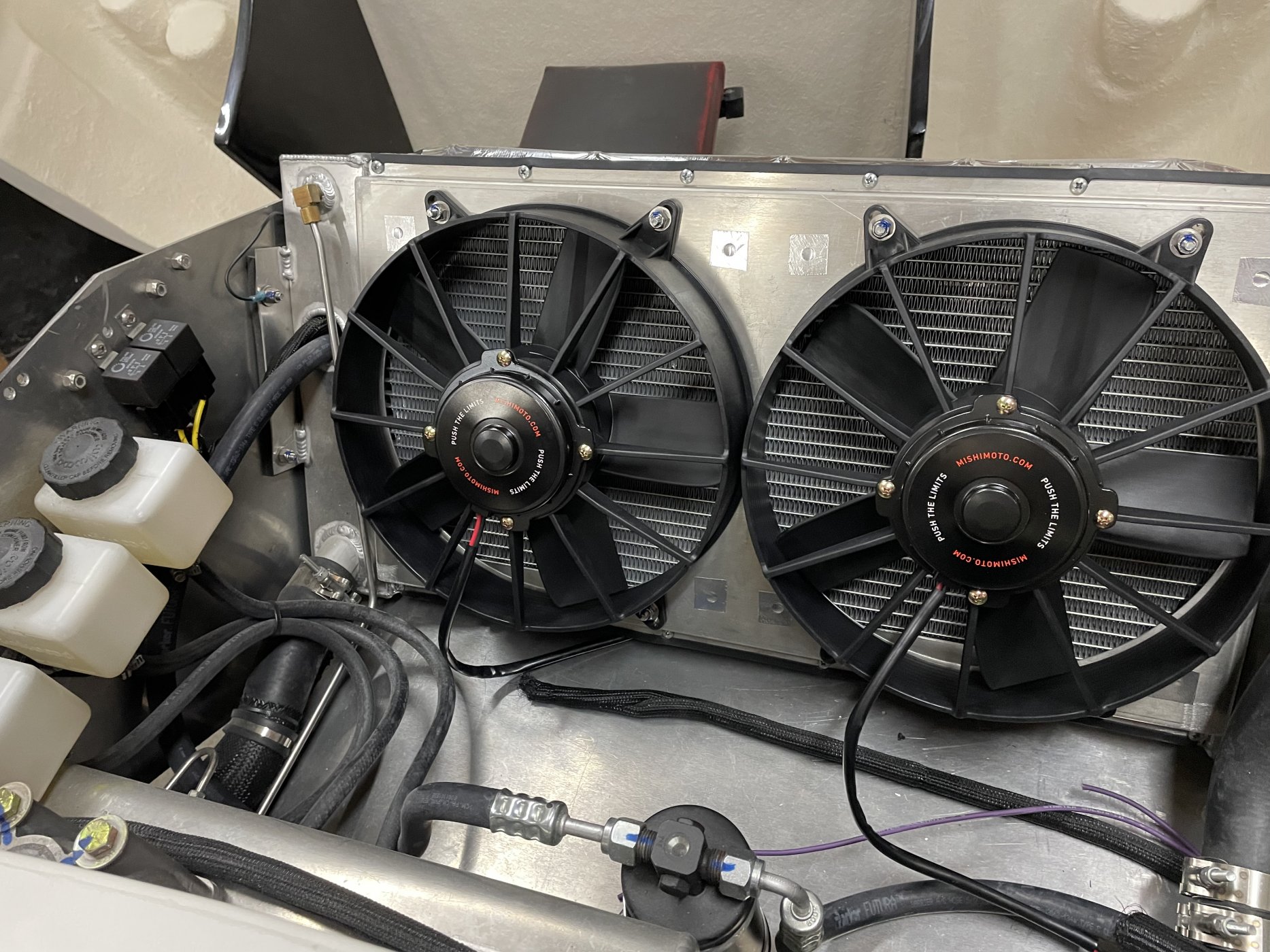

2) I also installed and tested my new Mishimoto MMFAN-HD11 fans and compared them to the stock fans. In addition to the fans I purchased an anemometer to measure the airflow of the old versus the new. My results were are as follows:
Stock fans---1500 cfm stand alone, 900 cfm mounted to radiator fan shroud
Mishimoto---2000 cfm stand alone, 1,800 cfm mounted to radiator fan shroud
The stand alone numbers for both are basically what they are rated at. The big difference that jumps out at me is the mounted numbers. The Mishimoto do not see nearly the drop off that the stock fans due. I believe this is due to motor sizing. You can audibly tell that the stock fans are not spinning as fast mounted as they do stand alone whereas the Mishimoto fans appear to spin the same RPM in either condition (no audible change, wish I had a tachometer to verify).
As others have noted, they are very loud!! I can accept that for a 100% increase in airflow across my radiator!

Very nice work, Kurt! I'm very curious on your rear tow eyes -- did you buy those or fab them? I was going to fab tow brackets out of 1/4" steel, but your solution is much cleaner. Nice for tie-downs while trailering too, not just towing.
Mark,
I purchased my rear tow eyes from McMaster Carr. They are female threaded lifting eyes that I painted red. They are only available in course threads so I had to change out the pivot fasteners. And yes, tie down points for trailering are what I “plan” to use them for, hopefully nothing else.
