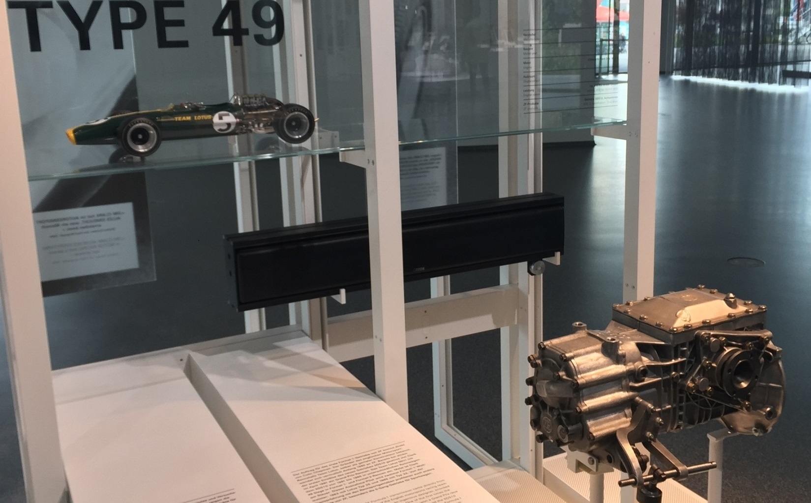

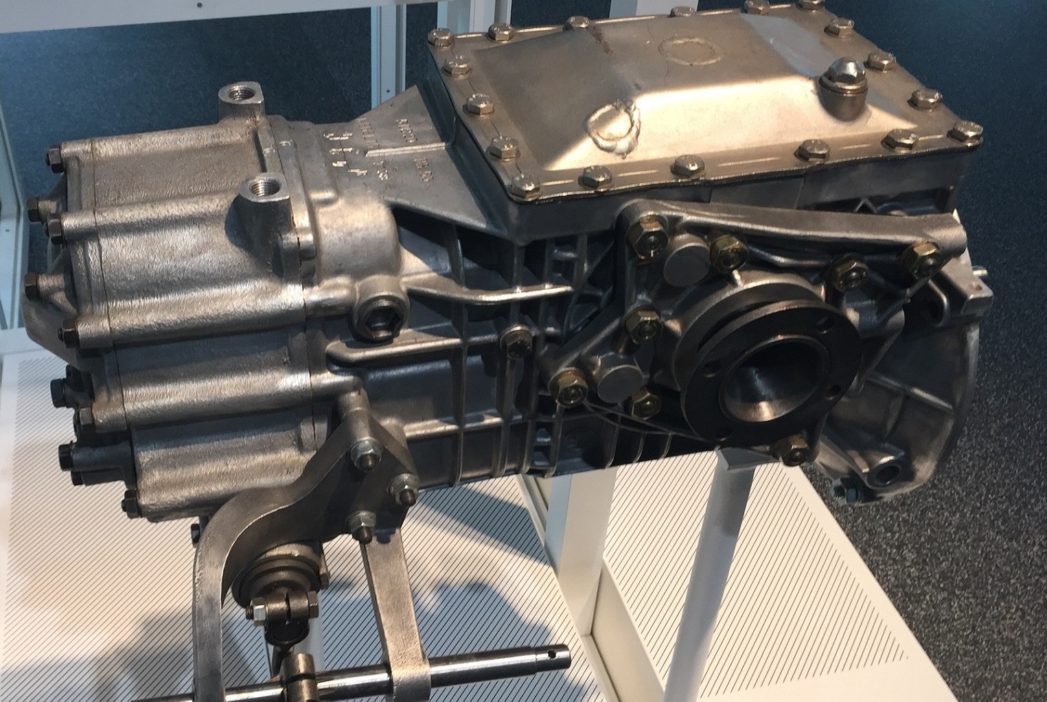

Hello Pim,
unfortunately my memory did not serve me correct....
I mixed up the different transaxle type's 4DS10 with 5DS10/12/20.

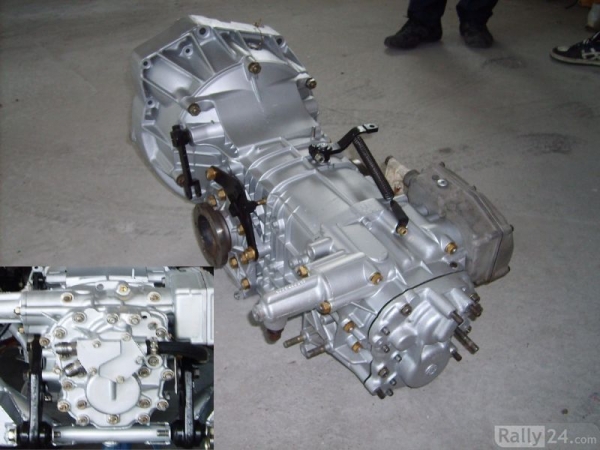

However, I post what I have (sorry for the odd shape of the pictures-resizing was for whatever reason tough):

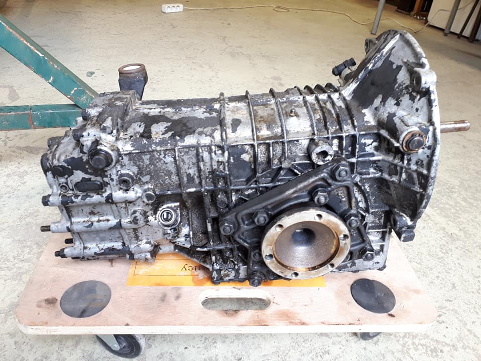

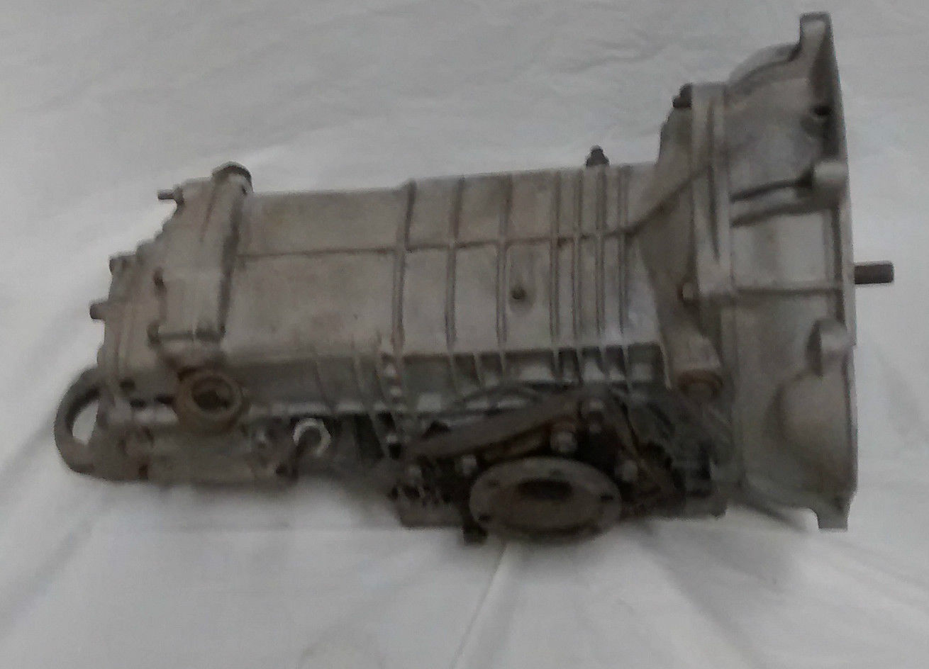

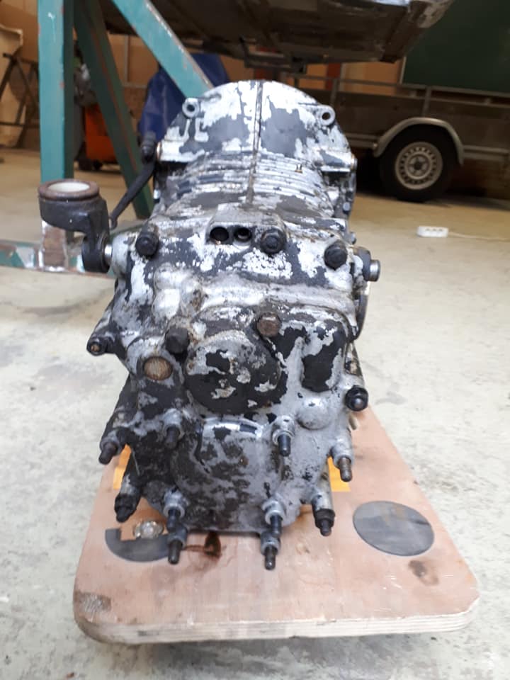

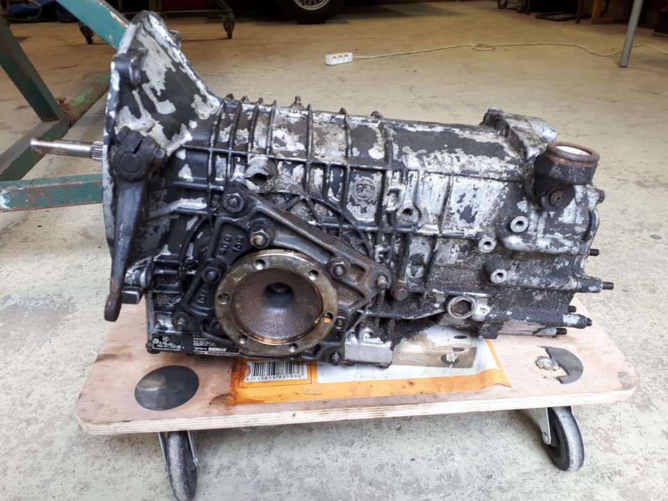

Could not resist and bought the box, now see whats inside.

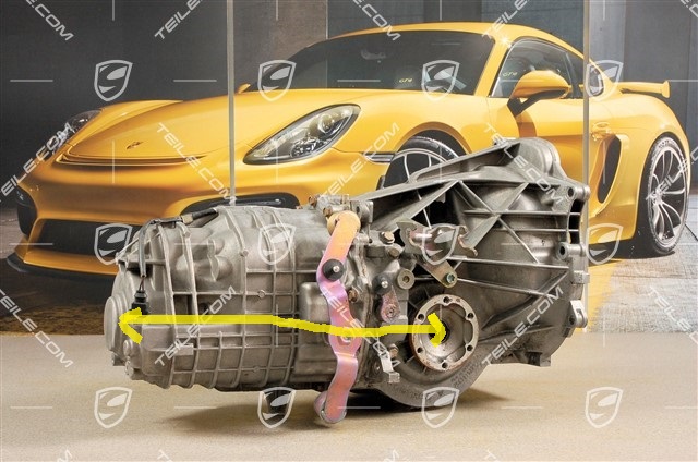

The main shaft is way too thin with this box so won't use it. Does anyone know the length of a Porsche Boxter 6 speed, measured from the center drive shaft tp the rear?
