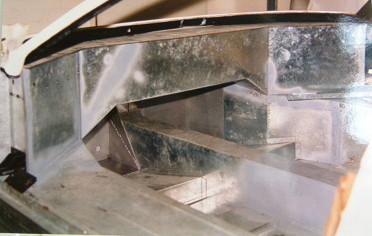

Thought I'd show a photo of my monocoque. Sorry about the poor picture quality it's a digital photo from my original analogue photo. Commercial digital cameras were only a twinkle in the eye of ant consumer electronics manufacturer when I started this project.
