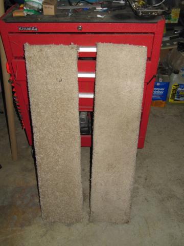

When I need the car on jack stands I use two 2"x8"s 35" long and covered in carpet with my jack stands. This helps preserve the bottom of the car. The rear one goes under the rear cross member and the front one just in back of the front tires where it is wide enough for the full 35". I use a very old bumper jack to lift the car, works great but not easy to store.
Looks like I'll have to fix my old floor jack and build something like Ron or BCG put together, great idea.
