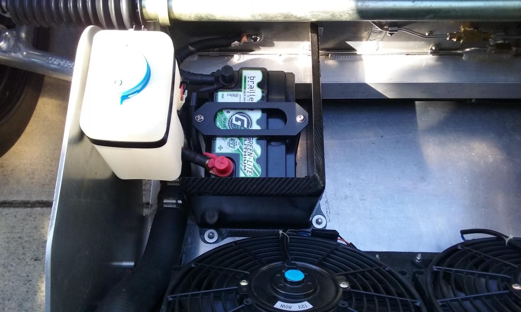

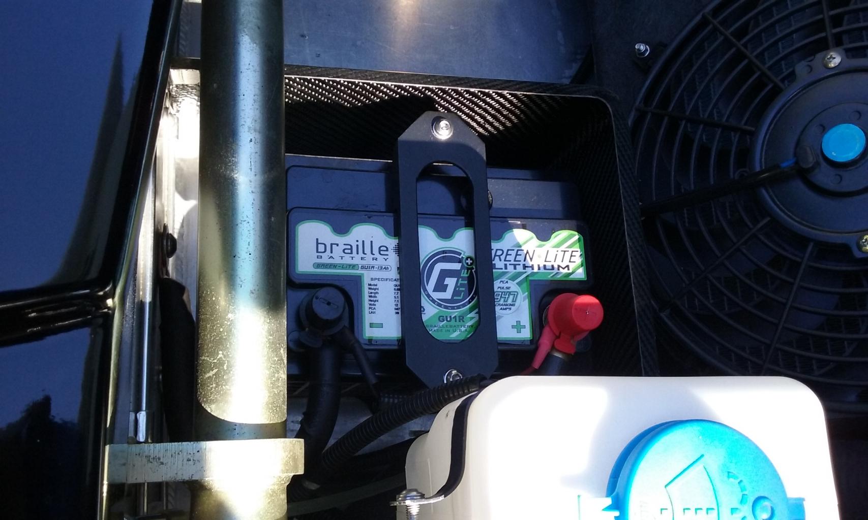

Jim I have a Braille Lithium GU1R in my SLC. Cranks an LS7, Bosch starter on Grazziano Trans. I have an Ultima GTR with Braille Lightweigh AGM cranks 6.3 Ltr Chevy race engine, Hi-Tork starter on Porsche Trans.
Lithium batteries, (only buy quality you do not want to be Samsung), are expensive but have a considerably longer life than lead.

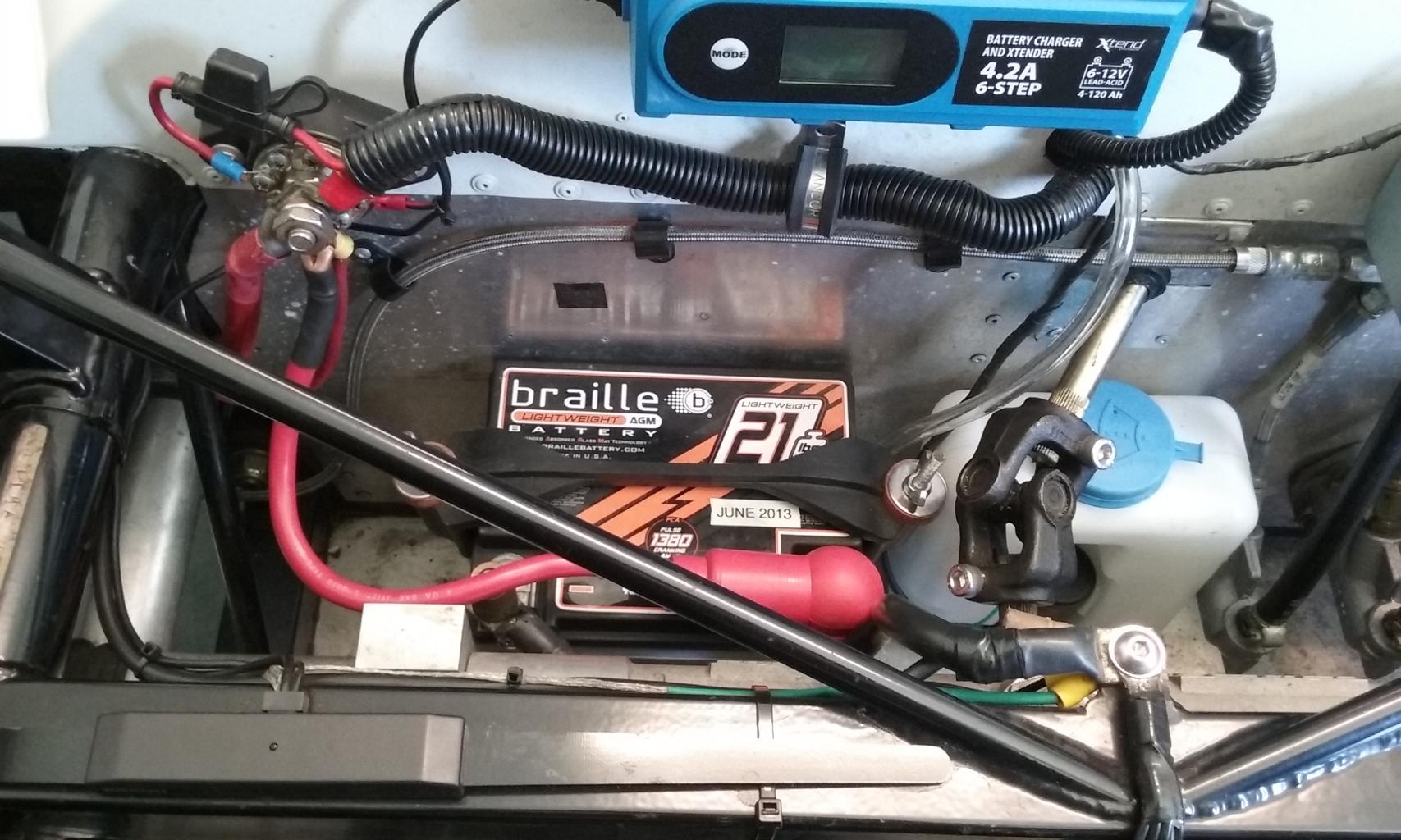

Timely thread for me. I just had multiple conversations with battery makers at SEMA including Anti Gravity and Braille. I started my build with the Braille AGM 21, but it is on the limit of what it can handle and drops below minimum power too fast on my setup after a few cranks.
Nice to hear that the GU1R is doing the job as that is the one I will probably upgrade to, plus its only slightly larger than the Braille AGM which means it will fit in the only space I have to put it. I think its 500-600 dollars, not cheap, but if that's what it takes not to be stranded somewhere - it is worth it to me.
The Braille rep said the L is twice as strong as the AGM although the specs don't really say that, since you have both batteries what is your take on cranking power and reserve power between the two?
Both batteries do a great job in taxing applications. The Lithium is a noticeably stronger crank. Although the lithium costs over twice as much as the AGM it will last over twice as long. It is also a third, yes a third, lighter than the AGM. Long term Lithium is the best buy and a great weight save.

The GU1R is actually 1/3rd the weight of the AGM 21.
6 lbs vs. 21 lbs
