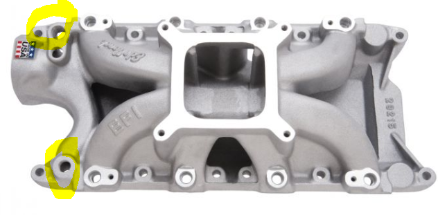

You could consider drilling and tapping one on the water channel on the other half of the block, as on this edelbrock manifold?
for EFI, water temperature is crucial for correct warmup compensation and cold starts.. so you'd prefer to sacrifice on the water temp gauge if you have to find creative solutions.
