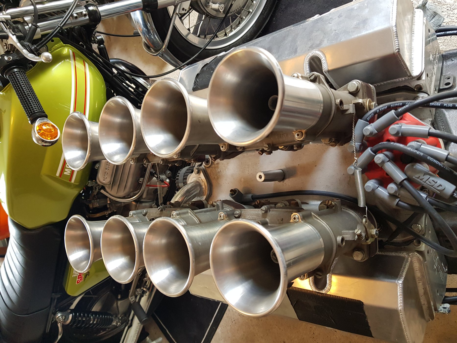

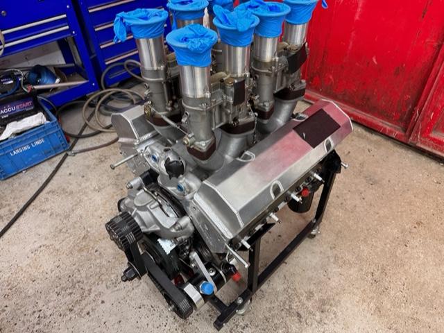

Here's the engine:
@marcus - Tremendous job on difficult tasks, as many have here noted. I read that you have a Hewland box because you wish to insure FIA compliance. My Lola replica has an upgraded Getrag 5 speed box, originally fitted to various Audi performance sedans. My car already has an HSR logbook, but would it require a Hewland tranny for FIA approval? Thanks!
FIA must be adhering to higher standards. The heyday of Lola and Hewland were coincident, and all the early Lolas of which I am aware were Hewland equipped. If you have the dogbox Hewland, that's a great tranny - strong with incredibly quick shifts. I also own an Alfa 4C with DDCT, and the Hewland dogbox is similar regarding speed of shift. HSR vintage events will have to be enough for me, as swapping out my Getrag transaxle for a different manufacturer would be roughly equivalent to a lung transplant. Thanks so much for checking, and continued good fortune with your build.
Superb-looking engine. The vertical intakes are so Can-Am! The 383 Chevy stroker in my car is a Can-Am build and has an authentic Moon manifold and 4 x 2 barrel Webers. Your system provides most of the look of mine with all the dependability and adjustability of FI. Your project is coming together excellently!

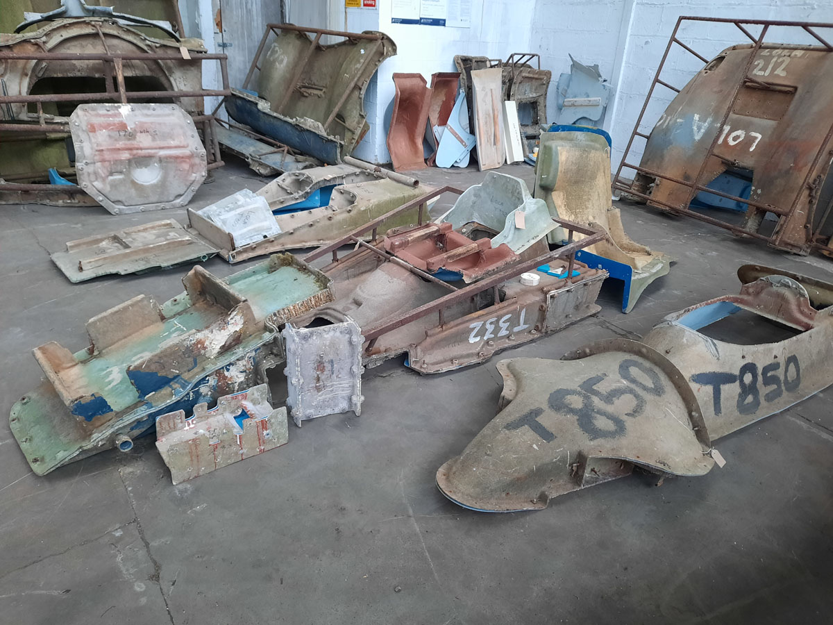

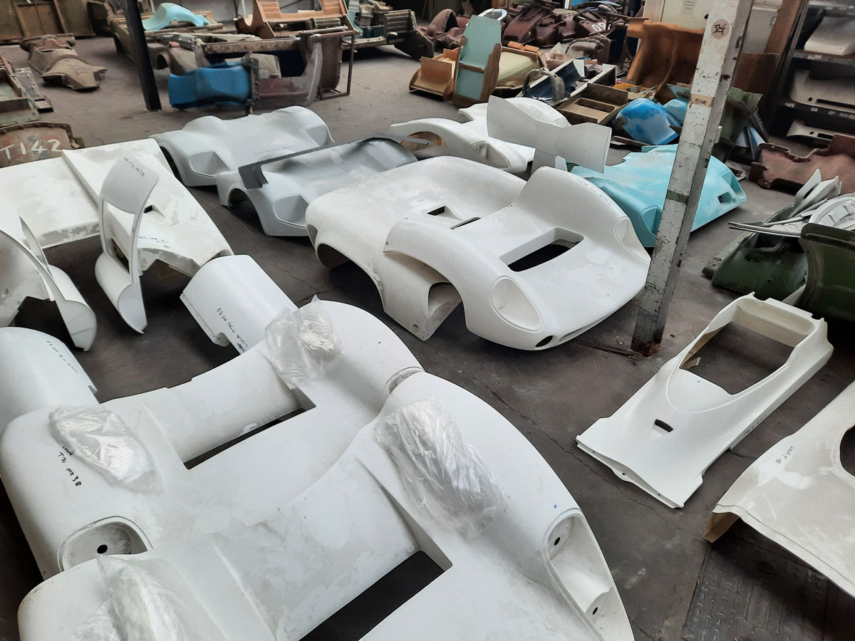

Hi macus hast du gewusst das tw mouldings pleite sind die ganzen formen werden am 7 februar versteigert

Ja, wusste ich, danke Dir Meinolf.
Das Interesse an der Versteigerung ist wohl sehr groß, bin froh dass ich meine Karosserie komplett habe.

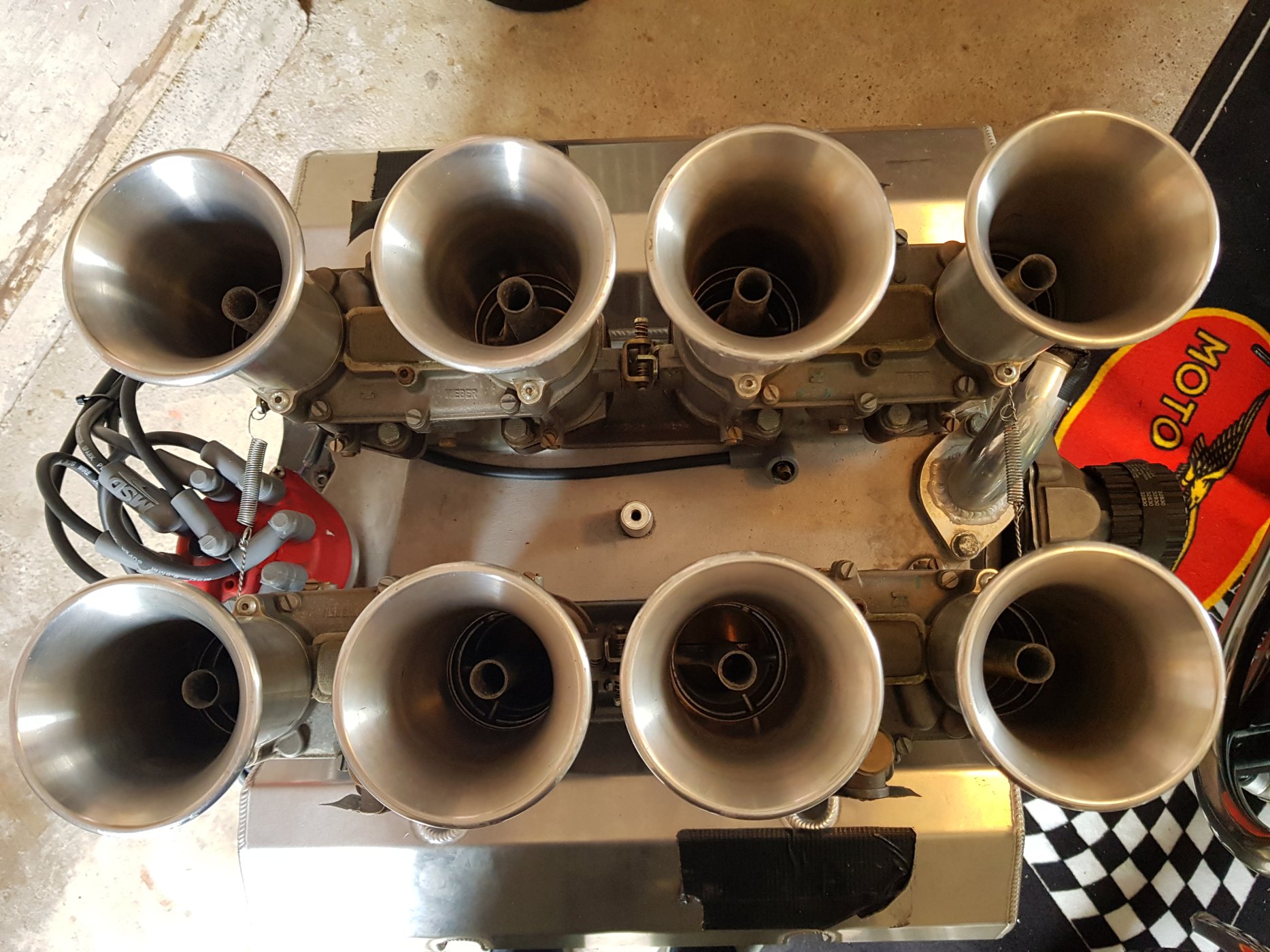

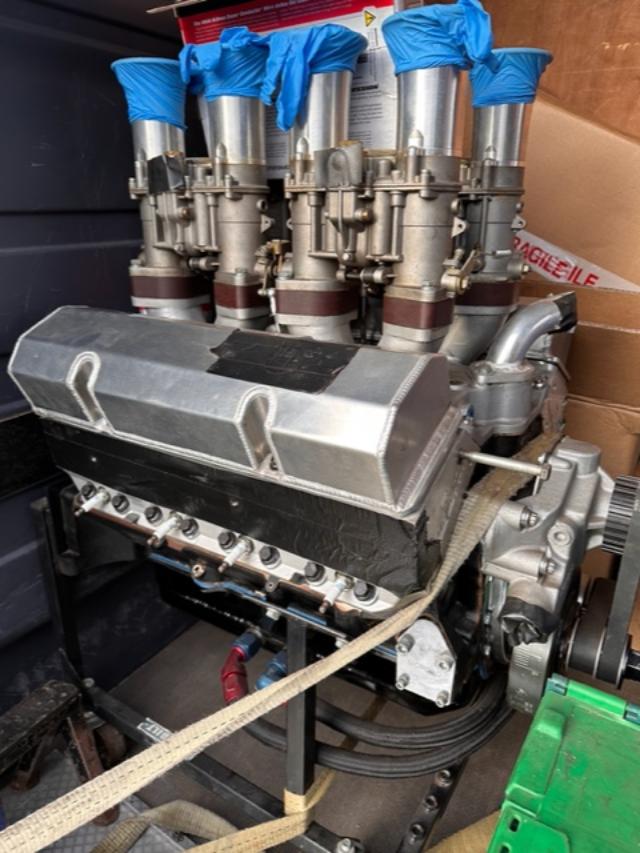

Any details on your engine Marcus? Looks like you went with carbs instead of mechanical fuel injection? Are you going to stick to 5.0L to comply to the 1969 rules?
Very envious of your Hewland box. One of the few regrets on my car is not springing for one, but it's no small investment.
Brian, I'll stick with the Webers, it's a period correct 5.0 SBC and my Kinsler system is for a BBC so that has to go.
If anyone is interested in it just let me know.
As for the box, yes I had to pour down a Scotch or two when payment was due
