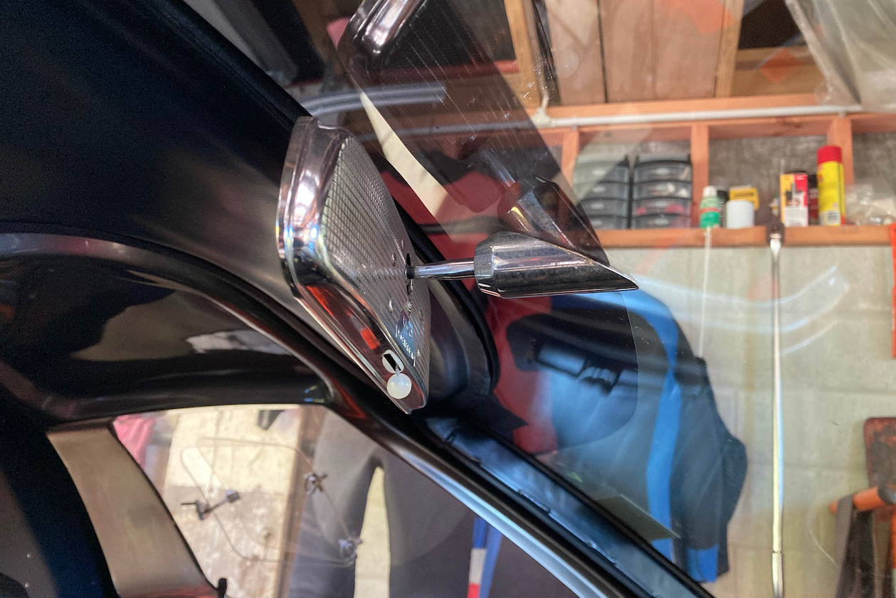

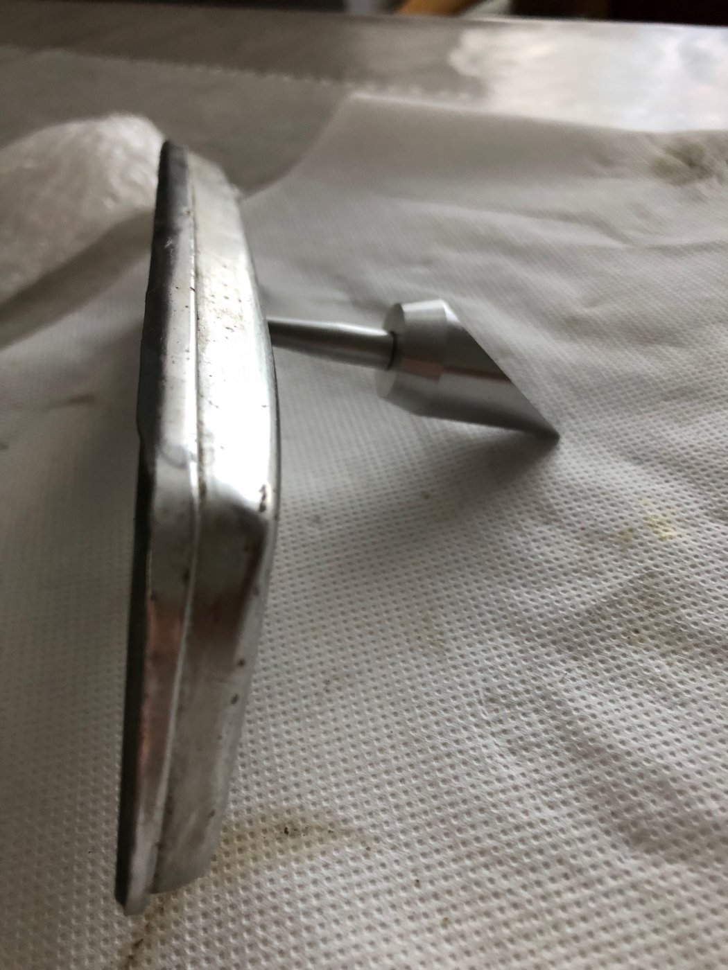

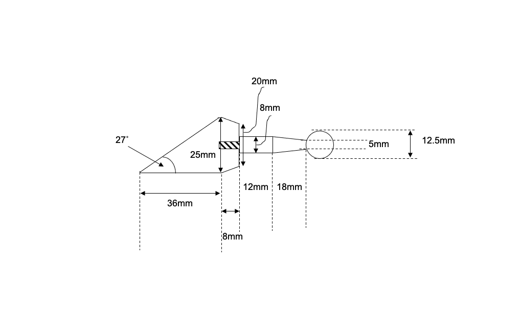

I just got a local machine shop to turn one up for me. Didn't cost a huge amount.

Hi Brian,
that's really for me the best Christmas present I could get....that design falls just at the right moment for me,
i will have my local machine shop making one of these...
Many thx
