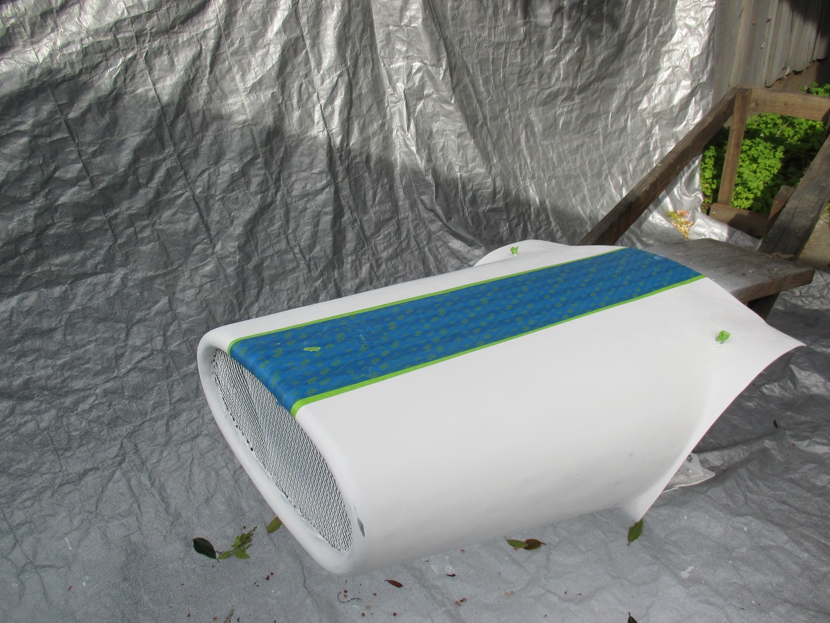

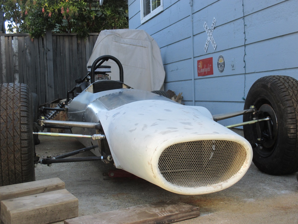

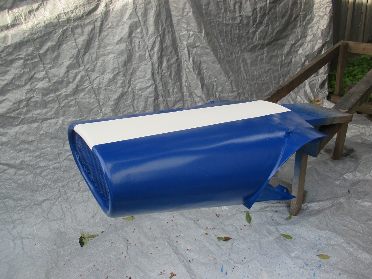

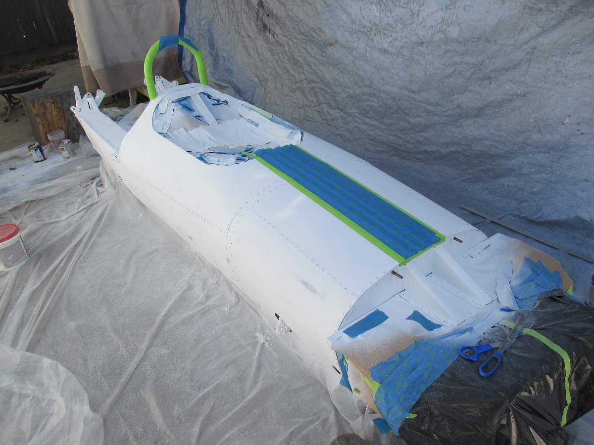

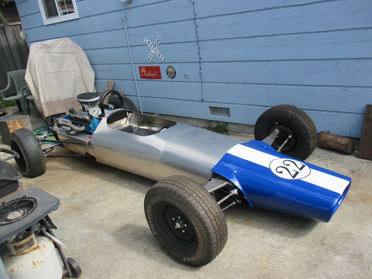

Work on the nose. Generally I should preface this by saying I don't have the patience or perfectionism to do paint/cosmetic work. But not having much money either means I do it anyway. This actually came out smother than it looks in the pictures which was kind of a nice surprise though its still clearly a product of my non professional work. What I did here was cover it in light filler, sand, repeat, spray an epoxy sealer, sand, touch up, sand. Then mask off where the stripe would be,base coat, pull the masking tape off and then clear coat. But even with my slightly shoddy work, seeing it on the car just about floored me.

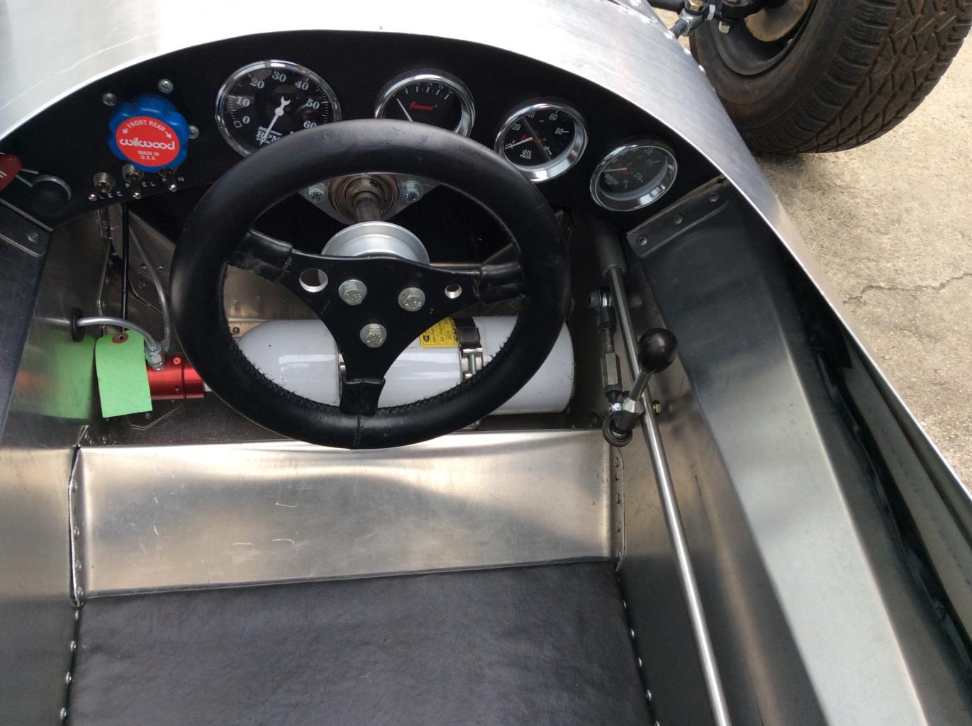

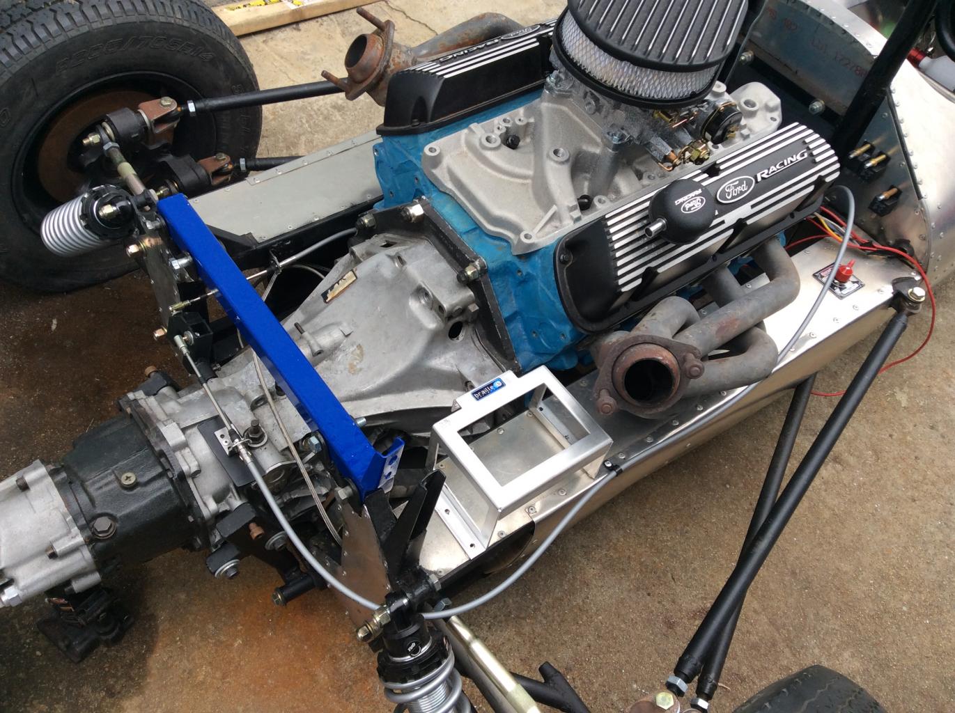

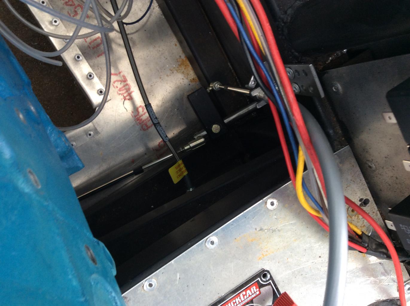

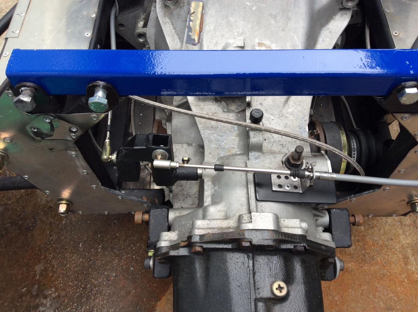

The main thing I've been working on lately is the shifter. Since I switched my plan from the renault transaxle to the Audi, I was left with a shifting rod that went to the wrong side of the engine (and down low). Years back, I fabricated a cable shifter for a Lotus Europa I used to won, so I decided to go that route again and create a sort of hybrid system that used the rod to get to the engine compartment and then the cables to get to the transaxle and have it make the pattern be in the right direction. I need to move the attaching points on the back out another 1/4" to be perfectly lined up, but it works as it is here.

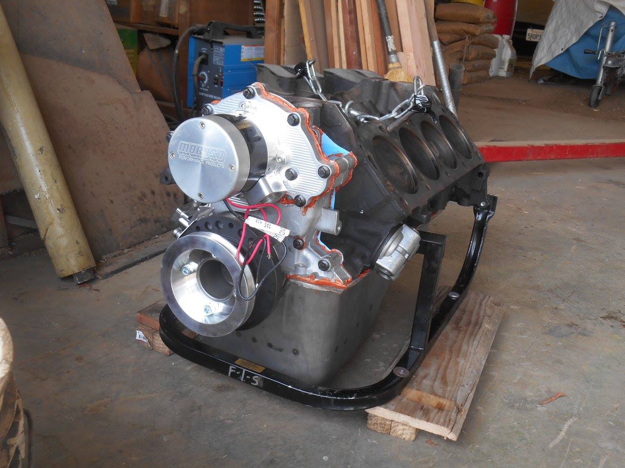

I also started assembling my engine. Another racer here in the SFR SCCA region gave me the 5.0 short block that he was running in his Cobra replica as he was moving up to a stroker. So I'm going to put aluminum heads on it and what not, but this weekend I put on the pan (I can't figure out why I didn't paint the pan first... I meant to, but there it is not painted) timing gears/chain, cover, damper, and an electric water pump. Because the car is for autocross use I want to be able to run the fan and pump while the engine is off as the car sits at an event more than it runs. This is what a lot of the formula ford guys who run autocross do to cool down the car between runs.
Oh and I hate oil leaks so I tend to wipe excess sealent to the outer edge of a gasket and then smear it back over the outer edge once the part is installed (keeping excess away from the inside). But I usually use black stuff which looks fine. This looks terrible in orange. Thankfully it'll be right up against the firewall. . ..

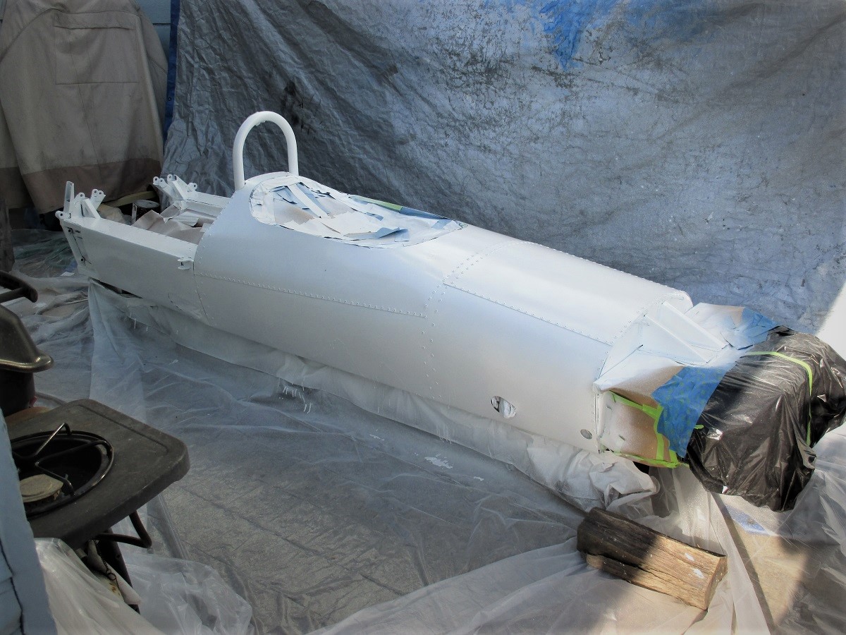

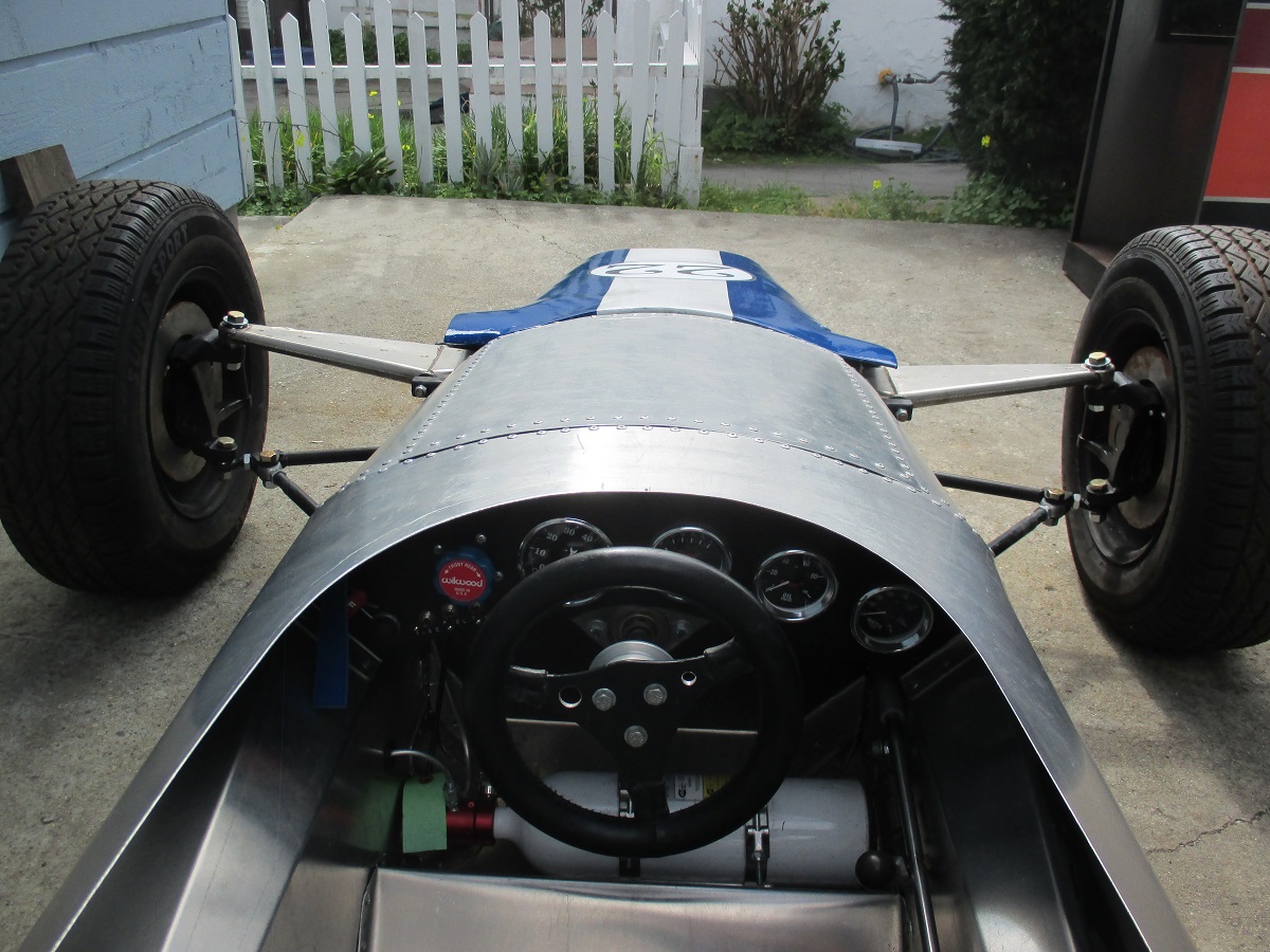

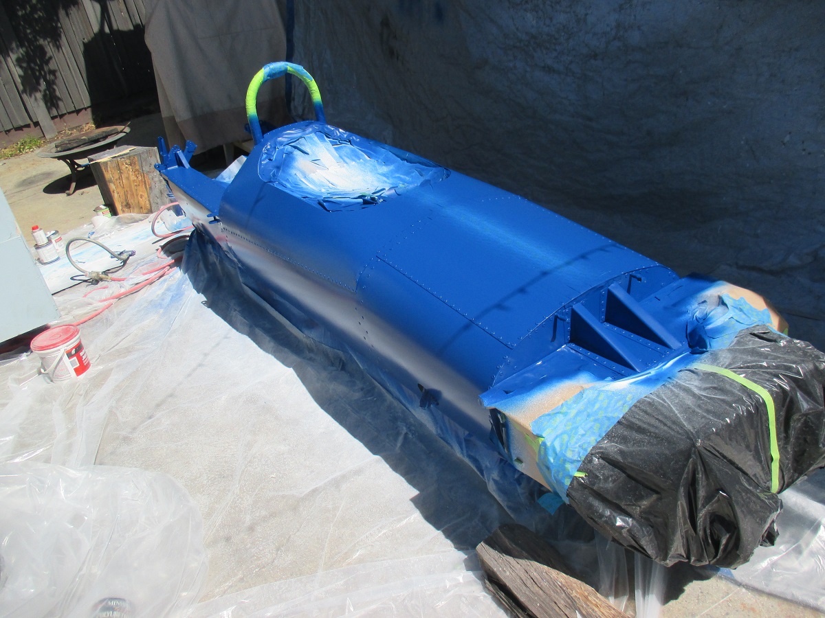

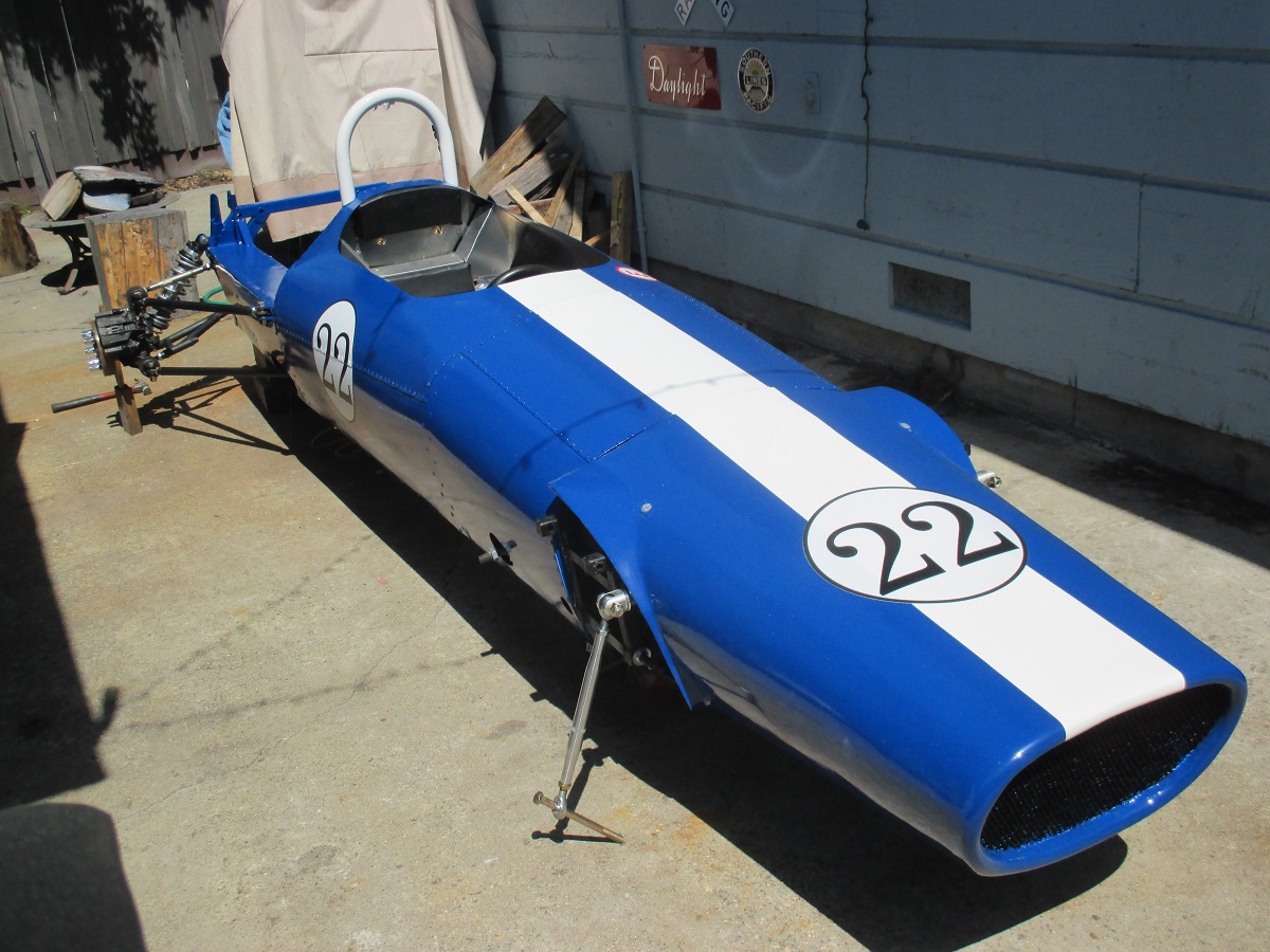

More paint work. It looks better in the pictures than it does in real life . . . the clear coat didn't come out well. Its fine in some places, has orange peel in other places and a couple spots where it was on the verge of running. Some wet sanding and buffing could fix it. But right now I'm too tired to think about that. When I run out of other things to do I may return to touch up the paint. . . or cover it in stickers :)

Your top gear cable bracket you will bend that over time.
If you weld a 45 deg piece in the corners it will be light but strong.
Even if they are just fused in if you have a tig.
Doing a great job.
Jim
Really? You've had one bend? I had these same brackets on my Europa, drove it as my my daily driver and raced it for 6 years and didn't have one bend.
But from an engineering point, and "better safe than sorry," I see your point. I could cut some steel triangles pretty easily to weld in there.
