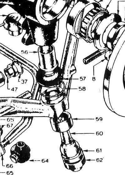

Looking for description of connection of lower front control arms to uprights on original GT40 MK11..Is it a ball joint of some kind?

Bob,
Thanks for the explosion.
Reason for my question: When cold (parked in garage or just taking off) I can steer w/o any noise but, after 10 miles or so I get a "creaking" from one of the lower control arm to upright joints (only when steering). I suspect it is lacking grease or needs tightning but, didn't want to dig into it w/o some idea as to what's there.
So...Do you have numbered parts description and can you advise as to correction for my problem?
Thanks in advance.
Steve
The similar looking Moog parts (C5 Corvette) I have for my car have a grease nipples in the bottom center of part 62. Maybe theres a hole there and no nipple fitted?
