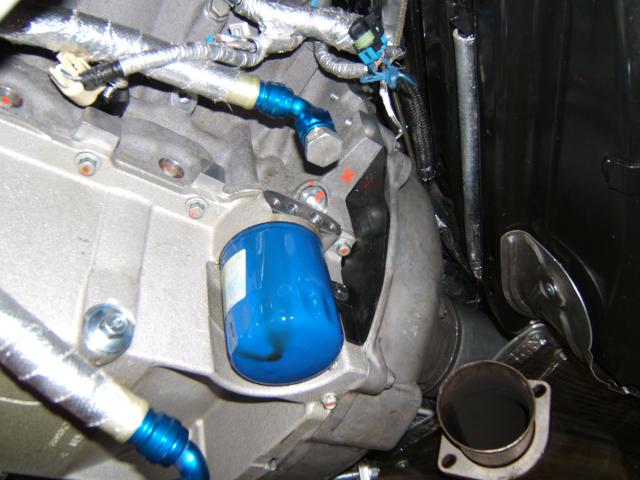

Still sorting my LS7 plumbing. I had been looking for a way to move the cooler to the left side of the motor, opposite the dry sump tank. In case anyone wonders, the LS7 has two bolts above the filter for just such a purpose, so don't go buying an adapter.
