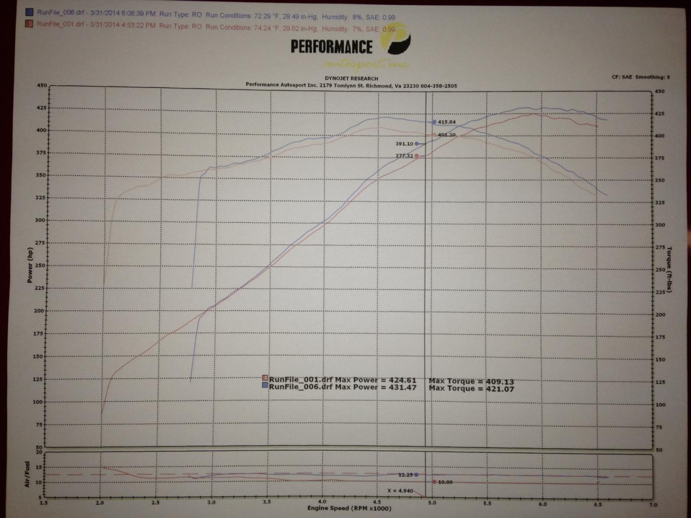

Here's my chassis dyno sheet. My goal wasn't to see how much HP the dyno operator could convince me I had, but to check AFR, spark/timing, fuel tables etc. and cleanup the GM crate motor spec'd tune/ECM.
Motor is the Crate LS376 (480HP), LS7 exhaust manifolds, straight air intake tube, no cats, to Hushpower mufflers, 5th (0.92) gear pulls on the G96.50 trans-axle, 93 octane fuel.
Max. wheel HP: 431.47
Max. wheel TQ: 421.07

I think that power up at the upper end of the spectrum is better to keep those transaxles alive. lots of low down torque will do the most damage. besides if your just puttering around on the street you don't need the power there. Remember these are light cars.
What kind of dyno was this on?
Not trying to balk at your numbers but here is a 2010 Camaro I tuned that had only intake, headers, exh.
I really feel that the stock manifolds are holding you back. Would you guys be interested in true long tube headers for the SLC's?

Hi Luke
I'm confused by post #44.
You suggest that stock manifolds are holding the power back (no doubt they are compared to long tube equal length headers). I assume you posted the Camaro figure, with long tube headers, as a comparison to show what it achieved with headers? yet, 419hp is lower than Mike's 431hp with stock LS7 headers (I also run LS7 manifolds).
Can you please clarify?
Are you expecting the SL-C power figure to be higher than Mike's 431hp because it has less drive train loss?
cheers
Stu

My car has the gm LS3 (480hp) motor. Isn't the factory 2010 SS Camaro spec'd at 426HP figures? My Dynojet chassis WHP number is in the range of my expectation - power train loss 10% or so using a transaxle. As noted in my post the goal of my dyno time was for tuning purposes only - specifically AFR/spark cleanup. I also told my tuner that this car could see a 20-30 minute road course session and to keep in mind that I was not looking to extract big 1/4 mile hp or times to sacrifice engine longevity.
I'm with Stu, I don't quite understand the reference. Luke, are you saying your expectation is that the WHP should be more.
Long tube headers would be nice, but the LS7 manifolds are built well, tight to the block, hydro-formed and cost me all of $195.00 for brand new take-offs.
Regards - Mike

Howdy guys. I posted that dyno because with your gear ratio being .92 the dyno is actually reading 8% higher than what the engine is really making.
Also because I was confused by your hp levels since your engine has a Gmp cam and the car we tuned made about the same power with only headers being the difference.
The LS7 manifolds aren't bad for the money, but we have seen over a 47 hp and 45 TQ gain at the wheels by simply installing a set of long tubes with an x pipe and tune.
Cheers.
Luke

Thanks for the clarification Luke. So, Camaro engine starts off with less HP compared to our 480hp yet is achieving similar power to Mike's with only the addition of headers. This makes sense then because your 47hp increase is achieved via long tubes headers and in our engine GM achieved the 50hp increase by way of a Cam.
As Fran says we can't go the long tube header route to achieve power gains.
