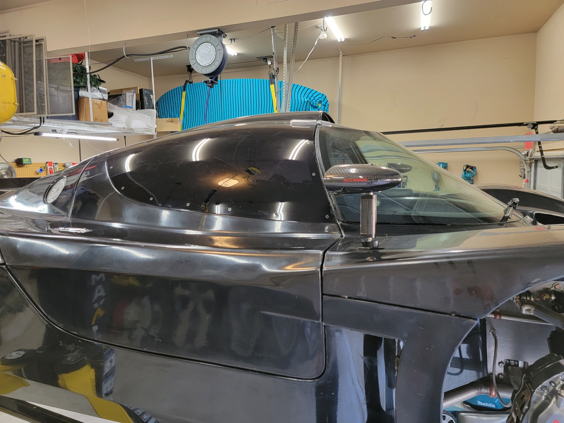

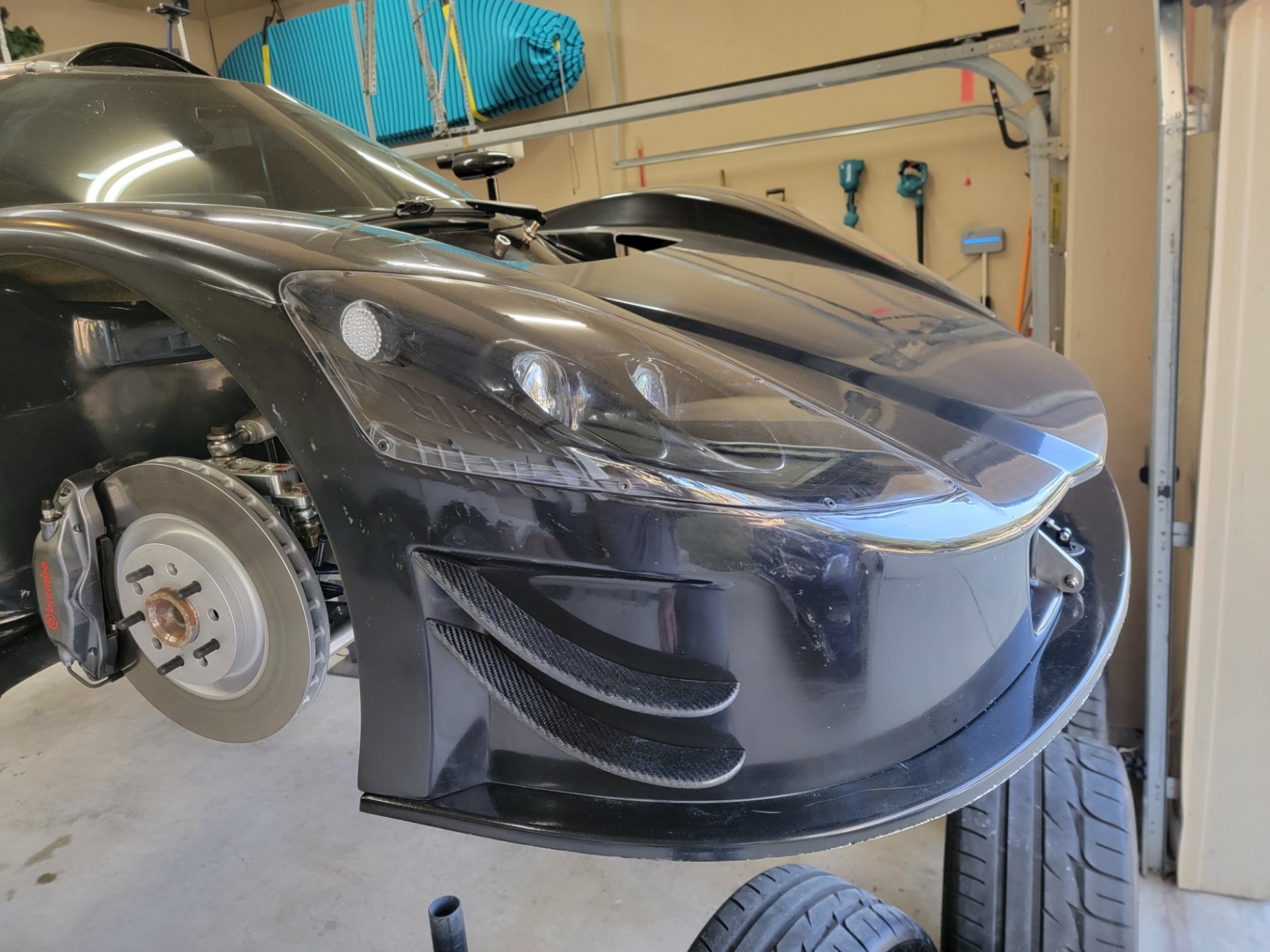

Mounted the headlight covers, tinted side windows, and canards. I'm definitely glad I picked up the tinted windows during the group buy. They look much better in person than in the pics, and visibility is surprisingly good even though they look very dark from the outside. I used riv-nuts and stainless/black oxide screws so they're pretty easily removable. I kept my clear 2-piece windows as well so I can swap them in if I ever want to.
Looking great - I sure hope those side windows are light enough to pass inspection as well as to keep the law off your case!
Thanks! I installed them *after* the inspection and since I'm registered as a replica, no annual inspections :)
Very smart! Hopefully the police in your area don't stop and test. They do that sometimes where I live in Texas.

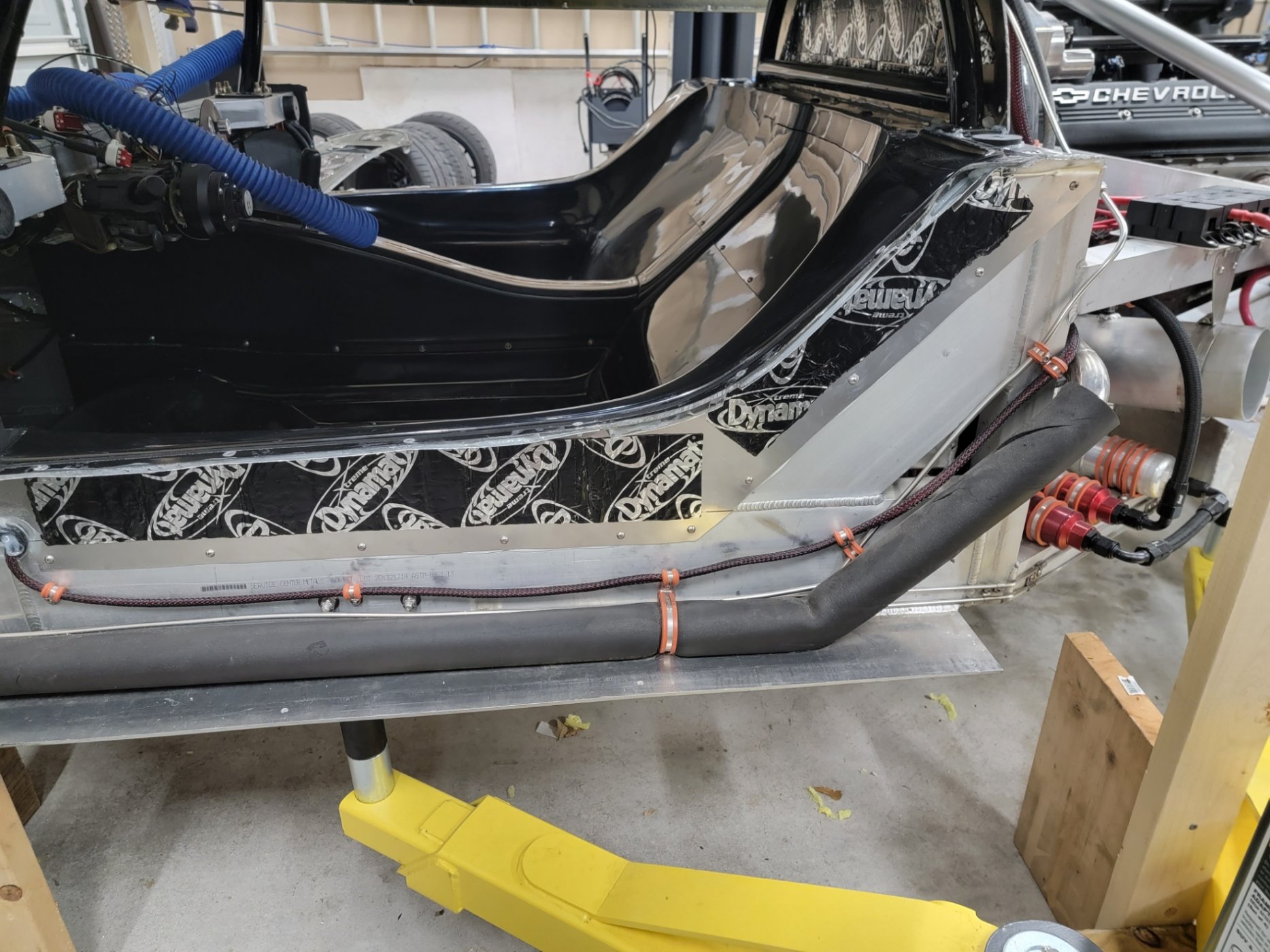

I decided to pull the body back off to install better cabin insulation. It was a one-man job by necessity so I was able to use my lift to lower the car from the body while the body was supported by braces. Now I'm working on close-out panels and insulation before I drop it back on.

Got the close-out panels, bit more Dynamat, and went over every inch of sealing everywhere to make sure I don't have any remaining interior air leaks -- except for the doors since I don't have door seals on yet. Body is back on and will be taking it back out this weekend for some more driving! I'll post another video with more detail in the next day or two as well.

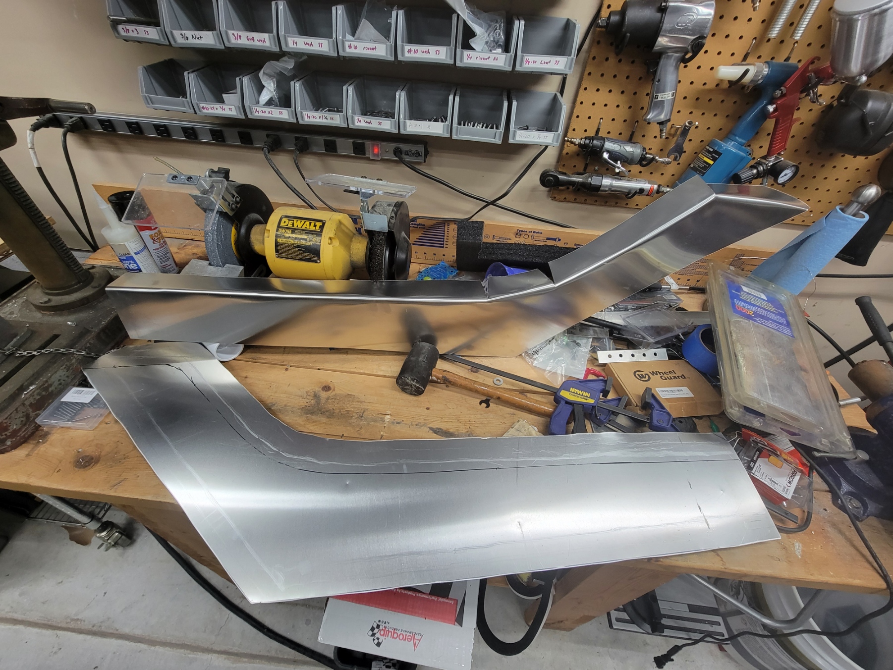

I cut the close-out panels from 1/32 aluminum. Screwed and silicone sealed to the chassis, then silicone to the interior tub and sandwiched it with the tub by crimping the rivnuts through both (for the bolts that connect the tub to the body). Even though it's very thin aluminum it's very rigid once it was all screwed together.

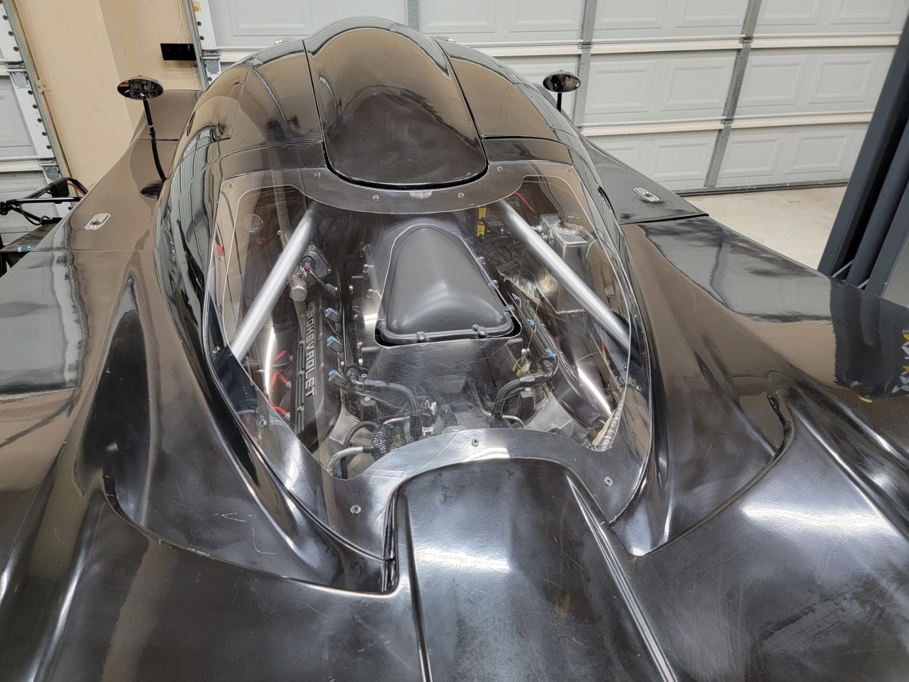

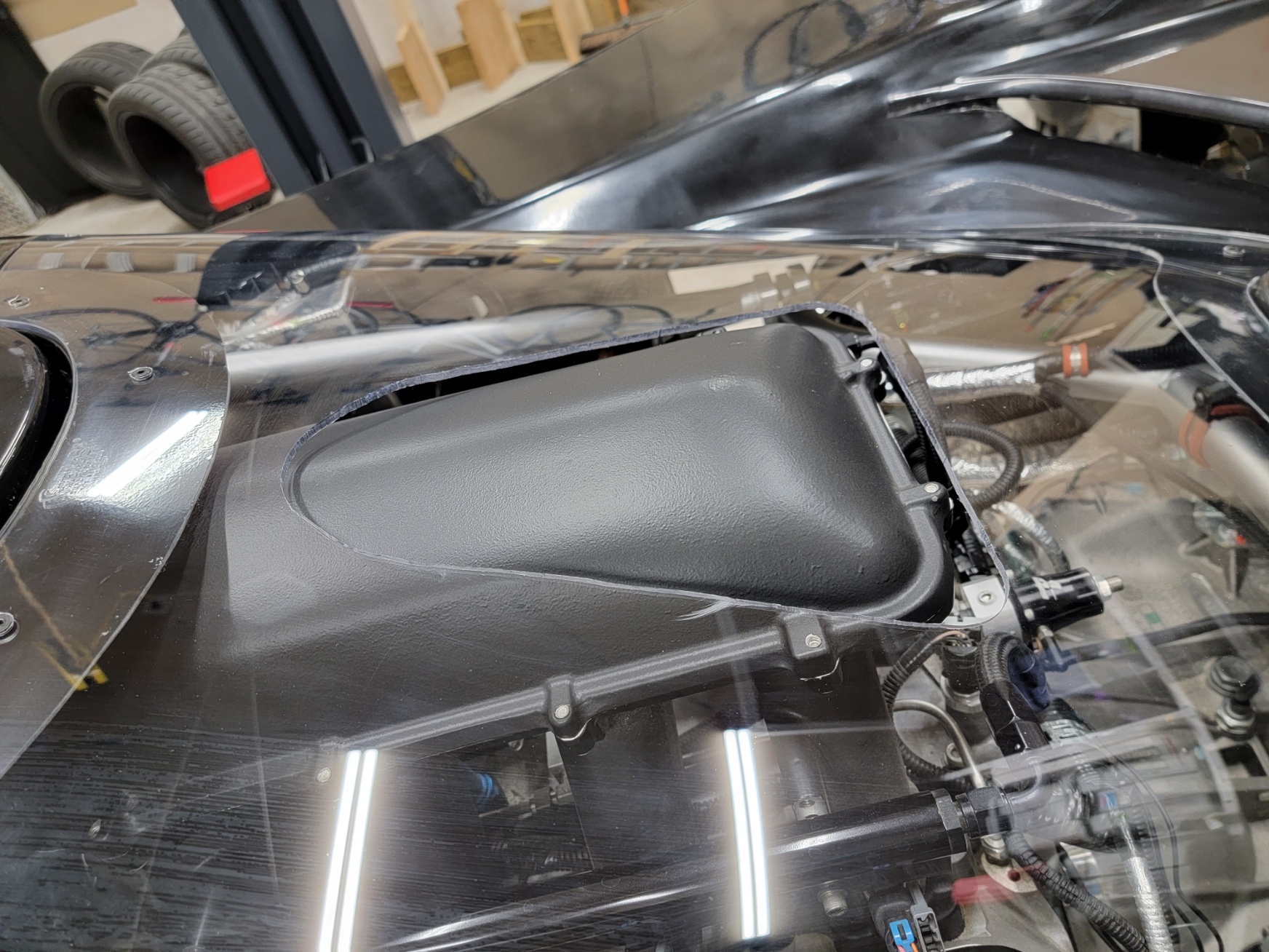

I also decided it was going to take too long for me to get a different panel laid out to replace the rear glass and cover my intake, so I went the faster route (I want to drive, dammit!). I cut out a section to clear the intake and I'm actually pretty happy with how it turned out. I still need to clean up the edges a bit, but the shape flows well with the intake and still looks pretty clean since the intake is already black. Looks better in person than in the pics because of all the glare from my garage lights. If you don't like it I don't want to hear about it :D

Congrats on getting the body back on with the windshield in place. Glad it all worked out and nice work on the close out panels. Looking forward to more SLC driving reviews!

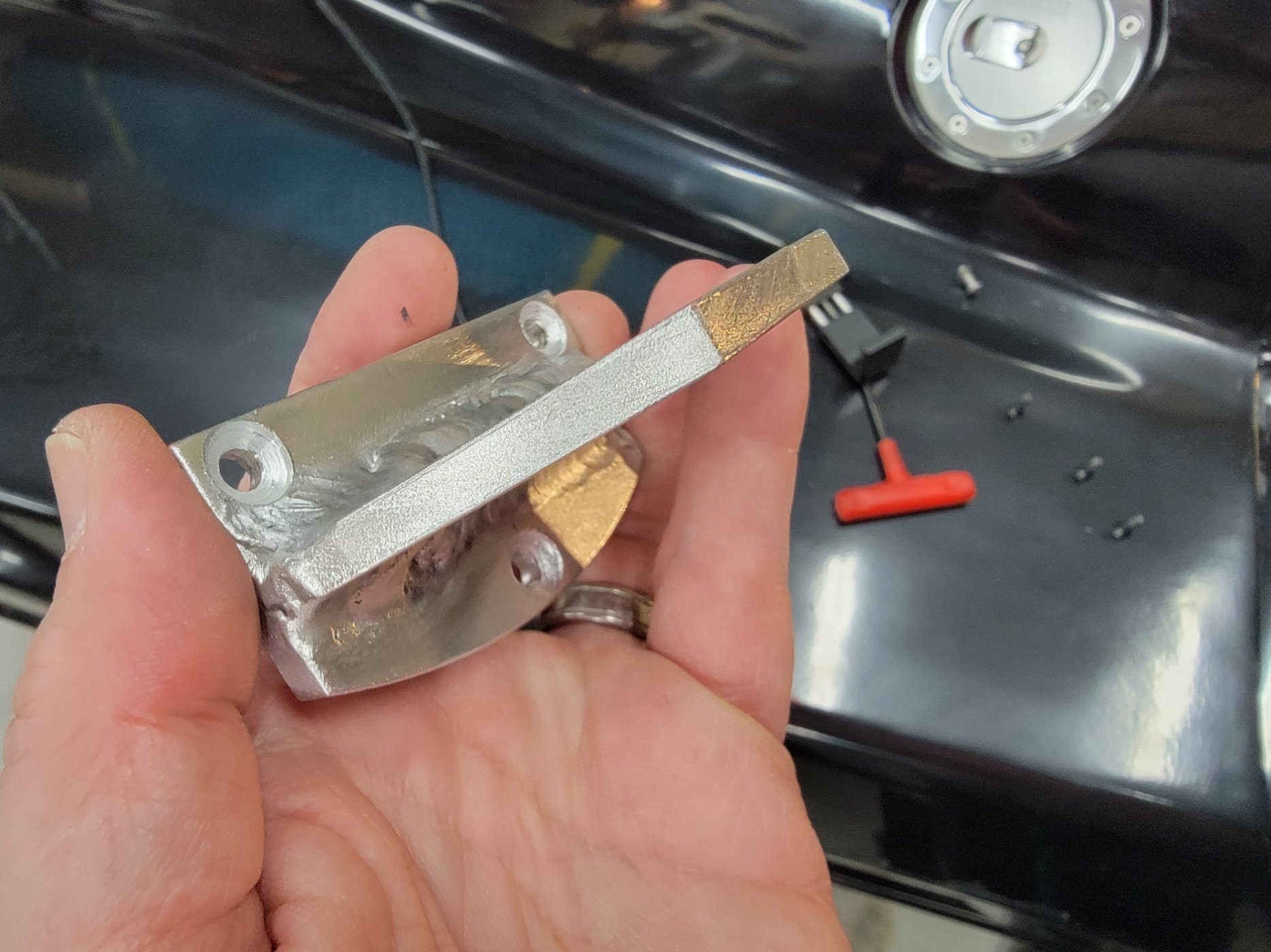

I hate suction cup mounts (it's just me -- I'm weird) so I cut/welded up a small bracket from scrap 1/4" aluminum that bolts to the rear of the tub/header panel between the seats with a standard 1/4" hole for a camera mount. Puts the camera right at head-level. I painted it black to blend in since I'm just going to leave it in all the time.
