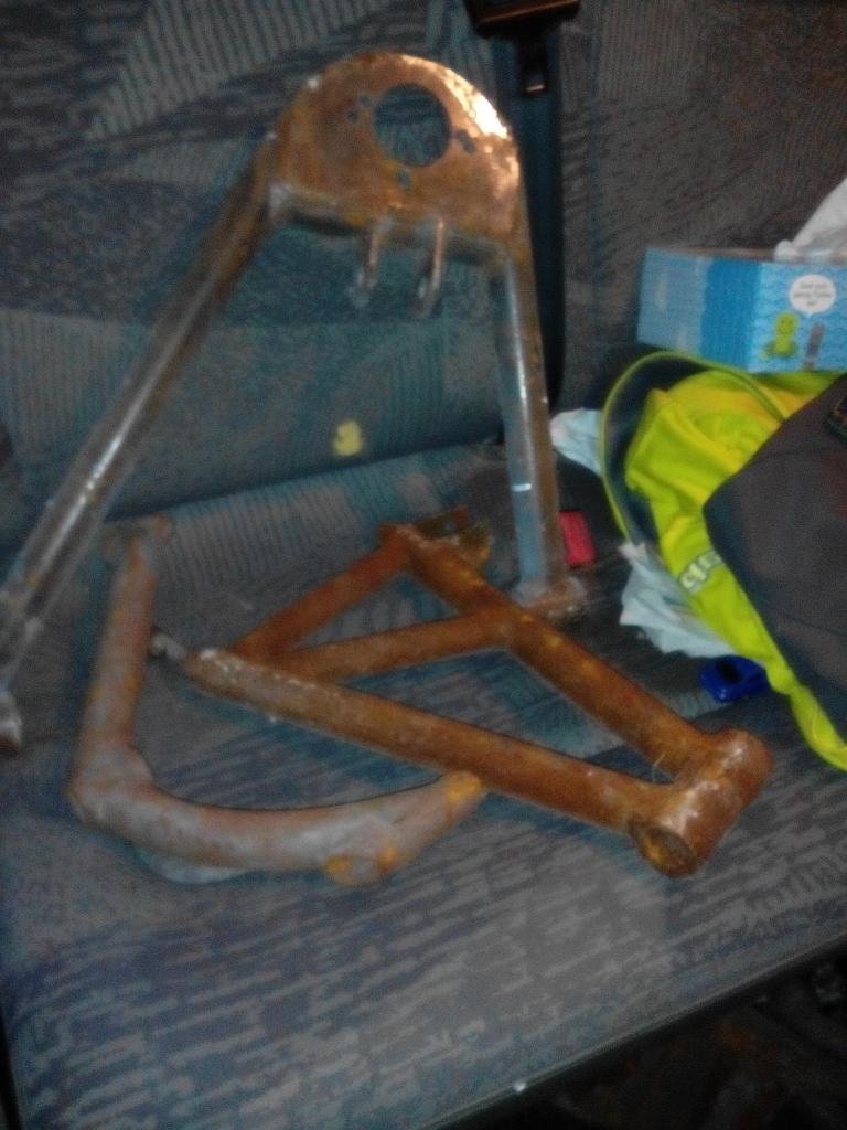

Ok so here are the uprights, wishbones, "bars" and discs with hubs. Tomorrow I'll prepare the electrolysis bath to get all the rust off.

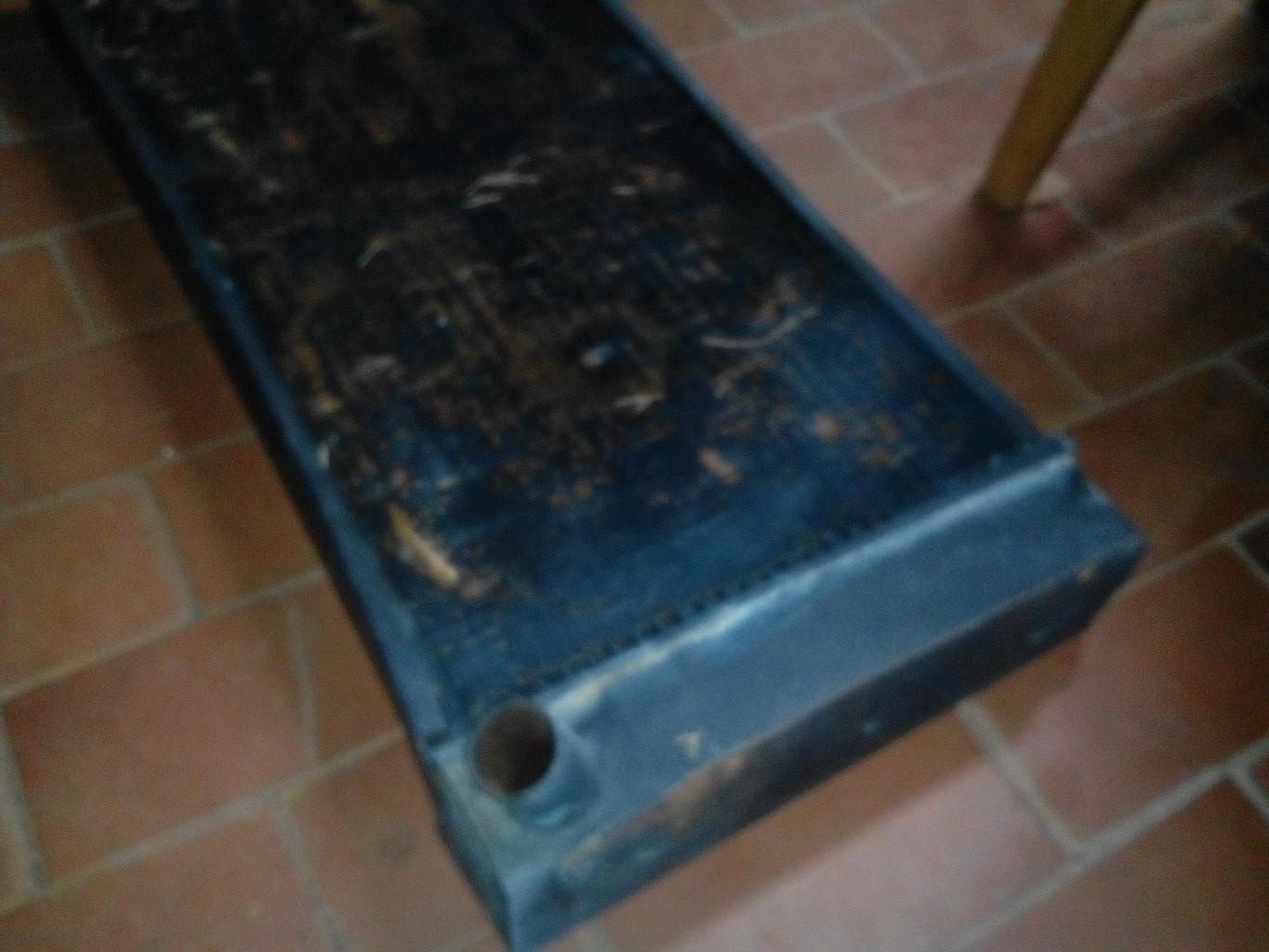

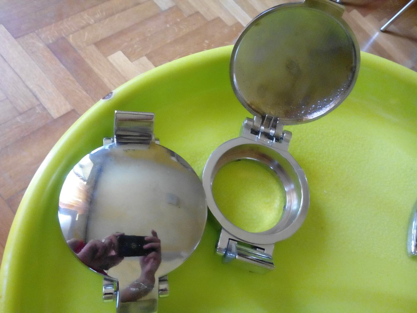

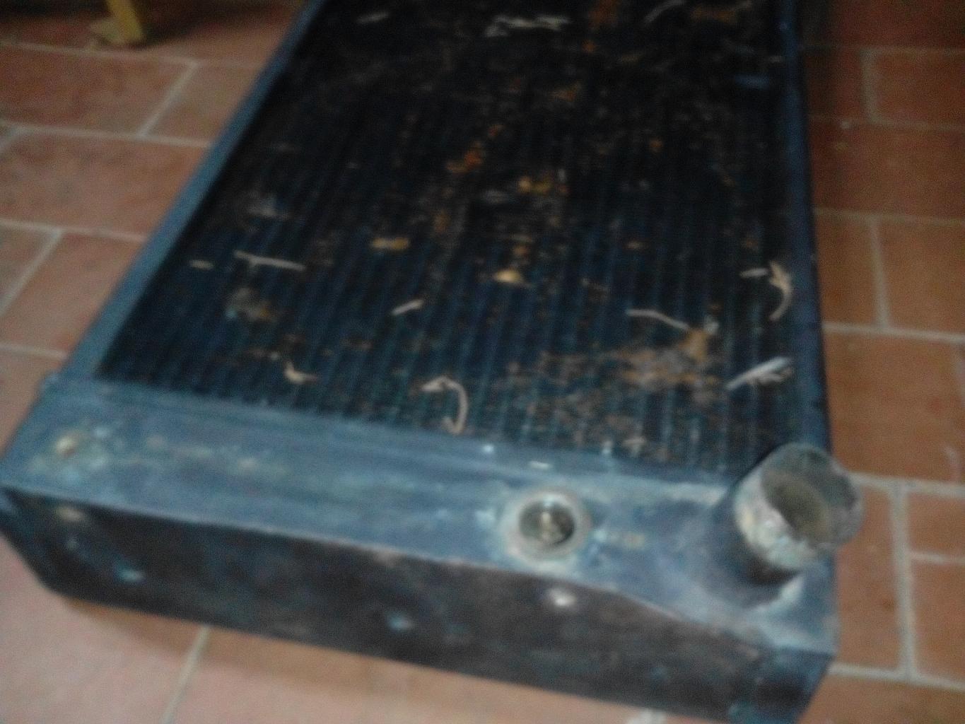

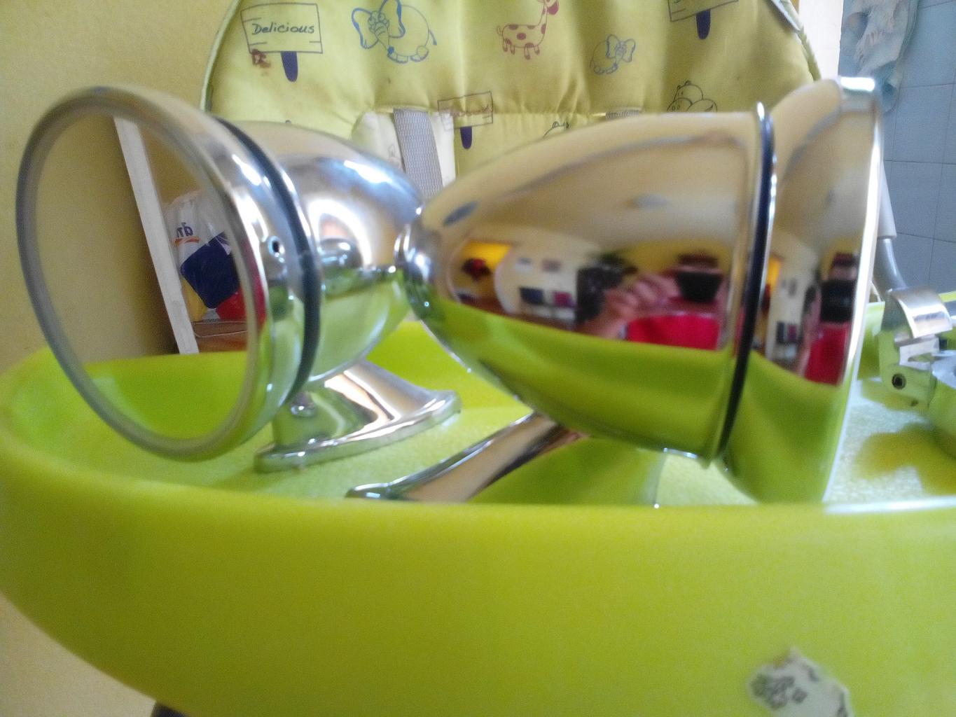

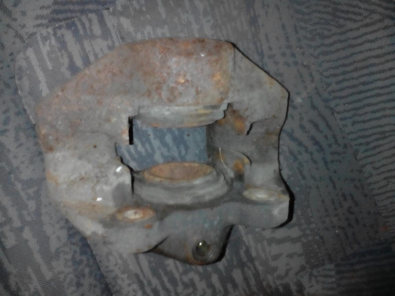

And calipers, radiator (allegedly original GT40 radiator, perhaps someone can confirm that), bullet mirrors and fuel caps. I wanted to take photos of other parts on the high chair but my wife drew a line there.

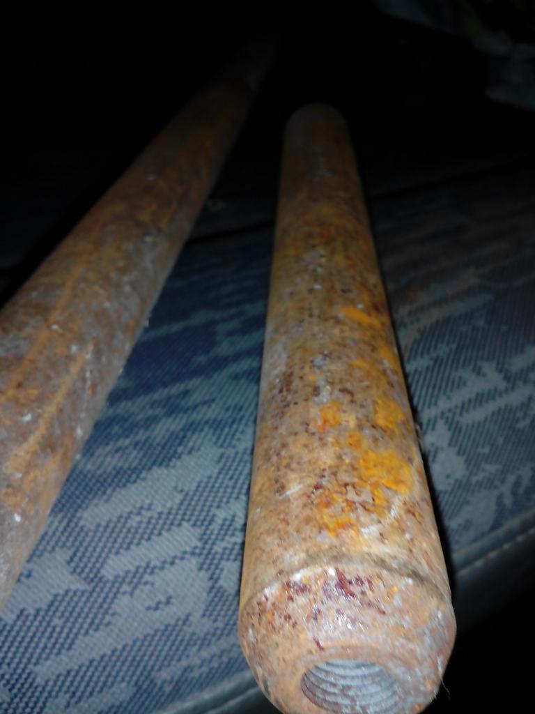

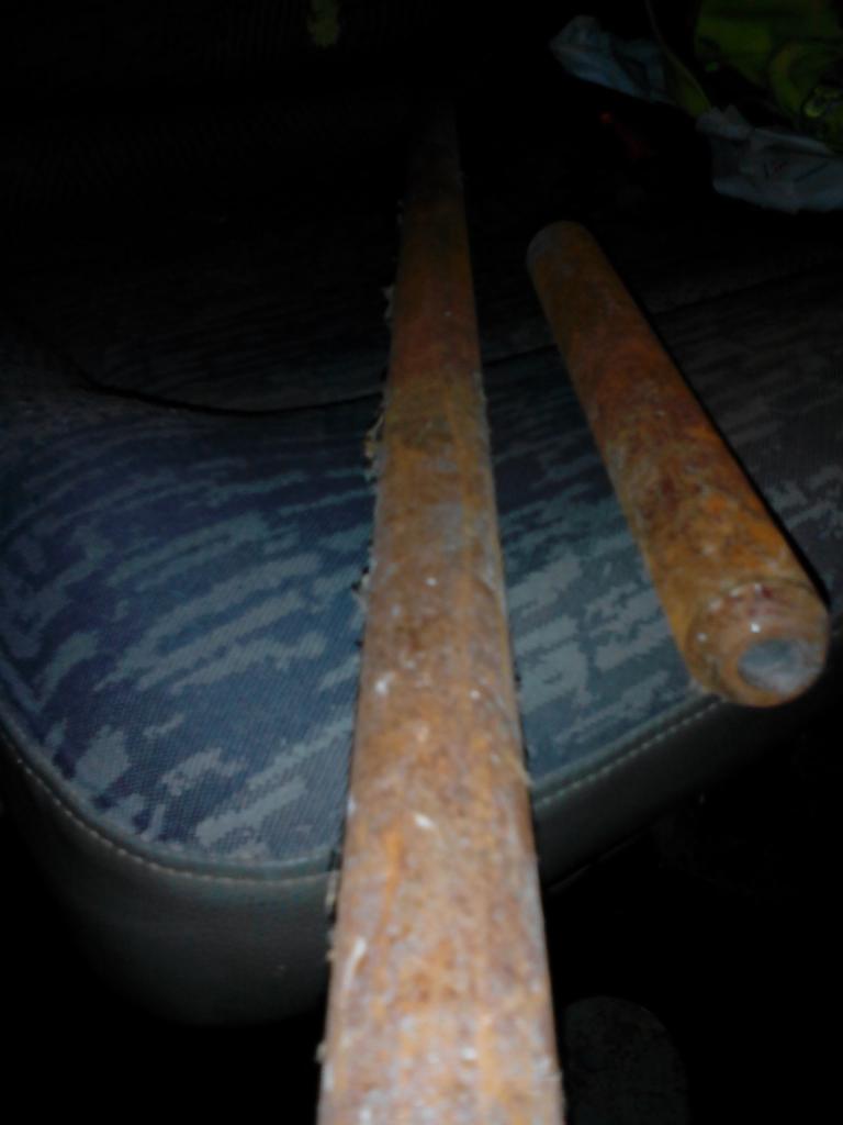

Wow! Super crusty! I think your long rods (bars) are the upper and lower rear radius arms that go from the rear suspension uprights to turrets just behind the cabin. There should be four of them :)
Yup, four of em. Actually four long ones and two short ones. I think they attach there too, rear side of the bulkhead and uprights. The short ones are a mystery though.
What do you guys think about this:
GT40 Granada Mk. 3 Based 300mm Billet 4
Seems like a decent disc and caliper and not that expensive either.
Short one - this? (top link). Upper and lower radius rods also shown.
Photo courtesy of Tornado Sports Cars..
That's right. So the short ones bolts perpendicularly to the chassis and the long ones stretch to the bulkhead. Case closed. Thanks mate :)

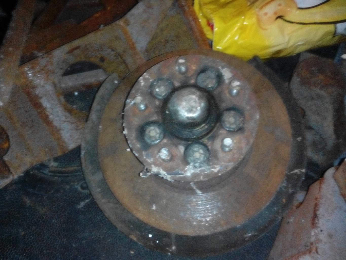

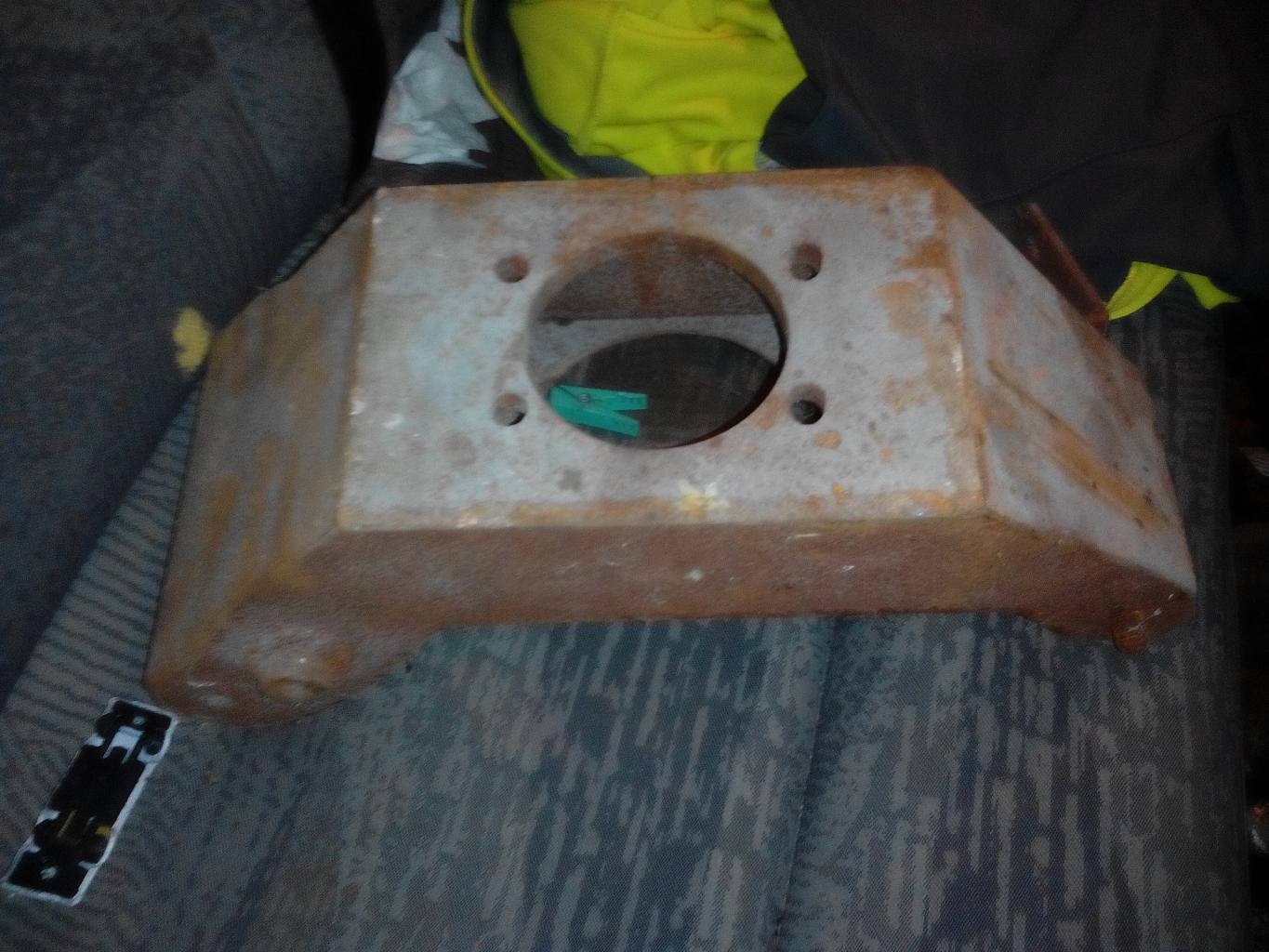

Do you have the Mk2 front uprights in the parts you have. I can see the Granada Mk2 front hubs but not the uprights.
Hvala Renato. Nisam ga birao, on je izabrao mene :) Drago mi je vidjeti Balkanca na forumu.
Hi Mike. Attached are the two photos. The first one is what I always thought to be an upright. The second one is of a disc along with what I thought to be a hub. Since English is not my first language there might be some misunderstanding on my part.

The first photo is an upright but a rear upright. I was asking if you have the front upright which would usually be from a Mk2 Granada. The second photo is of the front hub which looks like Mk2 Granada front.
I am guessing that the rear upright that you have needs the rear hub from a Mk3 Granada/Scorpio if it is the same as the GTD setup.

Mike, you're right. These are the rear uprights. I need front uprights (anyone?) and rear hubs and brakes.
