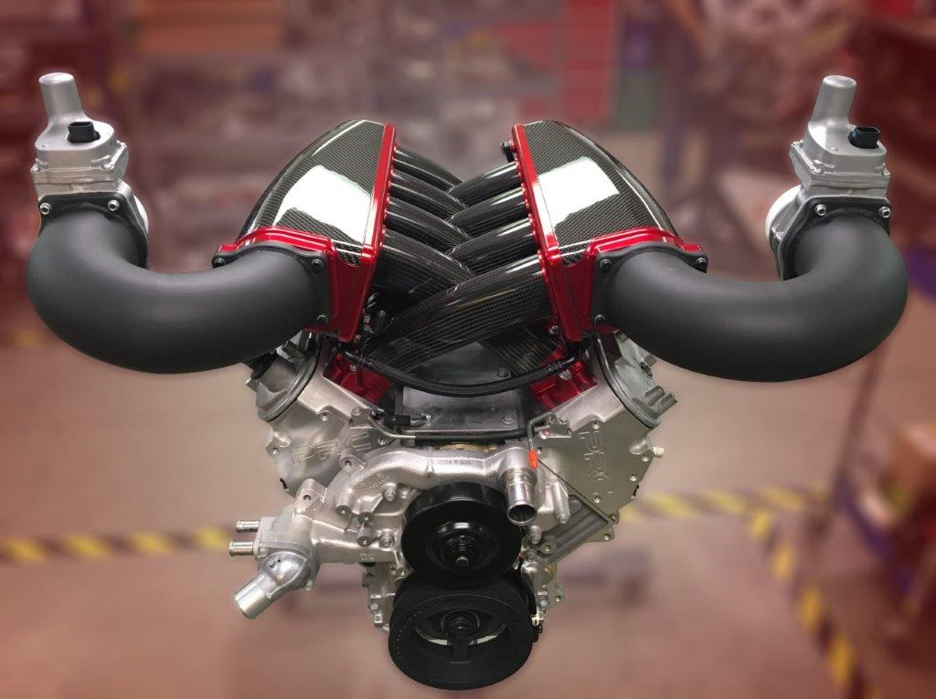

I just got word from Katech that the motor has been assembled. There was a delay in getting the LS7 heads we had made by Texas Speed. The motor is waiting for Dyno time, which should be in a week or so, then the motor goes to Superlite. The body is not yet in from the fiberglass sub-contractor, so the motor really did not slow things up. The chassis and suspension is reported to be complete. I am having Fran assemble the transaxle, clutch, motor and mount it. Also need to have custom throttle body adaptors made to get around some space issues. The light is at least visible at the end of the tunnel to be able to set up a shipping date.

Katech has the motor built. Just waiting for the Dyno time to run it and tune it. It will then have the Carbon valve covers added, then off to Superlite to have Fran install the drivetrain. Thanks to Fran and Katech for mocking up the motor in the GT-R to determine space issues. The custom throttle body adapters were designed and built by Fran. He has been so supportive. This photo is the motor waiting for the dyno. The baby's due date is approaching. Getting excited!

Hi Dan:
I will be using the Graziano per Fran's suggestion. We don't know the power output of this motor yet, but everyone agrees the transaxle will take it.
