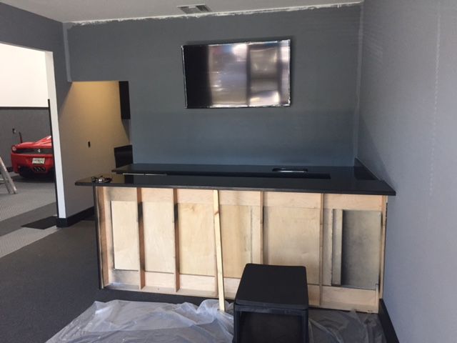

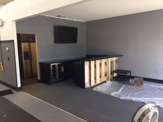

I have been working on the final stages of my garage, with the "Car Bar" being the last project. The bar is in. Working on the rock veneer for the back wall and the front of the bar. Lighting, plumbing and AV, then it is finished. Just in time for the car to get here.
Some photos of the bar. Car pics to soon follow

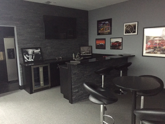

I have everything finished in the "Car Bar" except the lighting. As you can see, I cut out a wall in what was once an office, then changed the ceiling so I could store parts in the "loft." Added a bar, seating, some rock wall accents and pictures. Now ready for the "arrival" party. Just don't know when that will be.

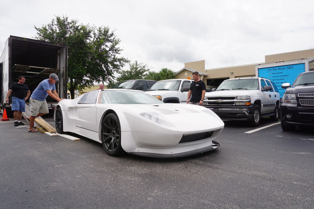

The car finally arrived, so this officially starts the build. Before I go into any details, I would like to thank Dean, Allen, Will, Howard, Scott, and all of the others who contribute to this forum. Without your help, I would be on the side lines looking at others builds.
Also want to thank Fran Hall for developing such an awesome car.

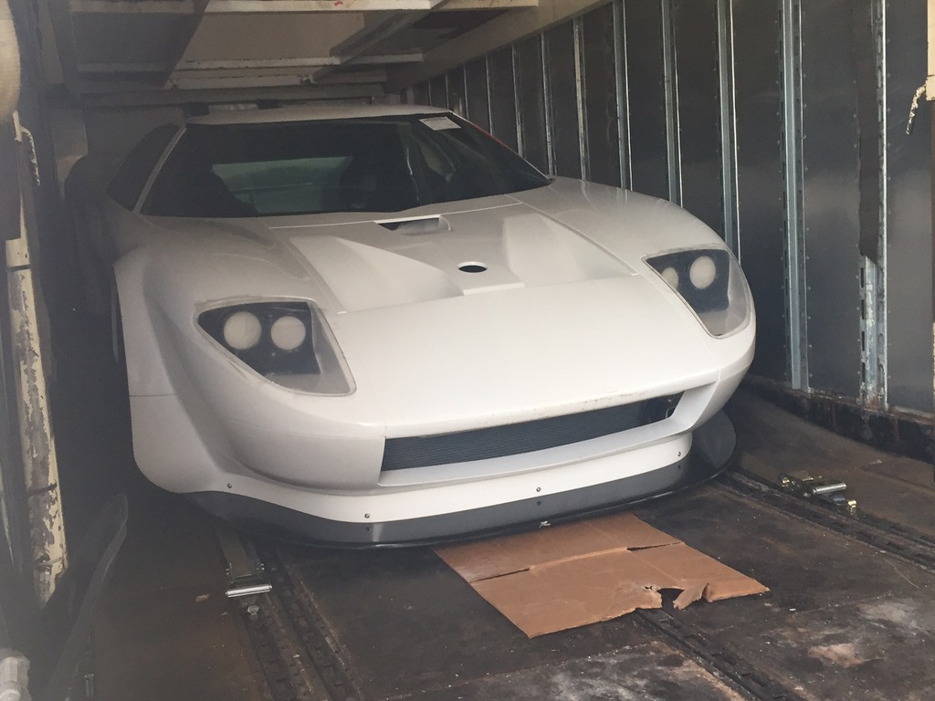

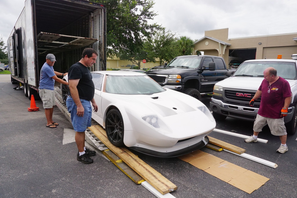

My car arrived without any real problems, other than a small chip in the front splitter. The driver admitted it was his fault and would have to pay out of his pocket to get it fixed, but I am doing this for the fun and experience of the build, so I will repair and paint the splitter at some point.
Mannix Automotive is next to me in our business park condo, and those guys have been looking forward to the car arriving almost as much as I have. They helped unload and get it in the shop. After we stared at it from almost every angle, it was time to start removing some of the body.

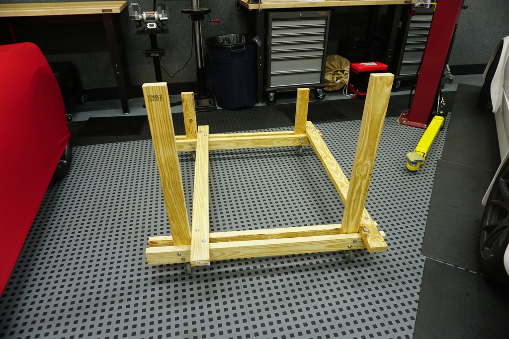

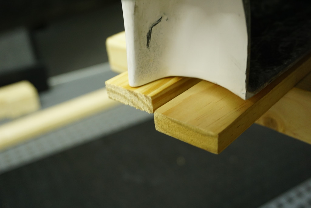

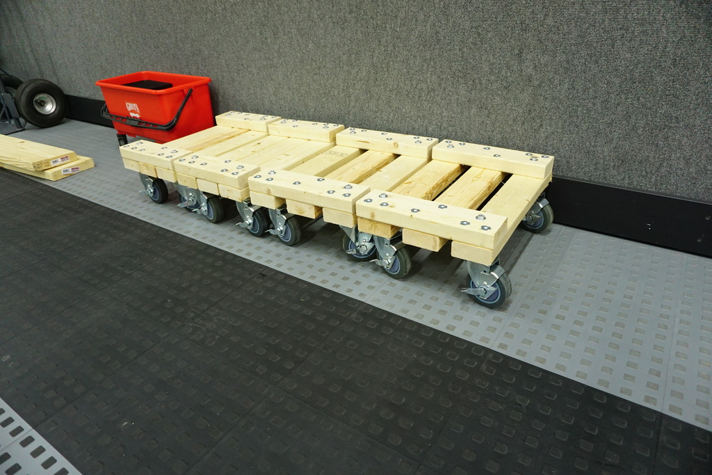

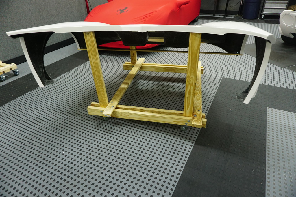

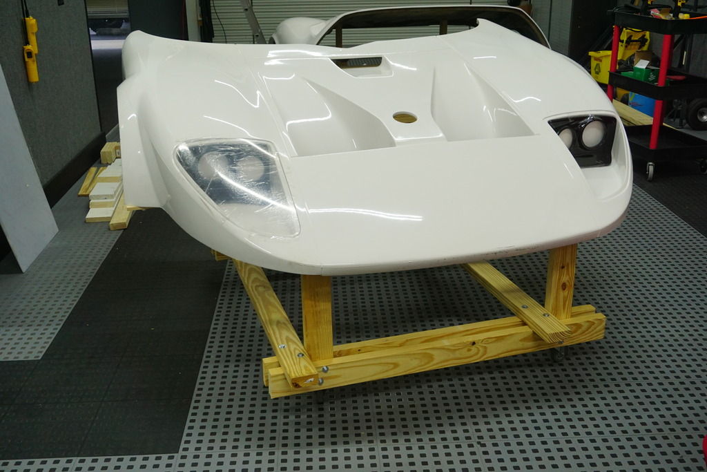

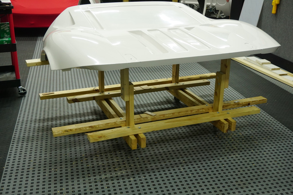

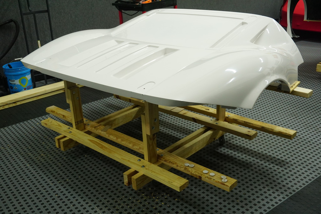

While I was waiting for the car to arrive, I built some wheel dollys and two body carts. I had no idea what dimensions to make the carts. Just used some of the measurements from other cars. The front fit with little modification, having a horizontal support contact under the headlight boxes where there is some vertical support. I tied the sides together where there were locator pins, as you can see just ahead of the wheel well. The rear made contact where there was, again, adjacent vertical support. The carts are on casters, and high enough to be able to work on them when it is time for paint prep.

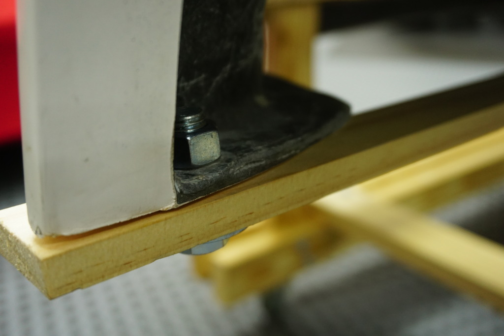

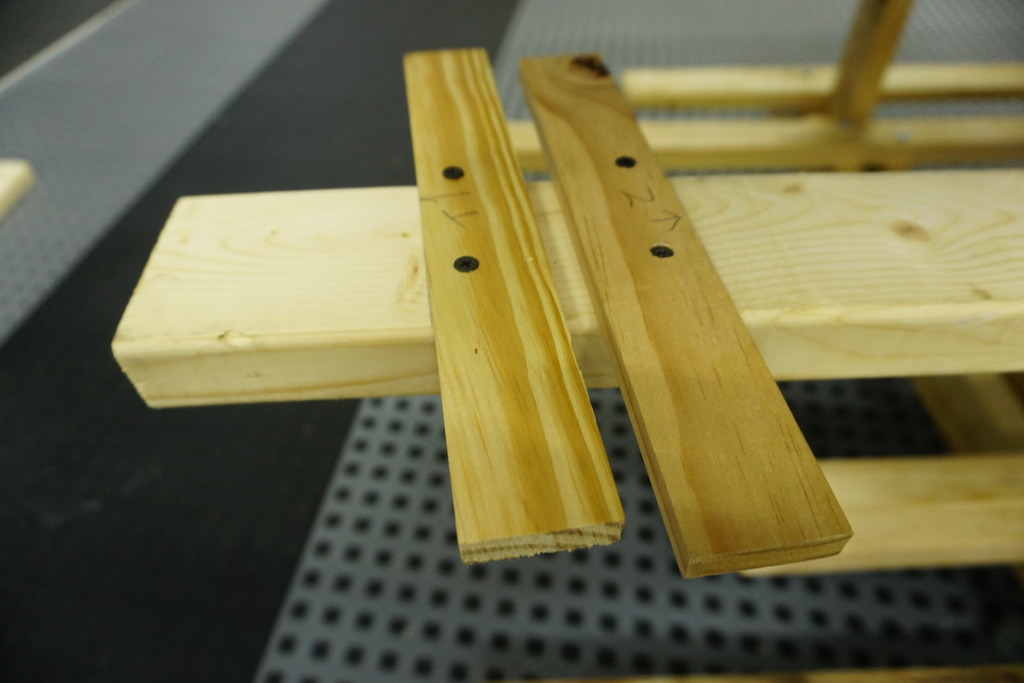

The rear clam also fit rather well, with minor modifications to the body cart. We wanted to limit the spread of the body panels, and there is a groove in the mating body panel that the clam fits into, so we used two pieces of wood to make the "groove" in the cart. Keeping the body shape the same as it was on the car was the priority. The support areas contacted the rear clam only where there are adjacent vertical body material.

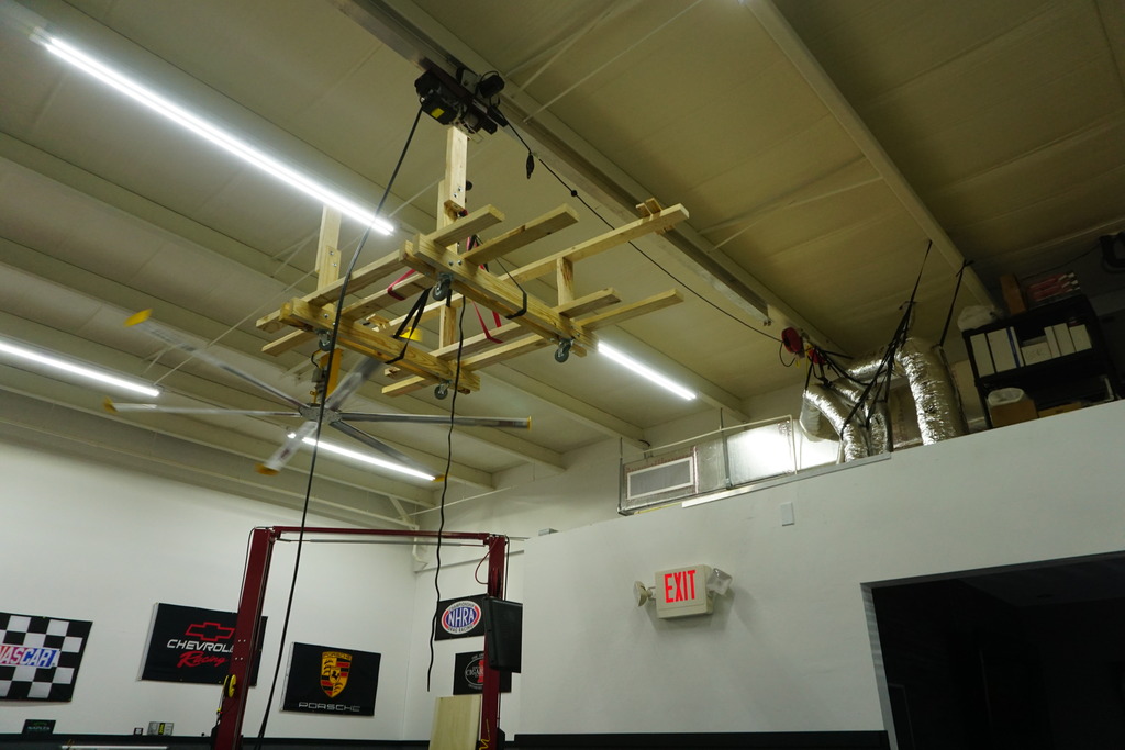

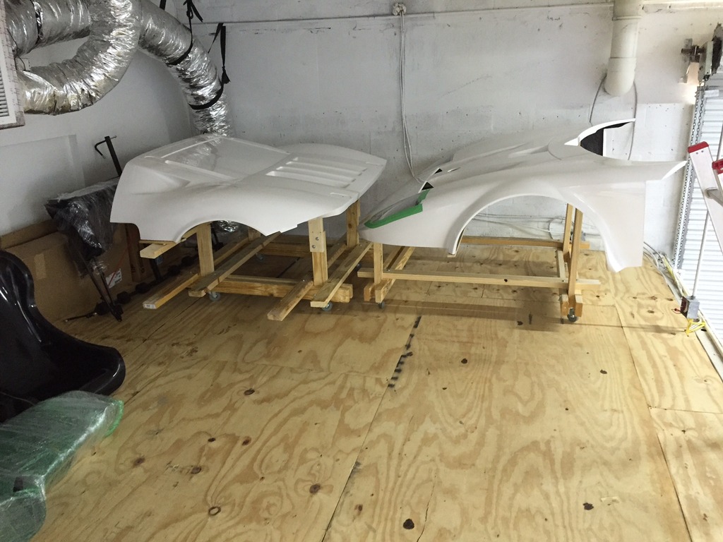

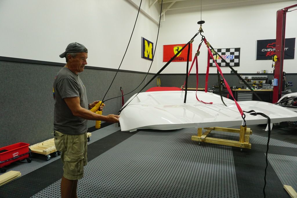

After the carts were made, it was time to use the little I beam hoist that I put in to get the carts and the body parts up to the loft I use as a storage area. As I remove parts, tires, etc., they will go up to the loft until needed. Keeps the main floor clear.

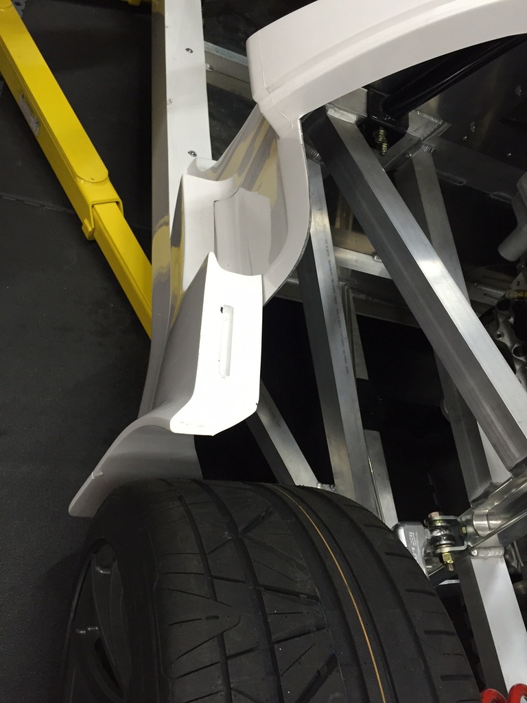

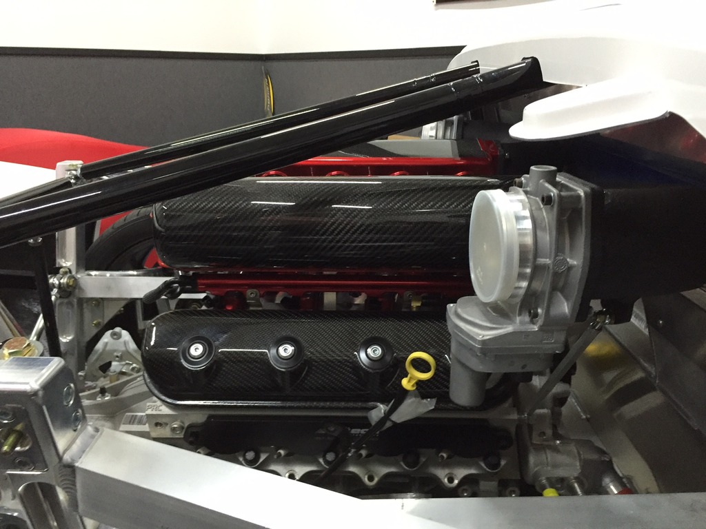

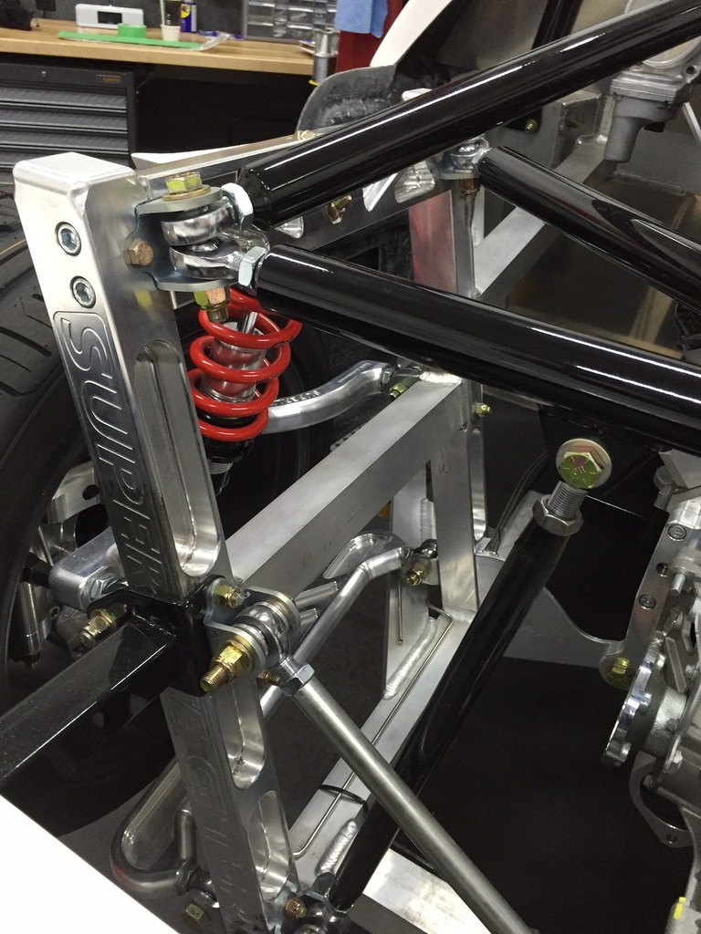

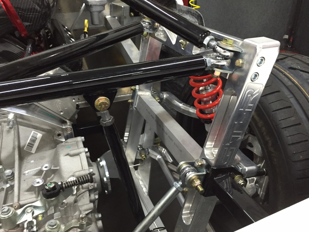

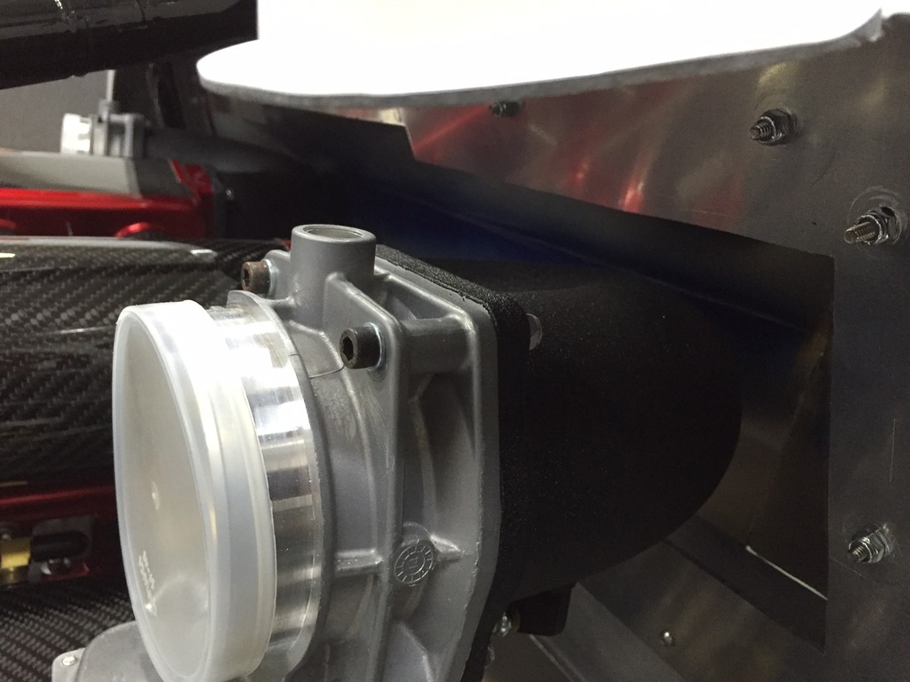

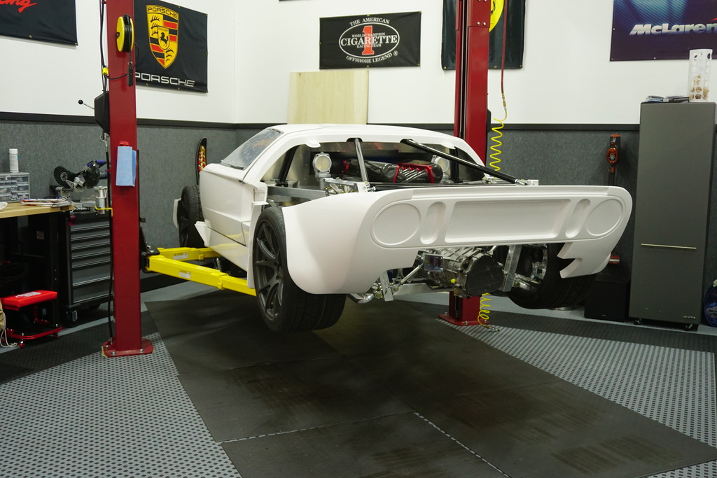

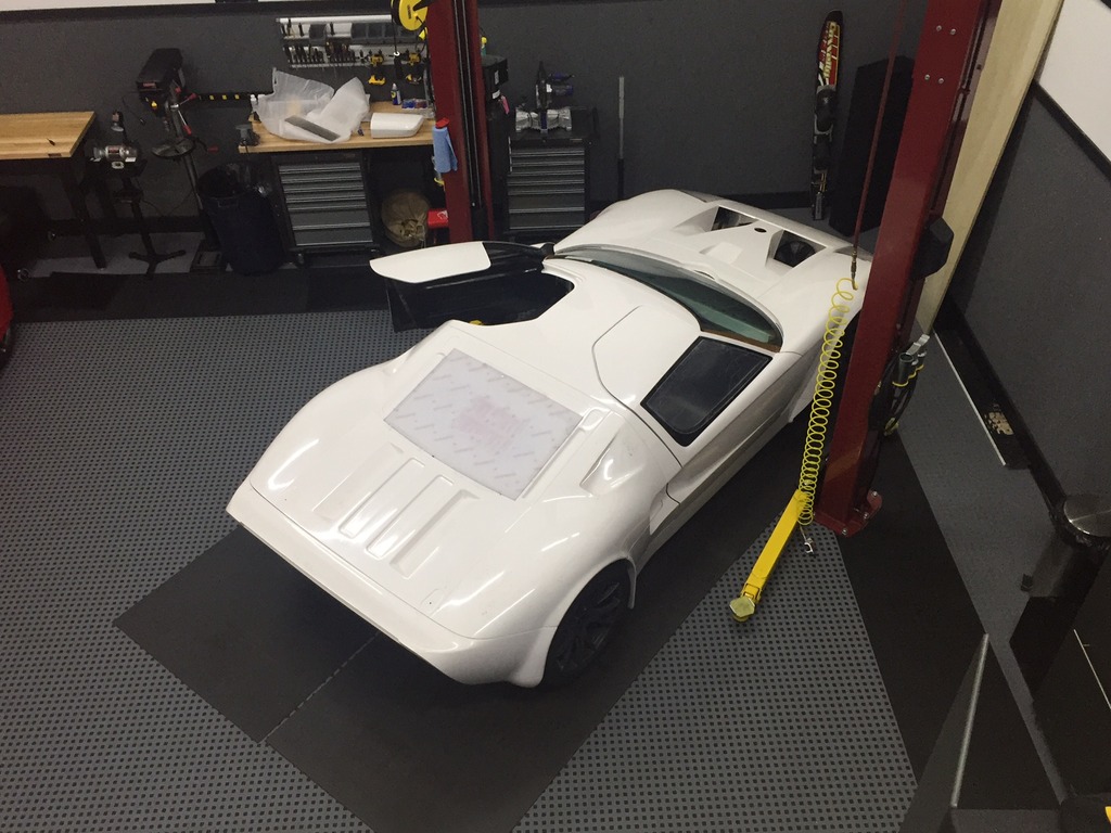

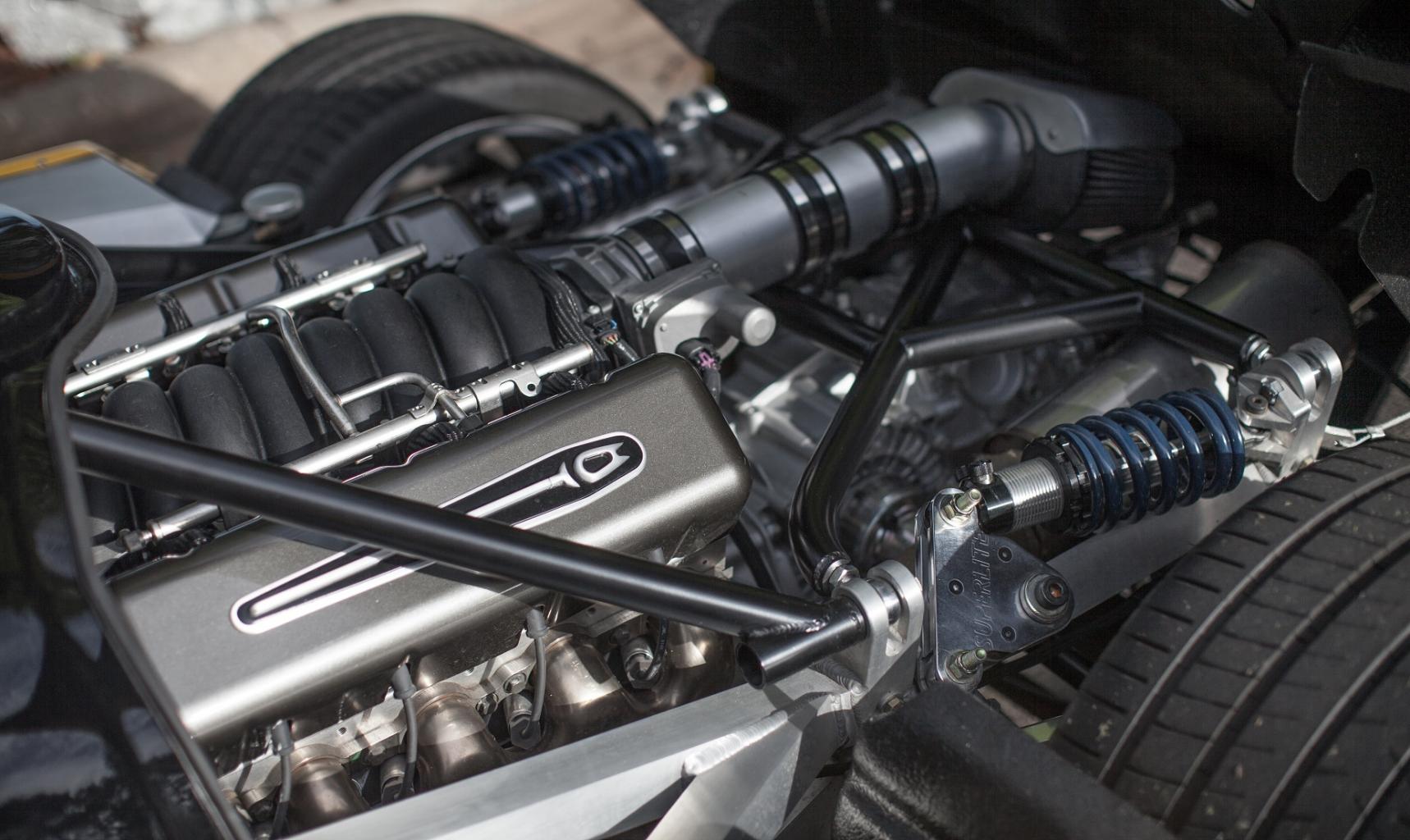

With some of the body removed, it was time to put the car up on the hoist and look around. The car is so low, I had to use a jack to lift the car enough to get the hoist arms underneath to the areas on the car that will support the lift. Some photos show the awesome suspension, engine and transaxle mounts. The motor looks just as I was hoping it would look. This is going to be a street car. I hope to take it on the Hot Rod Magazine Power Tour. It will look great.
To get this manifold to fit, we needed some custom throttle body adapters and needed the firewall modified. The boxing in the firewall and adapter can be seen in the close up.
