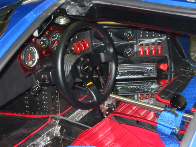

Got the dash in and connected. Steering column in as well, so now it tells the front wheels exactly where to point.
