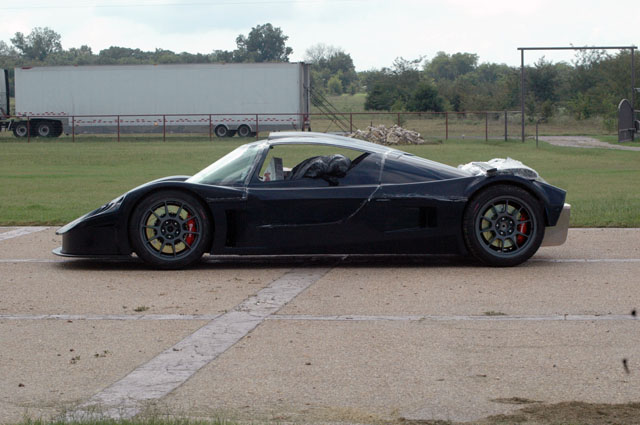

Ben, the CCW's look good, any color too (maybe at a price). Got mine in gunmetal, changed my mind and had them powder coated satin black.
Hi Ben,
I took this photo after I off-loaded my car, showiing the CCWs in Grey:
