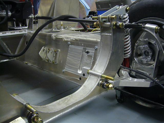

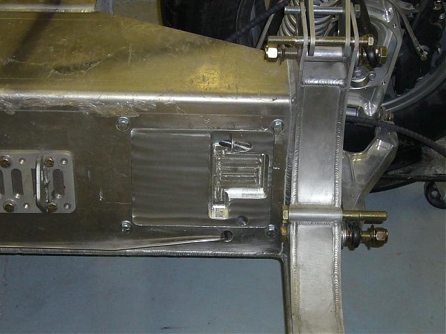

Rob - what's the largest size part you machine on that? I originally considered one of those but decided against it because of the limited table size and the mill spindle is awfully close to the lathe spindle.

Actually the table size is the limiting factor, not the distance to the lather (usually). In a perfect world (i.e. one with lots of money falling from trees) I would have purchased a larger one, but for small shop projects it works great. So..nope, there is no machining cross members, but I machined this bell housing clearance plate with shift cable guides.
