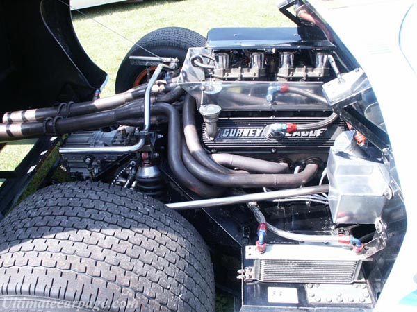

I'm just getting main components together for a replica gulf car with a 351W engine, any photos out there of that engine in the car? what valve covers did it have and did it have the 48 IDA webbers? also did it have an aviaid oil pan. I want the engine to externally look as original as possible.
Any info would be welcome thanks in advance.....

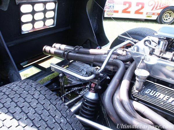

I may be wrong and I'll probably be corrected, but I believe these to be photos of 1075 engine bay. Hope they help.

Fantastic site and what a quality resto job on 1076. Plenty of detail there for creating a "true" replica.

So it looks like its going to be Gurney Westlake covers, I did see somewhere on this site an english guy making a few replicas will do a search.....

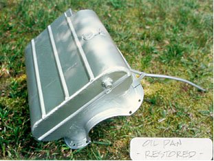

Any onfo on the pan, Aviaid?
Thanks again
Doc Watson
Found this....
Aviaid do produce a 351W gt40 pan will email them to confirm...

Well, to be accurate, the photos of 1075/76 show Gurney Eagle covers - not Weslake (although the heads were probably Weslake design for sure). Was the "Mirage 351" a Windsor or Cleveland ? I believe Chris Melia had some of the "Weslake" style valve covers a few months ago but these would have been for Windsor heads only...
