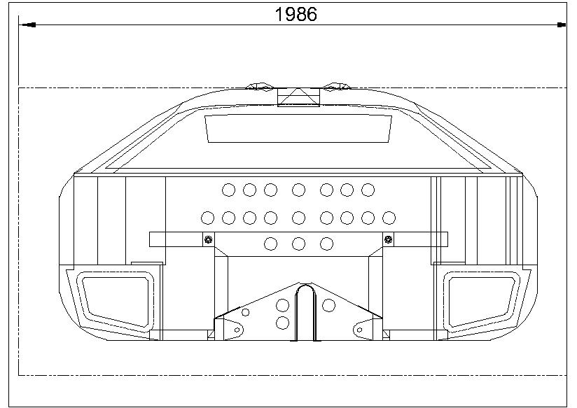

newbie trying to draw up the mirage.

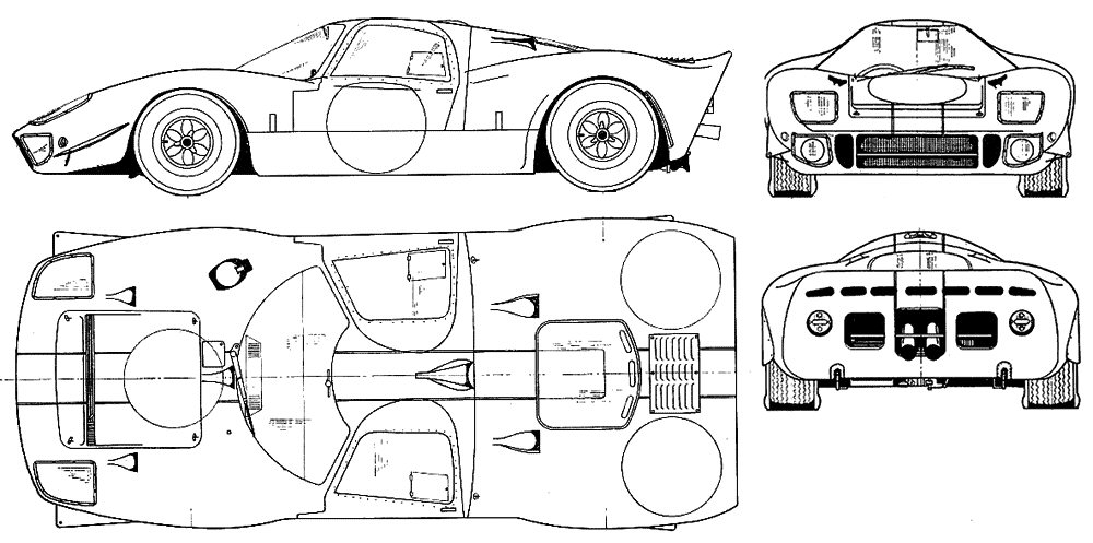

Is this any use?
Dave,
Thanks for the reply. I notice top louvre vent panels are not shown on your sketches but front winglets are, also rear adjustable spoiler isn't visible.
I'm taking it as read that the front clip is a mod of the mk1 gt40 with change to windscreen area and naca duct.
In later races the nostril evolved as well. Can anyone suggest what the square cover on driverside adjacent to naca duct is for?
Also can anyone let me know what the width of the marigold band and the actual height of the Mirage is, as this will help with setting the scale for different views front to rear.
I am currently using 1028 roof to floor, not including roof naca side flanges.
Extrapolation of the photos only gets me so far.
Thanks in advance.
mike
4 and last. As for the height, 40" perhaps? /ubbthreads/images/graemlins/wink.gif

"Can anyone suggest what the square cover on driverside adjacent to naca duct is for?"
May be for easily checking break fluid without raising the whole front clip.

The the gt40 height of 40.5 inches translates to 1028.7mm, which is my current height datum. From the photos i have is obvious 90% of the Mirage chassis was gt40. The front bulkhead and the door pillars had additional lightening holes as well as sheet steel removal. The cockpit section is highly slanted and the windscreen more circular as well as slanted.
As i don't have access to an original gt40, is there any chance of drawings detailing the floorplan and the suspension locations.
Thanks in advance
mike /ubbthreads/images/graemlins/smile.gif

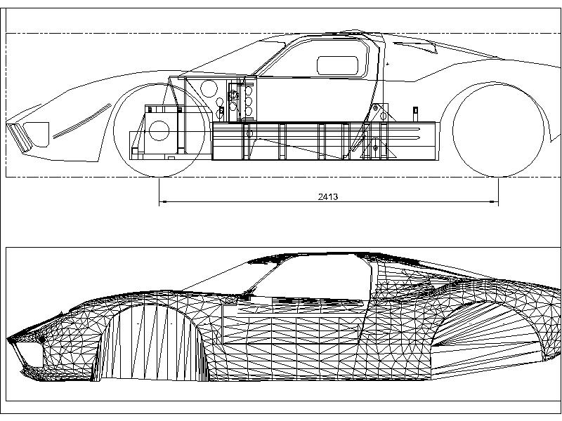

I can see there is a general interest in the Mirage so i'll post a zipped A3 pdf of the draft drawing. Scale is as accurate as i can get with photographs, this is work in progress so please don't be too harsh with your critique.
if i don't get some dimensions soon guys, i'll have to shelve it as summer is here and decking needs to be built.
thanks for the interest
mike
