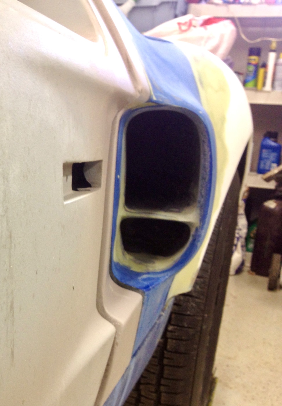

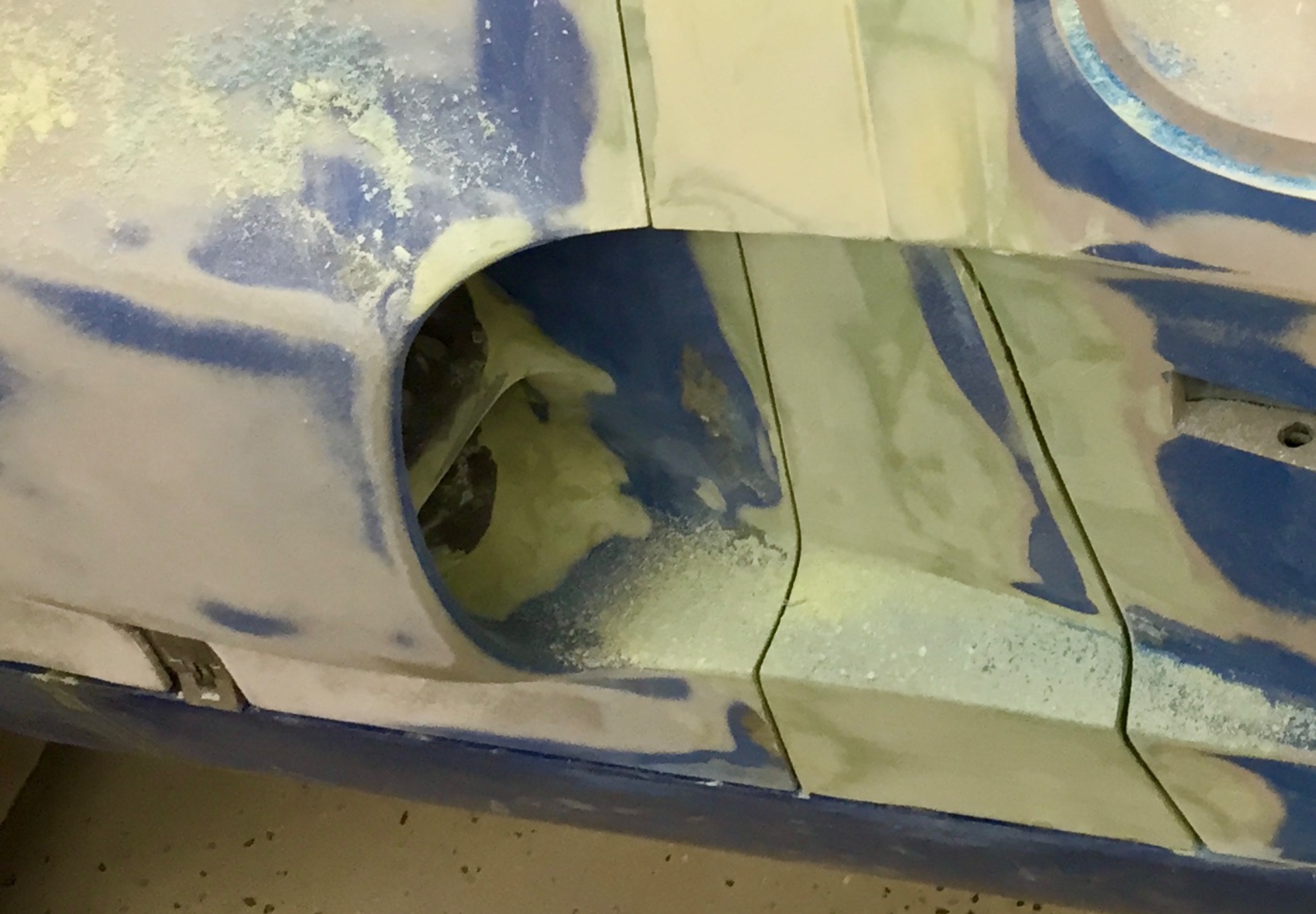

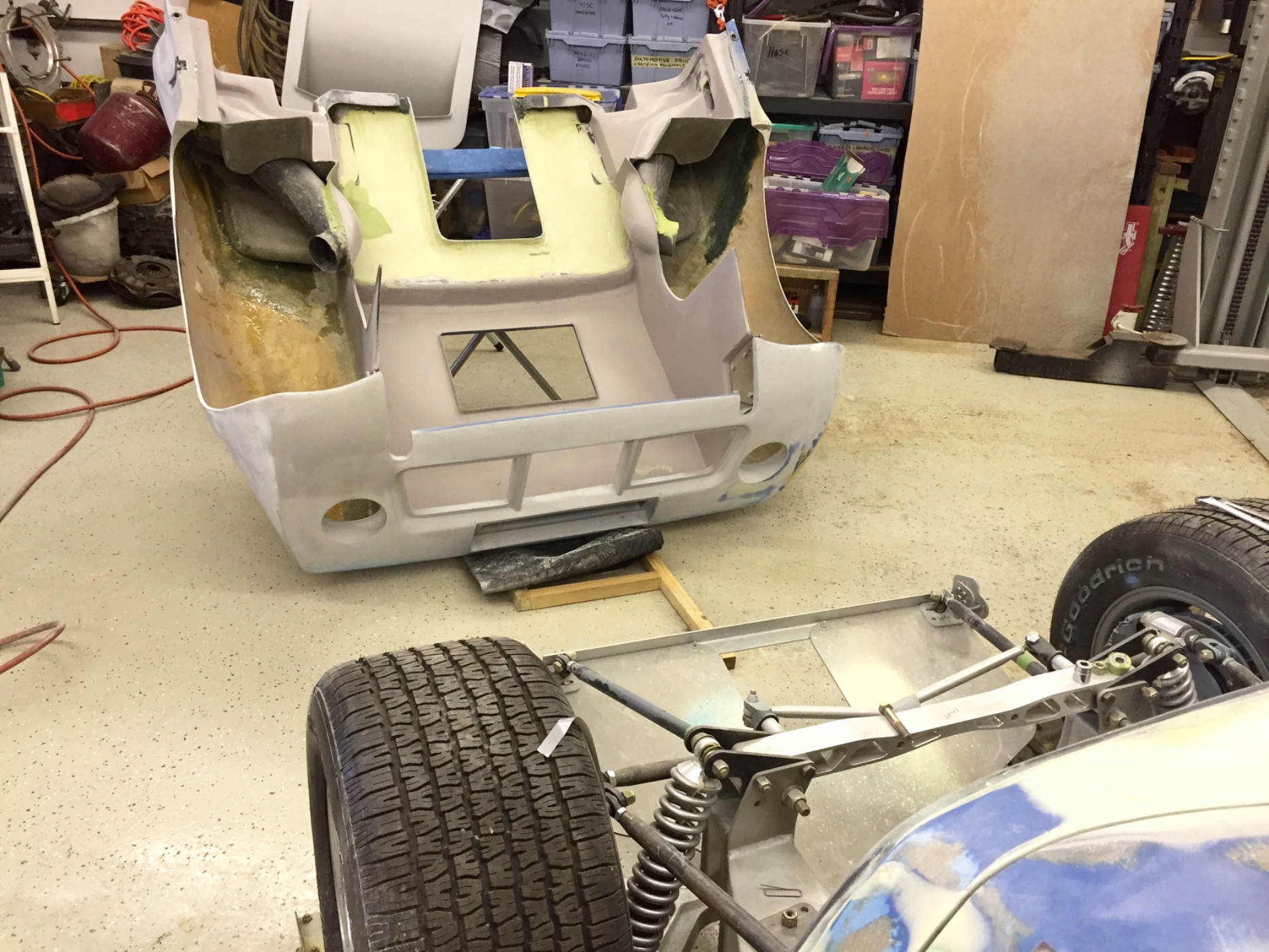

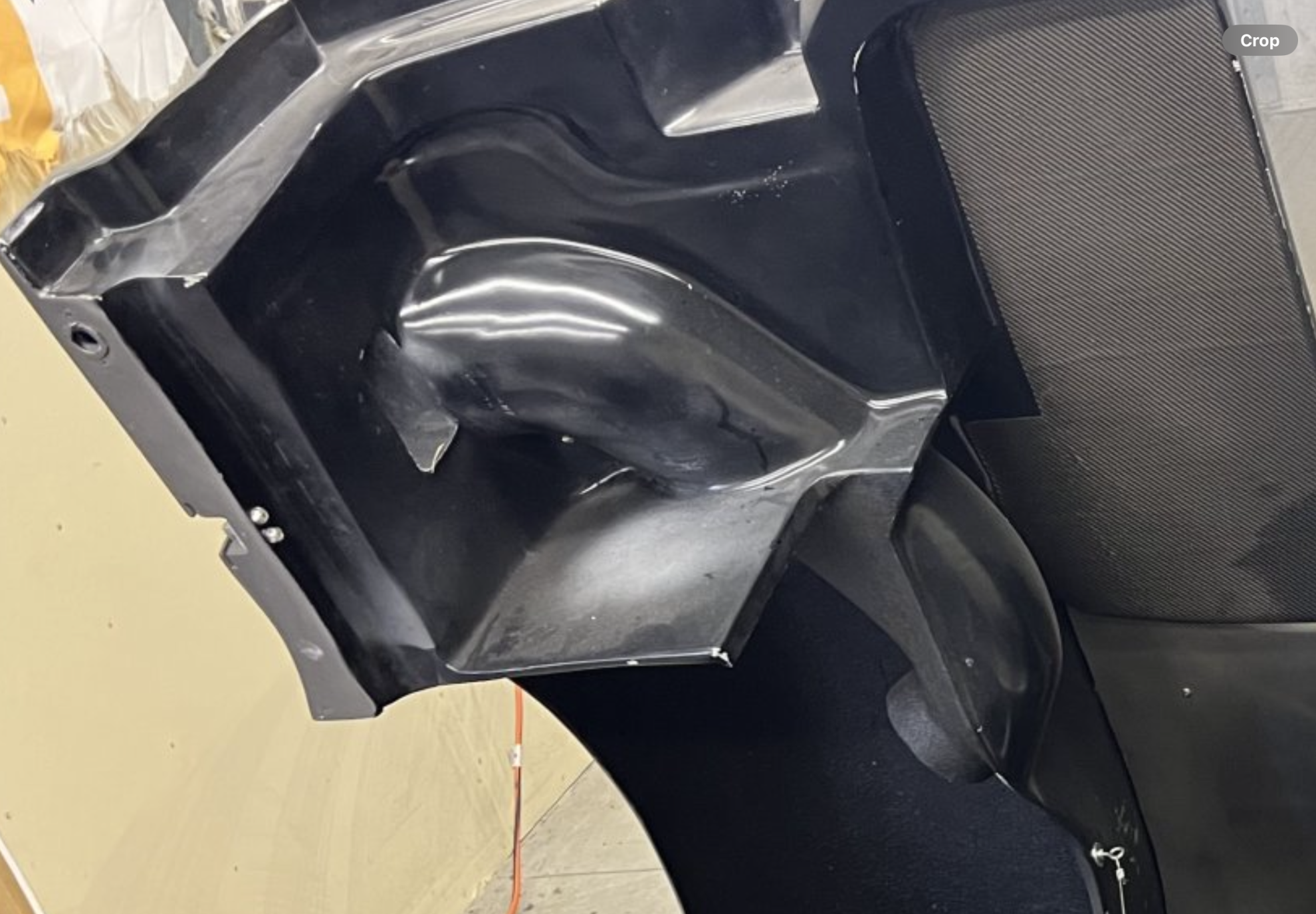

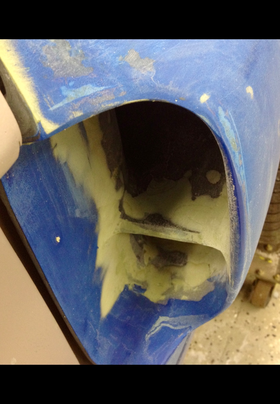

Does anyone have pictures of either the original or the Hough replica rear brake ducts? Trying to determine how the two pieces fit together and how the worked into the inner body molding.

Here’s a little bit of information. I didn’t have time to dig deeper.
Regards Brian
Heres what I have once the ducts were installed
