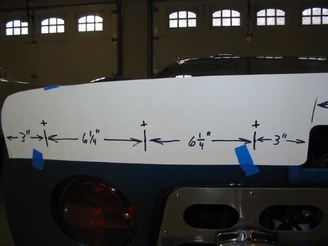

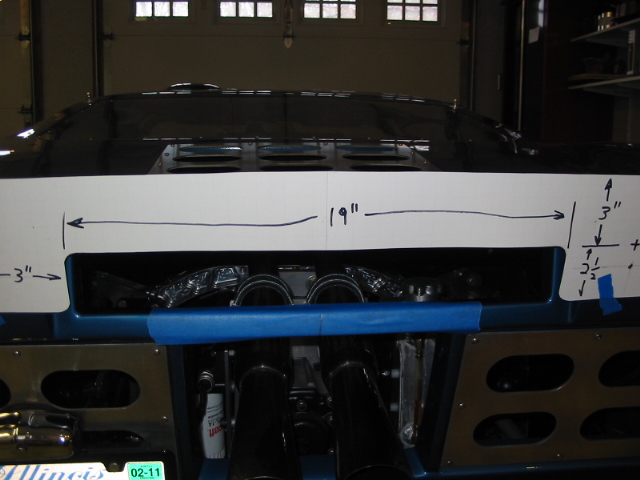

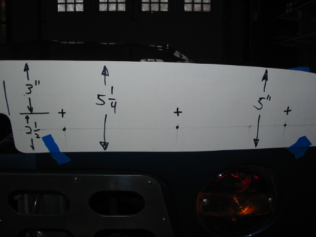

It looks like you could easily make the spoiler from a flat piece of aluminum.
found this on the web a few years ago, not mine ,
hope this helps?
Paul
