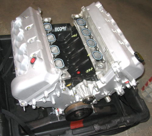

I have been looking at Ebay and found a few listings like this
2003-2004 4.6 Mustang MACH 1 DOHC 4 valve engine
One possibility was a rebuilt long block and then put a IR (8 Stack) intake on it
Other possibility is to look for a good pair of 4 valve heads (Cobra 2003 or similar) and buying new Ford Racing iron 5.0 litre modular block and filling it with new crank rods & pistons.
All possbilities at this stage
regards KB:idea:
