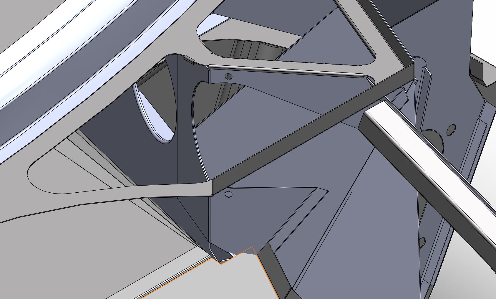

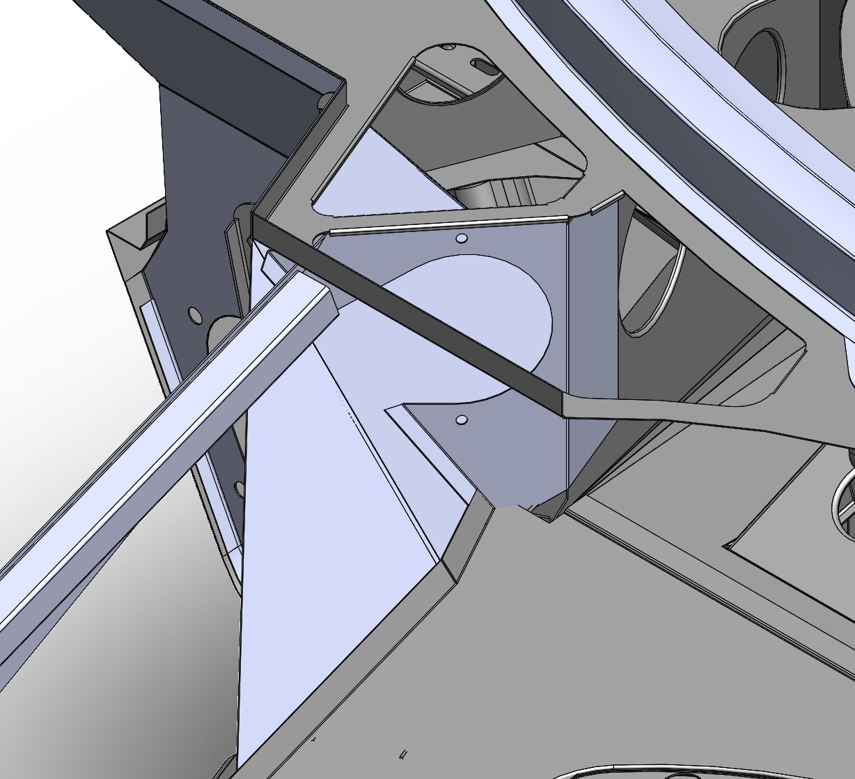

Threadjacking David. Does anyone have any useful information on these plates underneath the dash top?
I guess the hole should be 3,25" or so in dia.
On the first picture it is alligned so the flange is approx paralell to the suspension bracket outside.
On the last it is made as simple as possible.
Or are none of these even close to correct?

Does a 3.25" hole allow the duct on to the back of they eyeball dash vent. I cant remember the size of duct work needed. Have you drawn the extension tube off the back of the forward triangle? I think I made my hole slightly larger in that area, and may have even had it turn the corner of the flange slightly so that I was not trying to bend ductwork at an angle coming of the back of the stub tube on the back of the triangle piece?
It was so long ago that I looked at that part I can't even remember what photo I copied.
I can't even remember of the top of my head what size I made that hole.
I think I would have made it match the holes on the spare tire well cut out, just for consistency. My assumption at the time is that they would have used a punch tool that they had on hand, so just used a size that I knew they had.

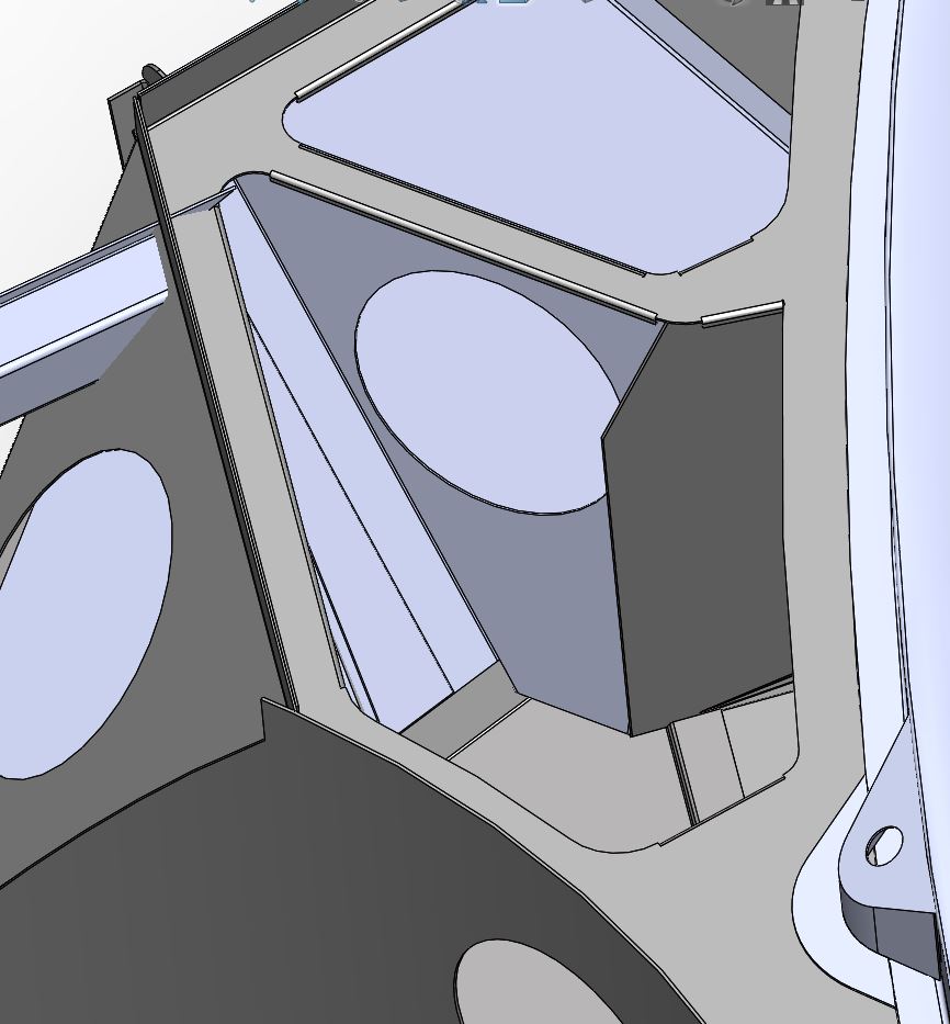

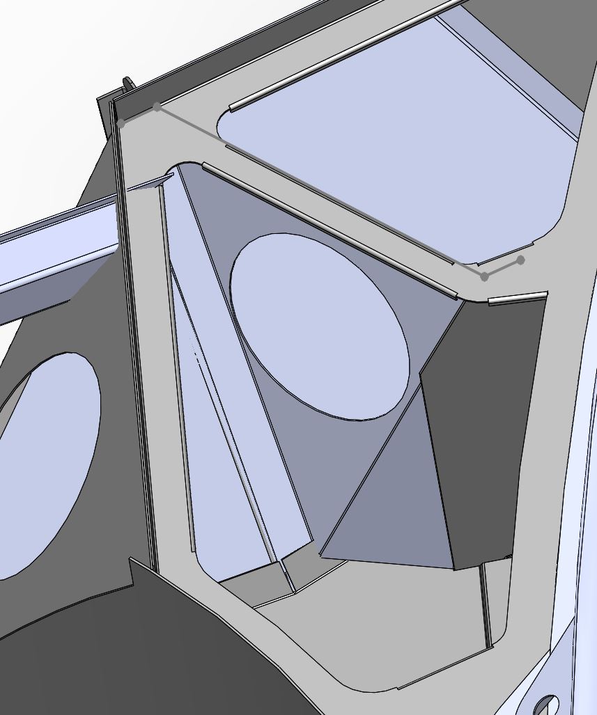

Got some reliable picture info last night, will update when i have completed it. Hopefully this evening.
Here they are. Some plates removed to show them more clearly.
Some minor adjustments still needs to be made to other panels here after they where drawn.

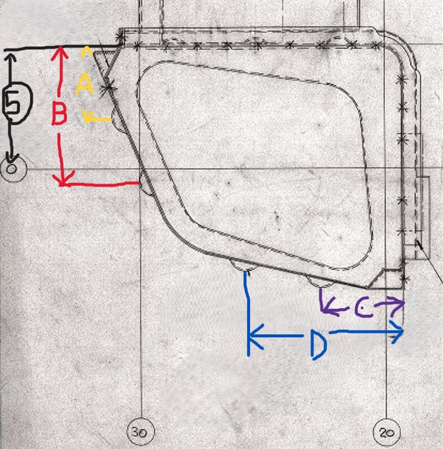

Veamos si se carga esta imagen. La vista es normal hacia el costado de la caja de pie donde se encuentran los orificios de 3,5".
Foot Box es como he estado llamando a esta parte del automóvil, no estoy seguro de cómo se supone que debe llamarse ya que no tengo el dibujo original para hacer referencia al título del dibujo.
<a data-flickr-embed="true" href=" " title="Cuadro de pie_230125"><img src=" https://live.staticflickr.com/65535/52645730472_9fac962bd9_h.jpg " width="1600" height="1252" alt="Cuadro de pie_230125"></a><script async src="//embedr.flickr.com/assets/client-code.js" charset="utf-8"></script>I'm looking for this drawing but I can't find it and I'm sure I have it?
I would like to get the dimensions and angles of this drawing?
