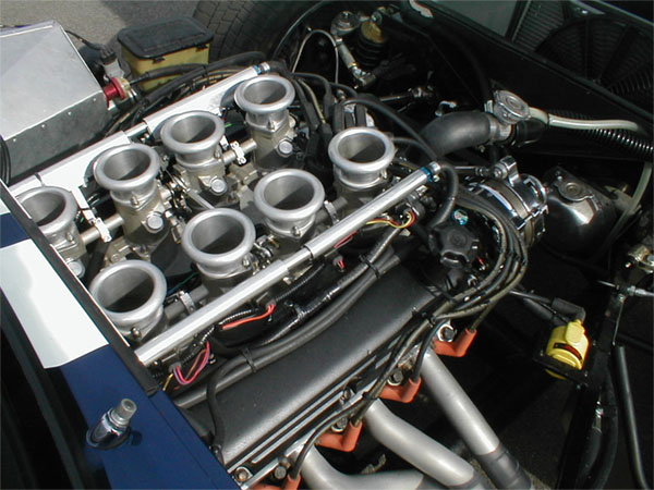

5150 said:
EFI ? Are there no MEN left anymore ? Here it is... 4 Webers , long connecting rods , high compression and lots of lift and duration...works every time.
Well, some of them do manage with EFI, but the Daytona was something of a girlie-man's car.......
Photo from Factory Five
I like to get my hands dirty and mechanical systems are the bomb. The 26 million dollar jet I work on all week just dosen't do it for me anymore. To much electronics keyboard fondling. As I get older I find I need to constantly smell 100LL or race gas burning, mixed with a little engine oil and sweat. Thats why I need Webers.
