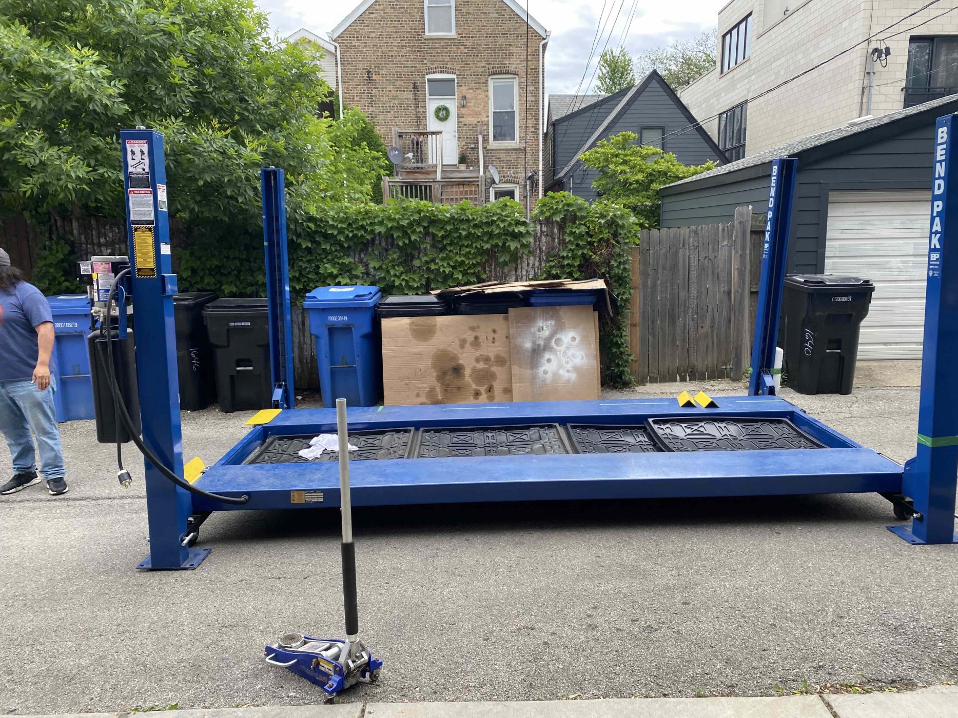

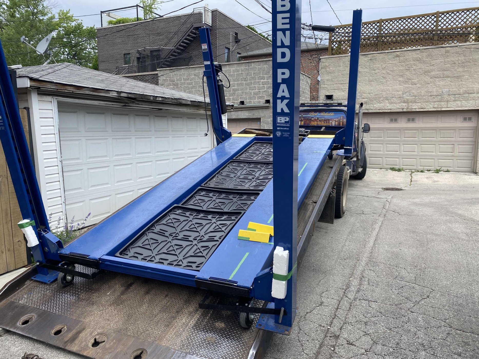

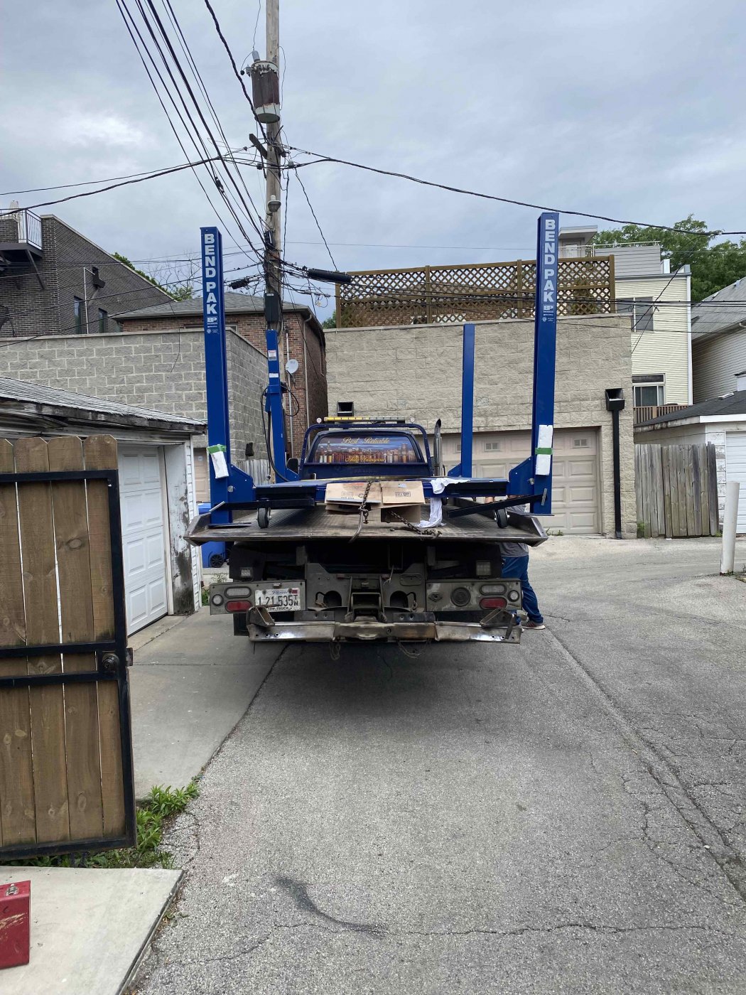

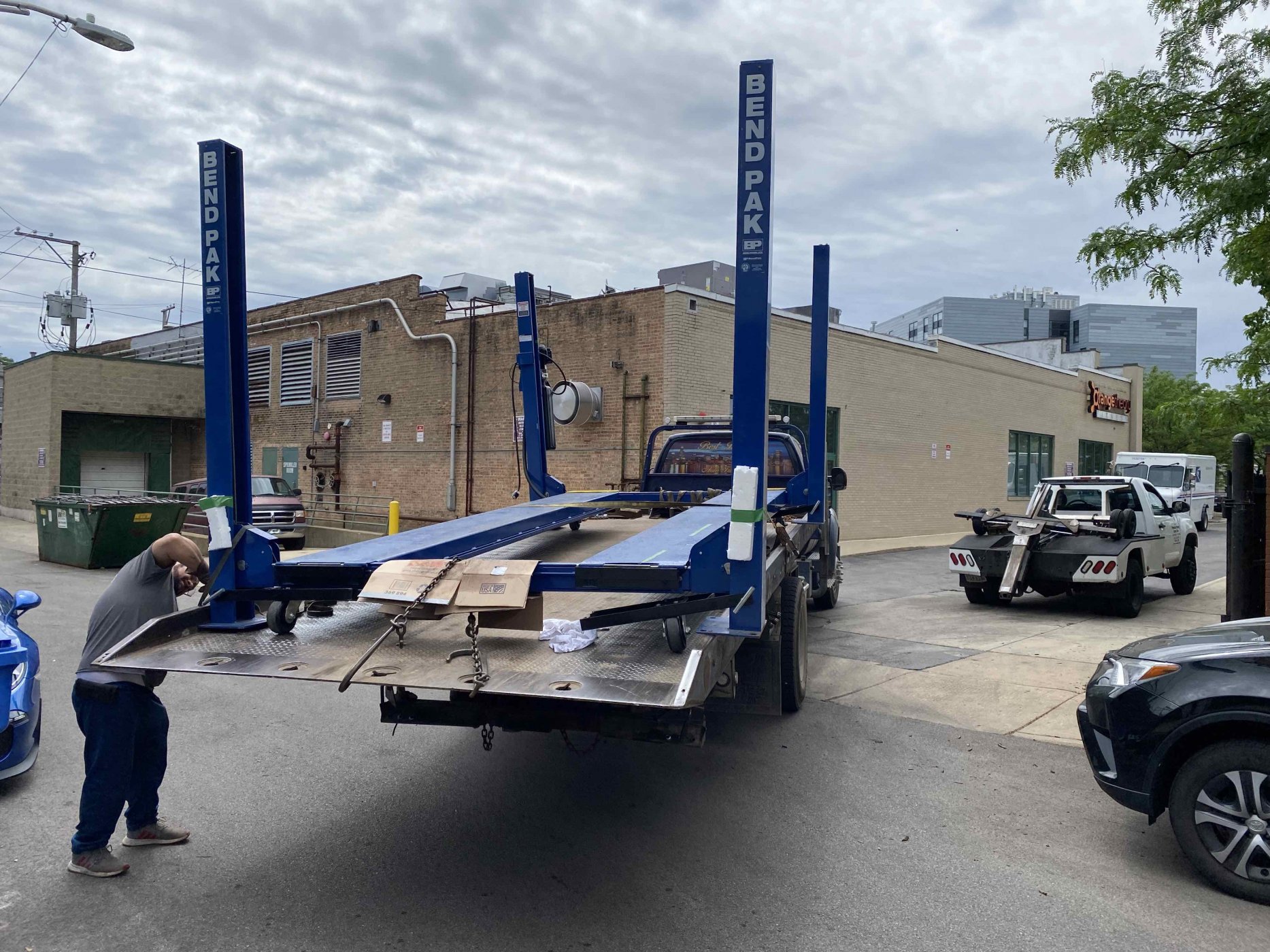

^ you are spot on. Because I'm hard up against a deadline, and the local company that services lifts is booked until August, I had to do it myself. I must have total amnesia from 11 years ago, because this time around it was a brute. Loading was done by me and the flatbed driver. Unload had one more guy. Then setting up the columns, cross bars and runners was just two of us. Thankfully I had a dolly and a rolling jack, but still, never again...

I elected to leave the pump and reservoir attached to the runner so as not to break the connection. I pulled the cross bars out of the towers, and pulled the tower caps off so i could leave the cables attached to the piston rod. That strategy required that I move the runners in tandem, which was probably a mistake - removing the cables is easier. Upside is that I figured out the cables had jumped their pulley tracks, and at least one cable needs to be replaced. Better now than when raising a big load.
