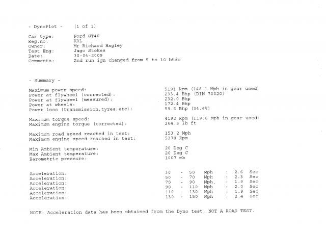

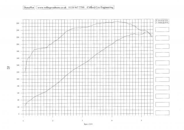

Re-timed it today and it runs. Woohoo!!! Even did a couple of runs on the Dyno. Have to fine tune it tomorrow. Initial dyno run data below, albeit I was expecting a bit more than 230BHP (265 lb ft).

The car is now back home. It seems to run fine, but still has a niggling problem in that the secondaries on the Holley carb seem to be opening too high up the rev band and that is killing the high end power output. Best run on the dyno was just under 300BHP and the torque and power band was peaking at 3000RPM. Unfortunately I have vacuum secondaries and I am not sure how these can be adjusted to open earlier.
