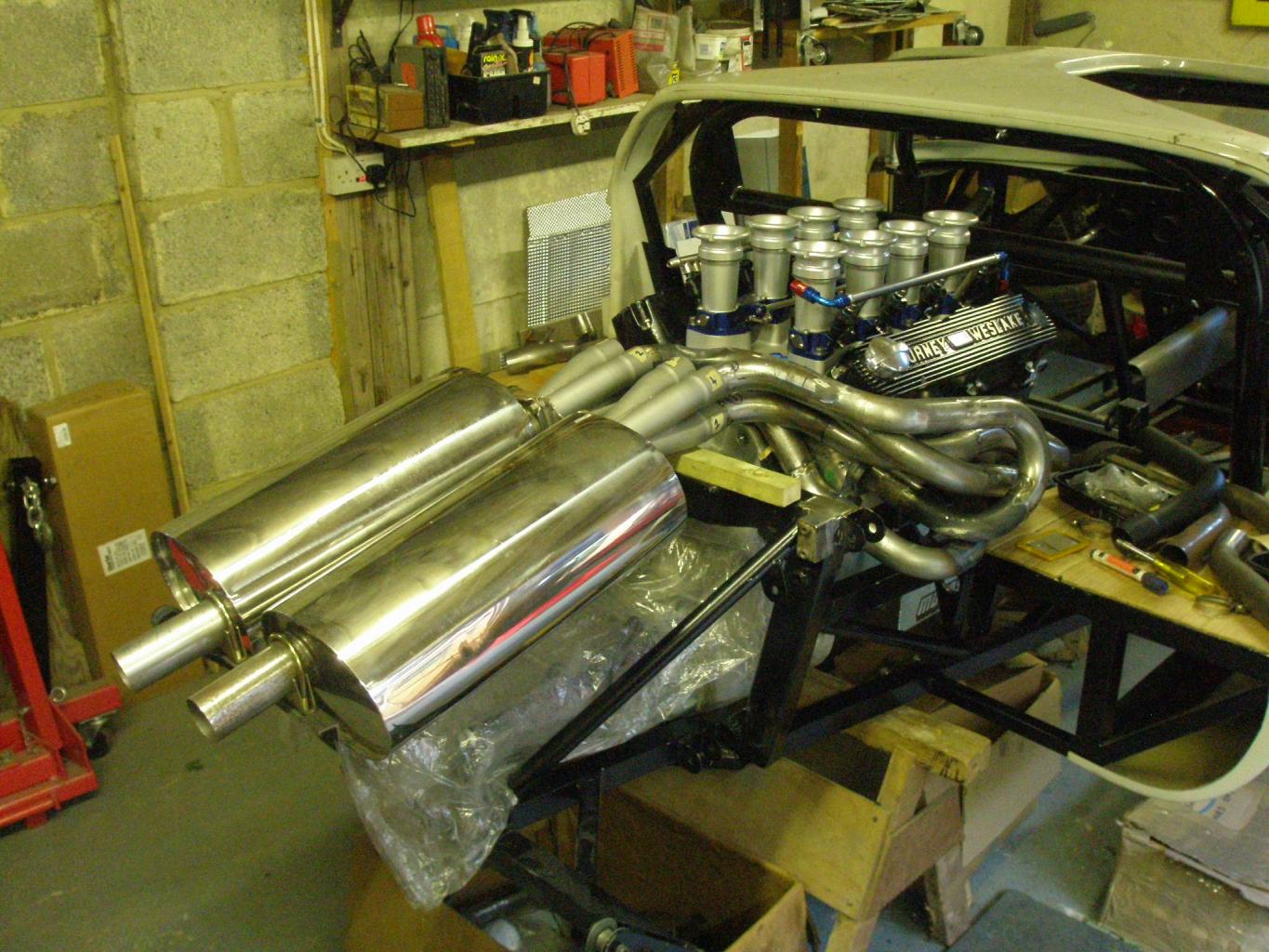

FWIW here's a picture. The stainless billet tips are wraped in protective tape.
Hi Jim,
as Frank stated, it's all about volume. I had my silencers custom built (stainless steel with a three chamber internal design). The overall length is 18”, and a 6.5 x 8.5” race-track cross-section. The overall length is dictated by the position of the collectors. I’d used commercially available 4-1 collectors, which were not that compact in overall length and consequently limited the maximum silencer I could achieve.<?xml:namespace prefix = o ns = "urn:schemas-microsoft-com<img src=" /><o:p></o:p>
Hope this helps,<o:p></o:p>
Regards<o:p></o:p>
Andy<o:p></o:p>
