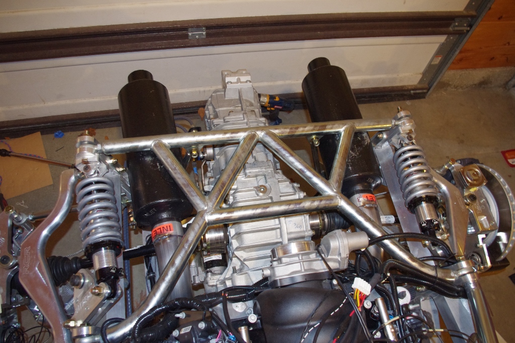

If you're running them out the back -- here's the larger HP Pro and they are quieter than others.
And this is what they will sound like out the back with a LS376

Yes, street tail. The mufflers likely could have been installed backward a little further, but... the main muffler body may have fouled on the deck lid if any closer - I'd have to re-check. I have very simple 3-4" length pipe extended off the muffler ends, The muffler tips sit approx. 2" past the grille area. I plan on eventually getting the exhaust hot ceramic coated.
Yes on the 480hp crate engine -- LS376
The HP's are a tight fit thru the back framework. I'd recommend you get the mufflers first before bending and/or configuring the exhaust pipe forward of the muffler. Dangle/angle will come into play.
