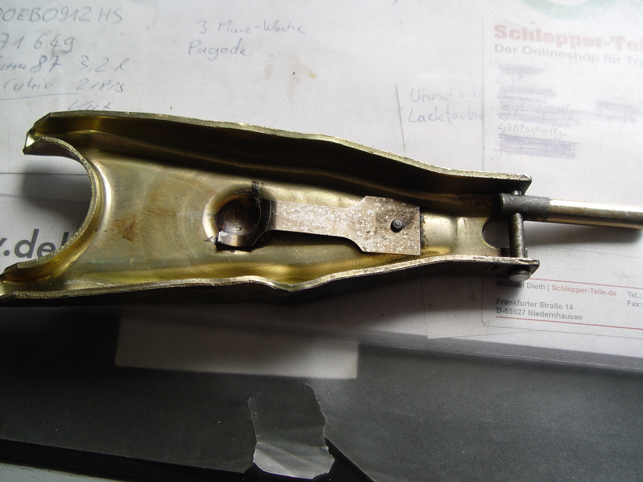

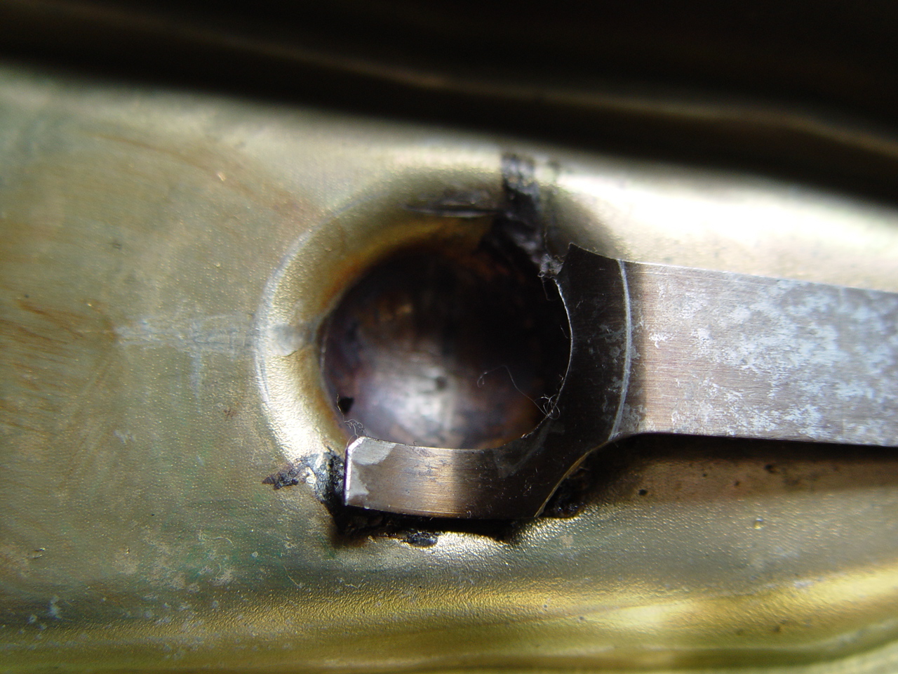

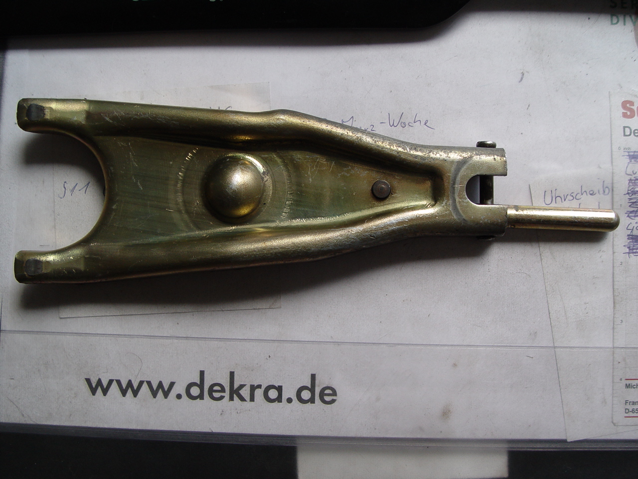

Hello Guys,
my name is Markus from Germany and i hope someone can help me with my GTD40 clutch.
The release lever is broken, but there is no part number on it :(
Does anybody have a idea where I can get it?
Thank you very much!

Hi Markus,
I got piece a while ago at Beny Verhulst in Belgium 32 3 774 13 85. but not sure if he is still active
otherwise try Alpine forum.com in France
Grtz
Fred
Benny Verhulst is still active.
WIJ ZIJN ALTIJD BEREIKBAAR VOOR AL UW VRAGEN ***
Gezien het overheidsadvies, en onze bezorgdheid om uw en onze gezondheid, zijn we vanaf heden altijd bereikbaar voor al uw vragen en dringende interventies.
Dit kan op 03 774 13 85 of [email protected]
Mike Pass
Ring Chris Cole on 01952416051. He rebuilds lots of Renault boxes and will very likely have the part you want. He does not do internet stuff so you have to phone him. He also does an uprated release bearing carrier and bearing and sleeved down slave cylinders on an exchange basis,
I had this part btreak several years back. My research found that it is a Lotus part. It was available thru SJ Sports cars in the UK. I bought mine from Bean Engineering here in California. The part number I have is A082F6231F - Good Luck in your search.

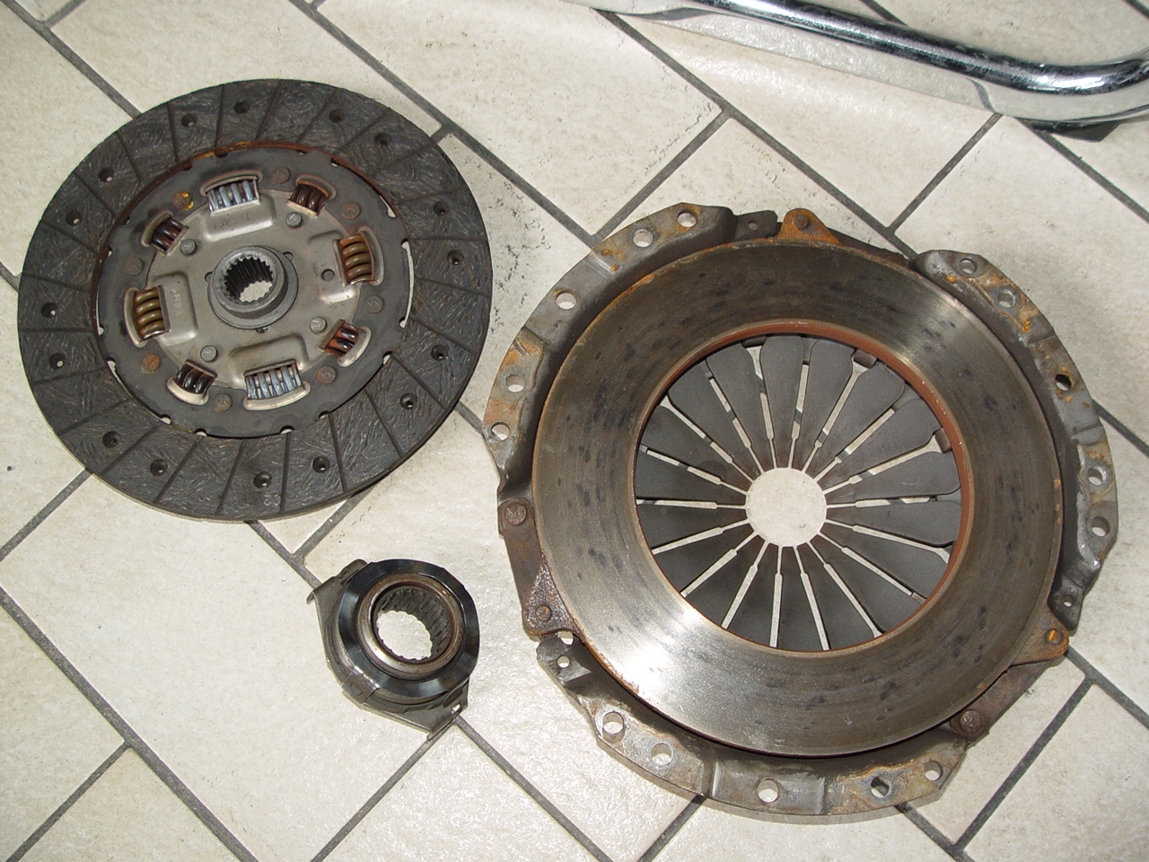

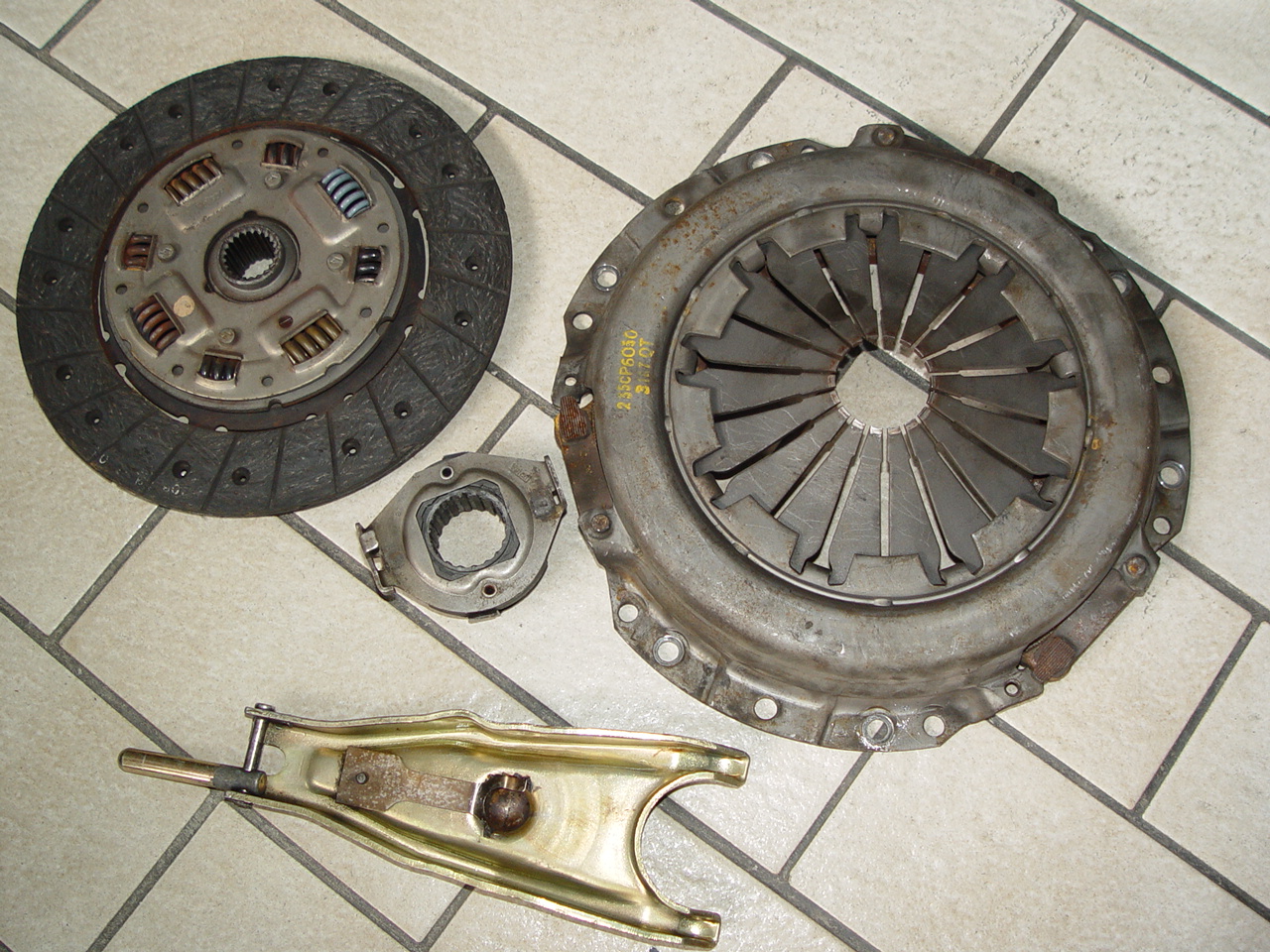

Markus, looking at your pictures, you also need to change the clutch thrust bearing , the one you have is not correct for the pressure plate you are using, witness the wear on the fingers on the plate , Frank
