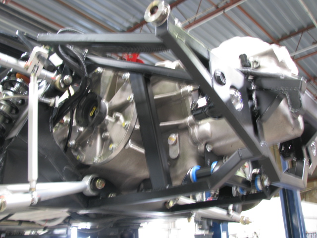

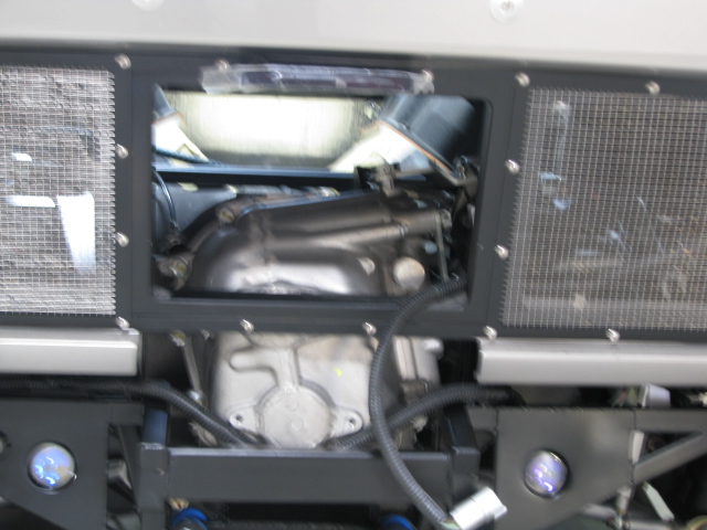

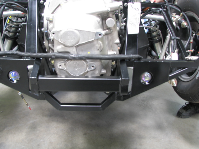

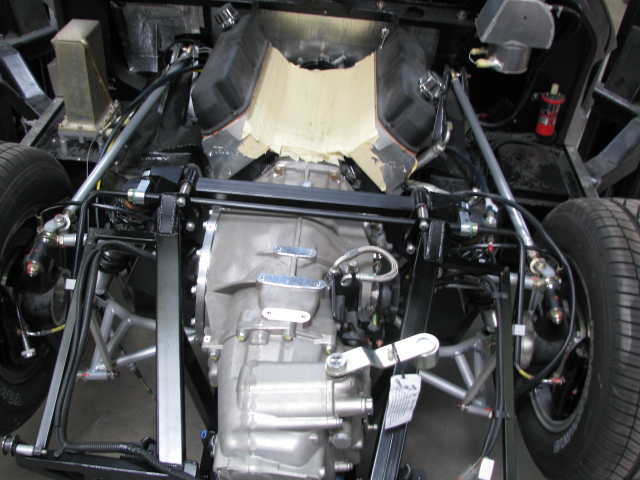

Brian,
Here are some pictures of the Ricardo installed in my friend's SPF MkII. The quality is kinda' poor... sorry. But you can clearly see how they had to raise the power train up and the modifications they did to the rear chassis section where the transaxle sticks out further. I used to have pictures of the actual motor mounts, but can't find them. They were simply modified with a spacer between the motor and the mount.
I hope these help a little. Let me know and I will have him send more pics if necessary. He is not on the forum.
Kirby
