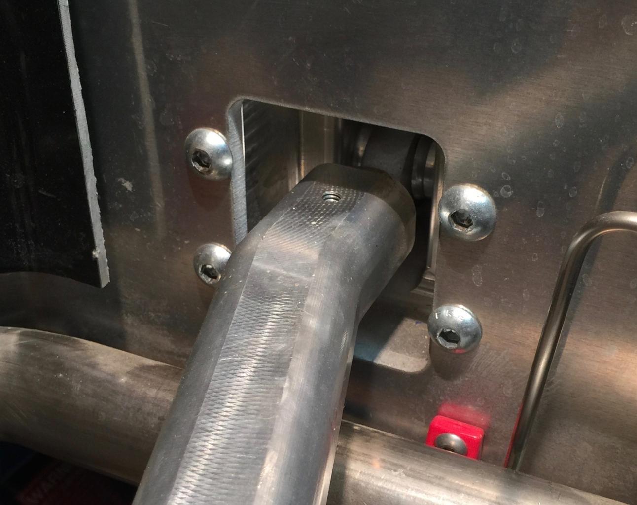

Ken thanks for the reply. This is actually the lower control arm with the billet aluminum cup inside the tub for the lower rear control arm heim. i'm thinking to leave it alone as opposed to destroying something. In the manual it does say the washers are suggested which leads me to believe I should be ok. This is a street car that will see occasional track day time. I was wondering if anyone had a bad experience with not using washers.
These are the buttonhead bolts.
Under the circumstances, I'd mark the bolts to make it easy to check if they were backing out, and make it a part of a pre-drive check to give them a glance.

I was unable to get any of the bolts loose at all (applied some heat and used a restrained percussion instrument- a hammer).I have ALOT of experience in this area being a tech and service manager for many years.
Those are the only bolts into aluminum that I've taken apart in which the factory didn't use anti-seize. My plan is to use anti-seize when I put them back in.
