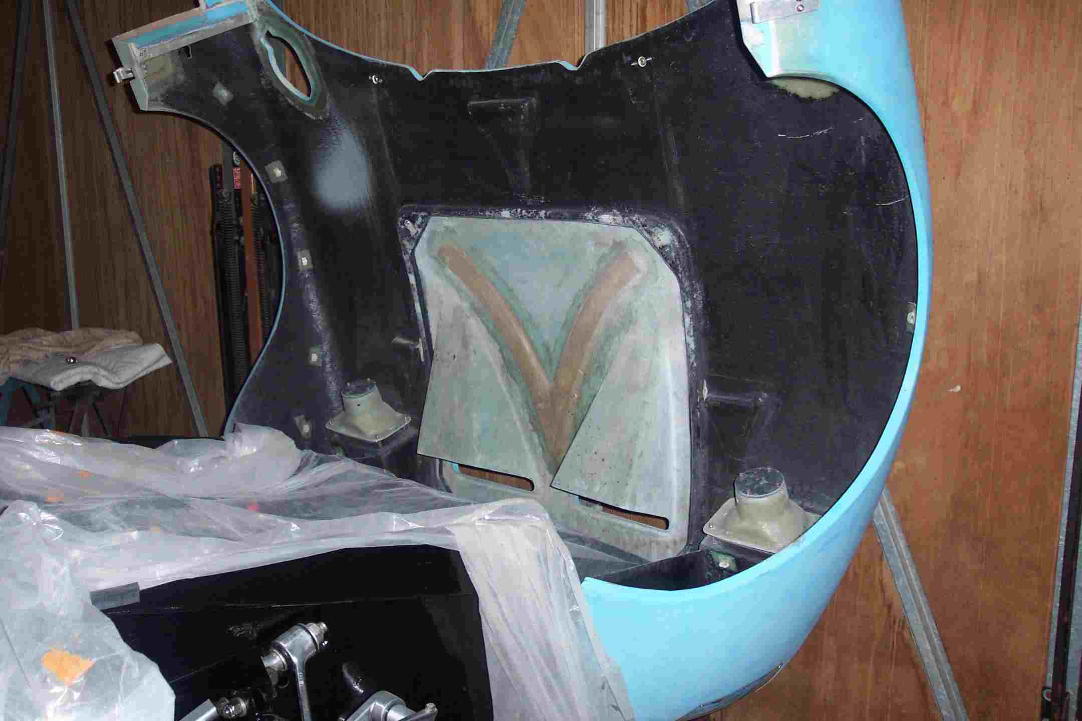

Peter Delaney

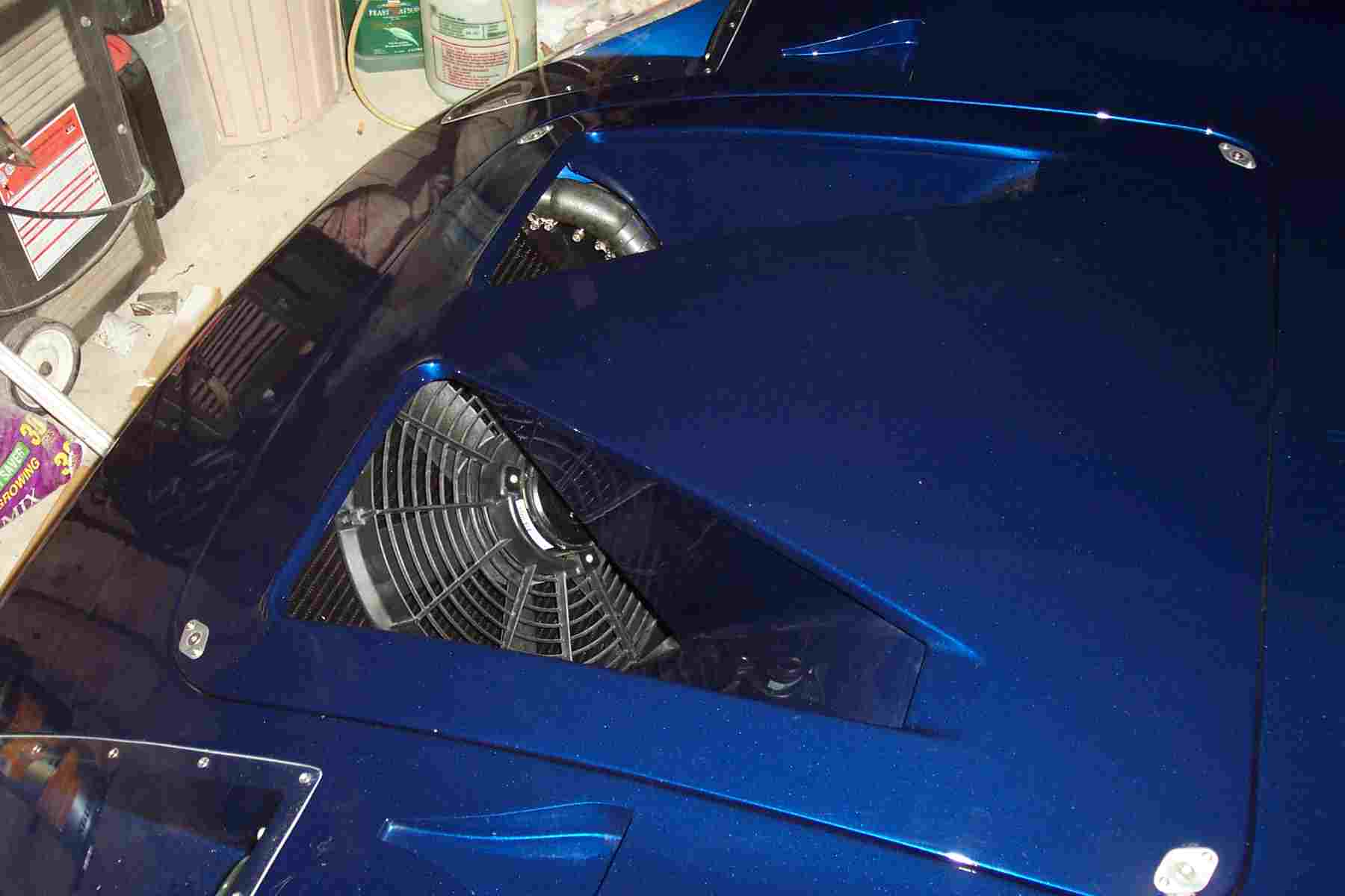

The above pic shows the original shallow nostrils, the next pic shows the final deep ones.
